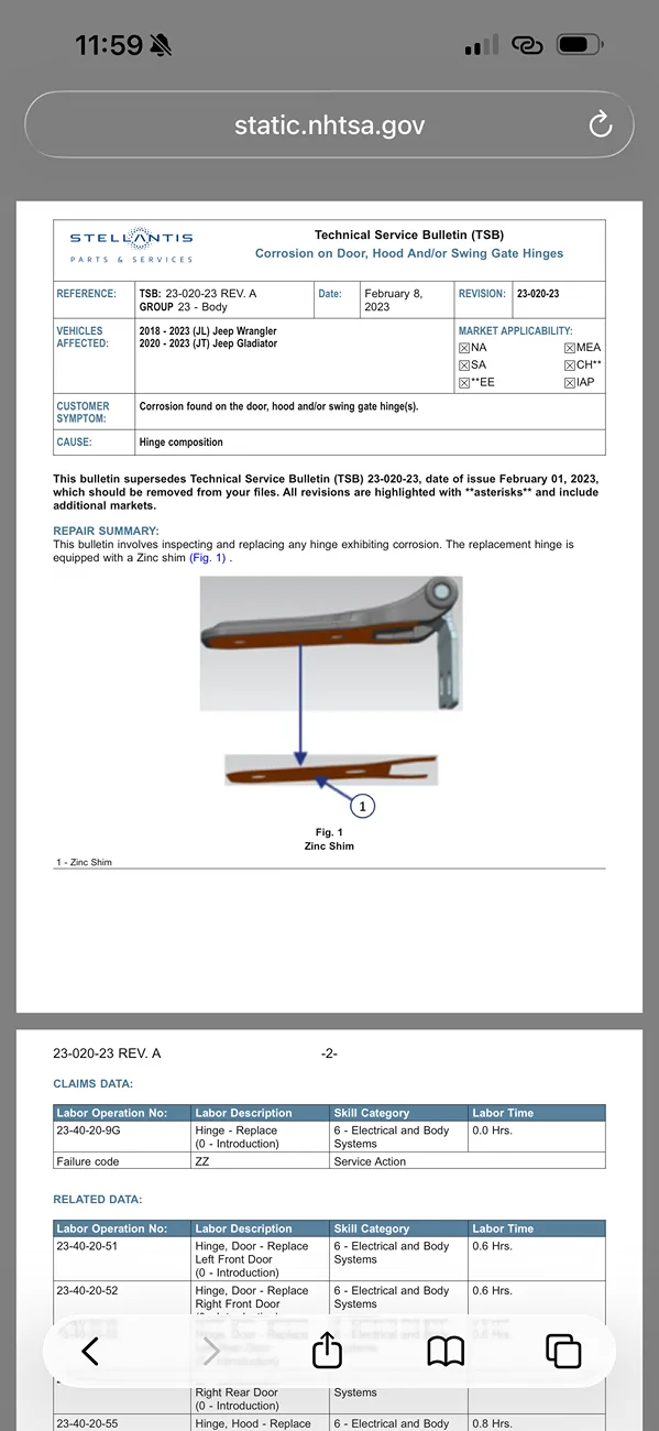

It’s due to dissimilar metals, aluminum doors and metal hinges and the fact that jeep, in their infinite wisdom bolted those steel hinges straight to the aluminum door then painted over everything. Go in get it warrantied and fixed. Mine got it, they should now be replacing the whole panel vice fixing. And they update the hinges with the TSB with a zinc shim. Sacrificial Annode. Plus a good paint shop will paint the door and handle, then bolt them together so nothing touches anyways.
