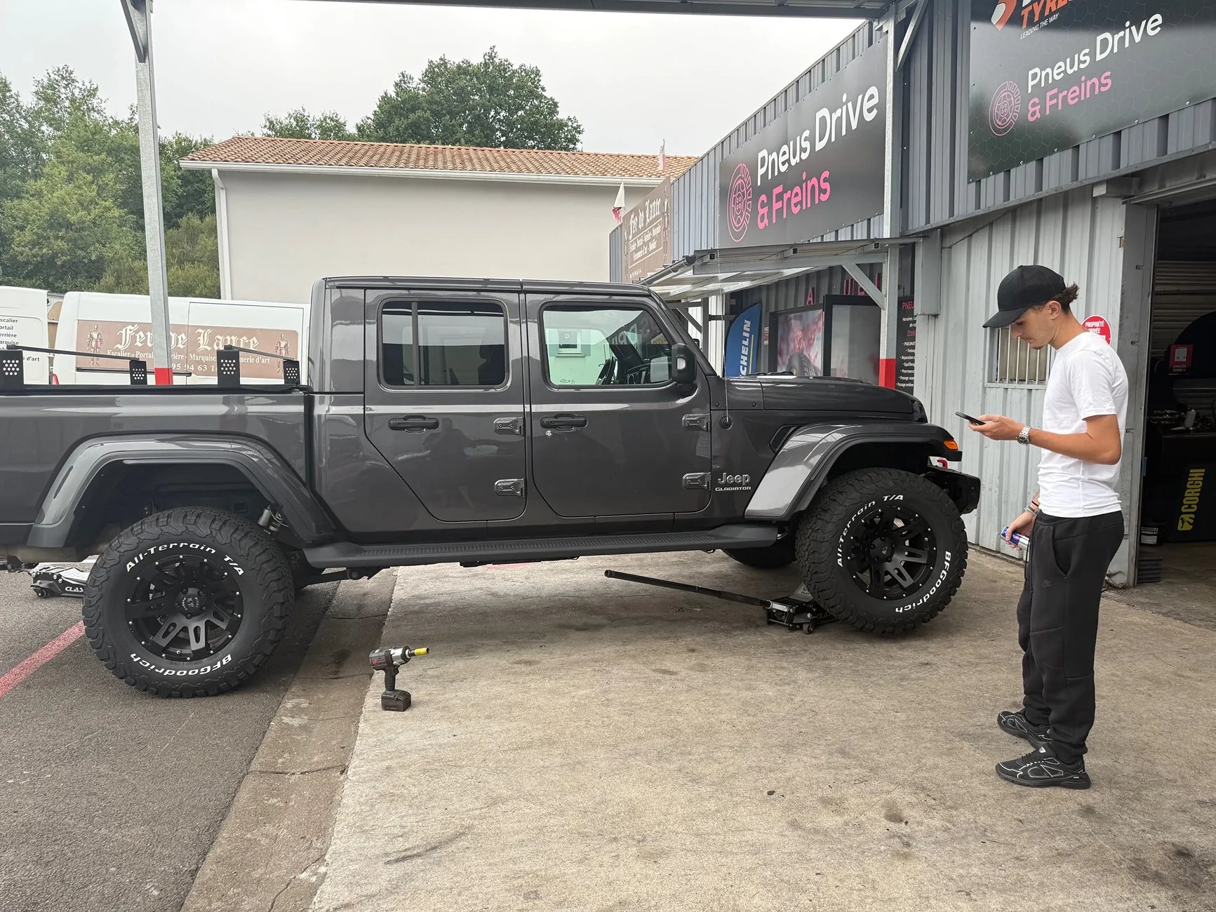

guys ,
first of all a BIG THANK for your recommendation !
I went this morning and they were able to balance 3 of 4 tires as the 4th has a small deformation (look at weight in grammes on the picture)
they put it on the back.
test done up to 120 km/h (about 75 mph) and it is perfect ! No vibration anymore.
thanks to you guys I learned something and found at least the only one on my area able to do it :like:

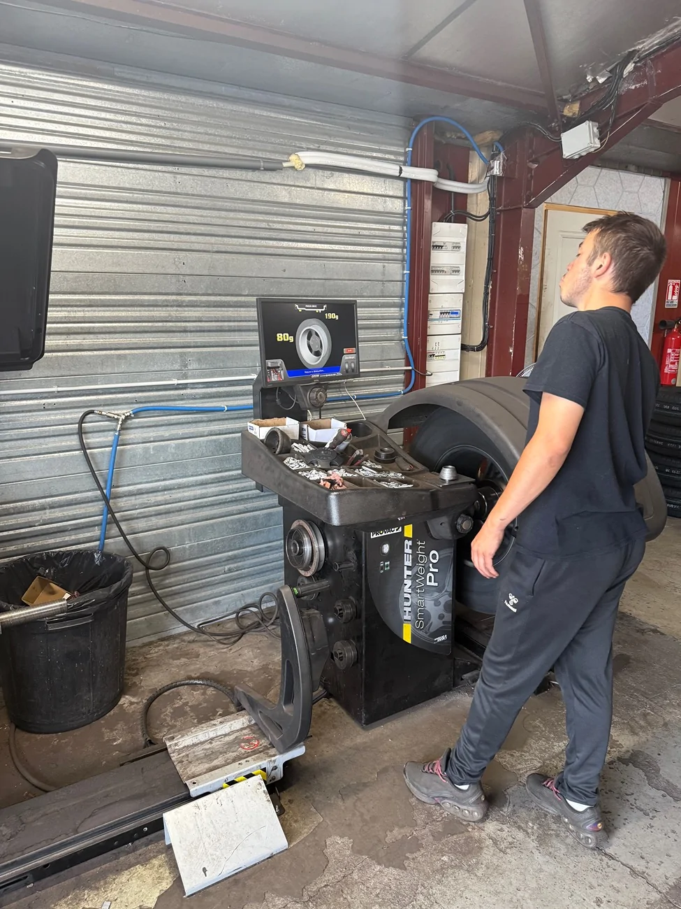

i dont think that machine is capable of road balancing tires, i dont see the big drum that applies the force like our hunter machine.

I was close to the machine and can confirm you it could do both, my son (the young boy on the picture) knew also about road balancing and confirmed it to me. Proud of him …
at least the result is there…
