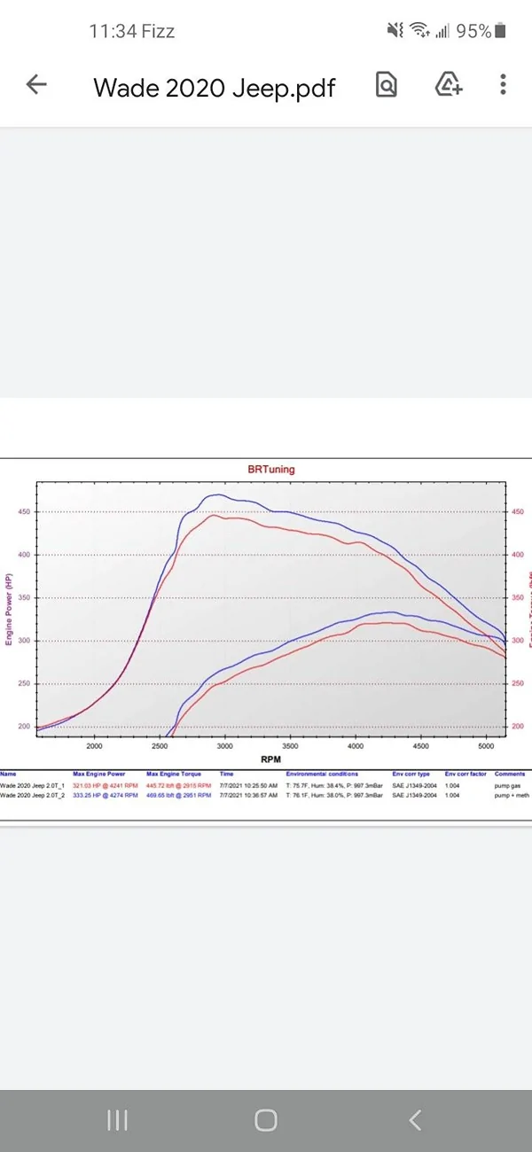

I'd be interested to see dyno charts if you have images or links.

470 ft/lbs at 3k RPM, nice. 😁
A stock 392 looks to be about 315 ft/lbs at 3k RPM.
Even at 2500rpm the 392 is under 300 ftlbs and the 2.0t is about 370ftlbs. Why making more torque at idle is some kind of flex I don't know? Blip the throttle and you're well beyond 2500 rpm in an instant. The tuned 2.0t makes way more useable torque period.
