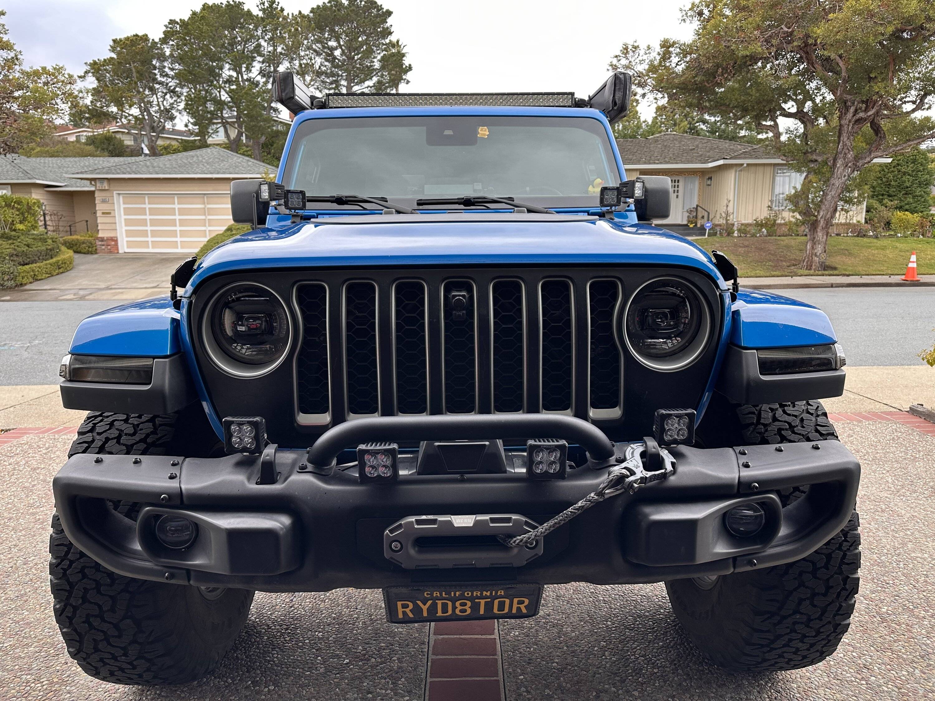

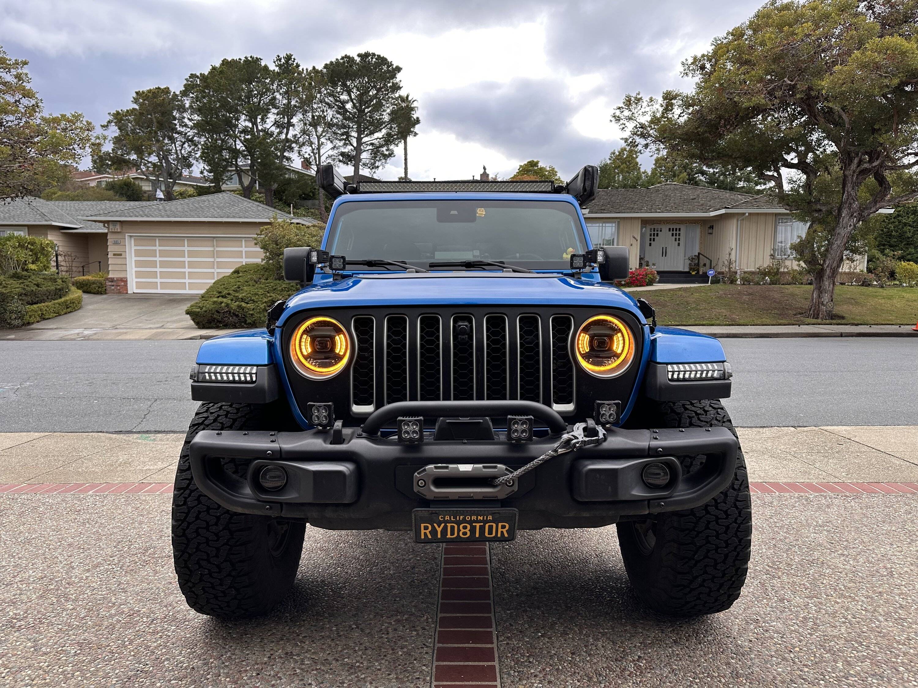

Replacement unit arrived while on vacation, so got to install it today. Simple install, definitely worth removing the fenders for wire management and reaching the connectors. Passenger plug is for sure tight, but I bent it horizontally toward passenger and that seems to create the least amount of pressure.
Lights seem solid, good cutoff that matches the elite fogs. Welcome sequence is nice. Didn’t get to wire up off-road lightning yet, and I don’t know exactly what the fuse tap is for as everything else seems to work fine. Trying out amber drl for now as it complements the blue nicely.
You skipped the fuse tap part and everything works fine?
I had assumed the fuse tap was for the DRL’s.
Yea, I already have two fuses tapped, and I think one of them *may* be the 12v cig lighter that they suggest, so I need to decide which one to use.
So for now I left it out, and I can’t figure out what purpose it serves. I was thinking memory or welcome sequence, but the drl setting is sticking and the sequence works fine. Only weird thing I noticed is it takes a long time to switch to the actual amber drl after starting the engine.

Called DD and the rep said it’s “probably for DRL” functionality, but couldn’t confirm. Was confused because DRL works fine. After wiring it up, I’m pretty sure it’s to trigger DRL on ACC (or whatever you tap to). Also wired up the off-road lights. Here’s a long video of the various modes (off-road comes on around 55 seconds in, but you can’t really see the brights from this angle). FYI the amber fogs are from Z-Roadz, just showing how closely they match:

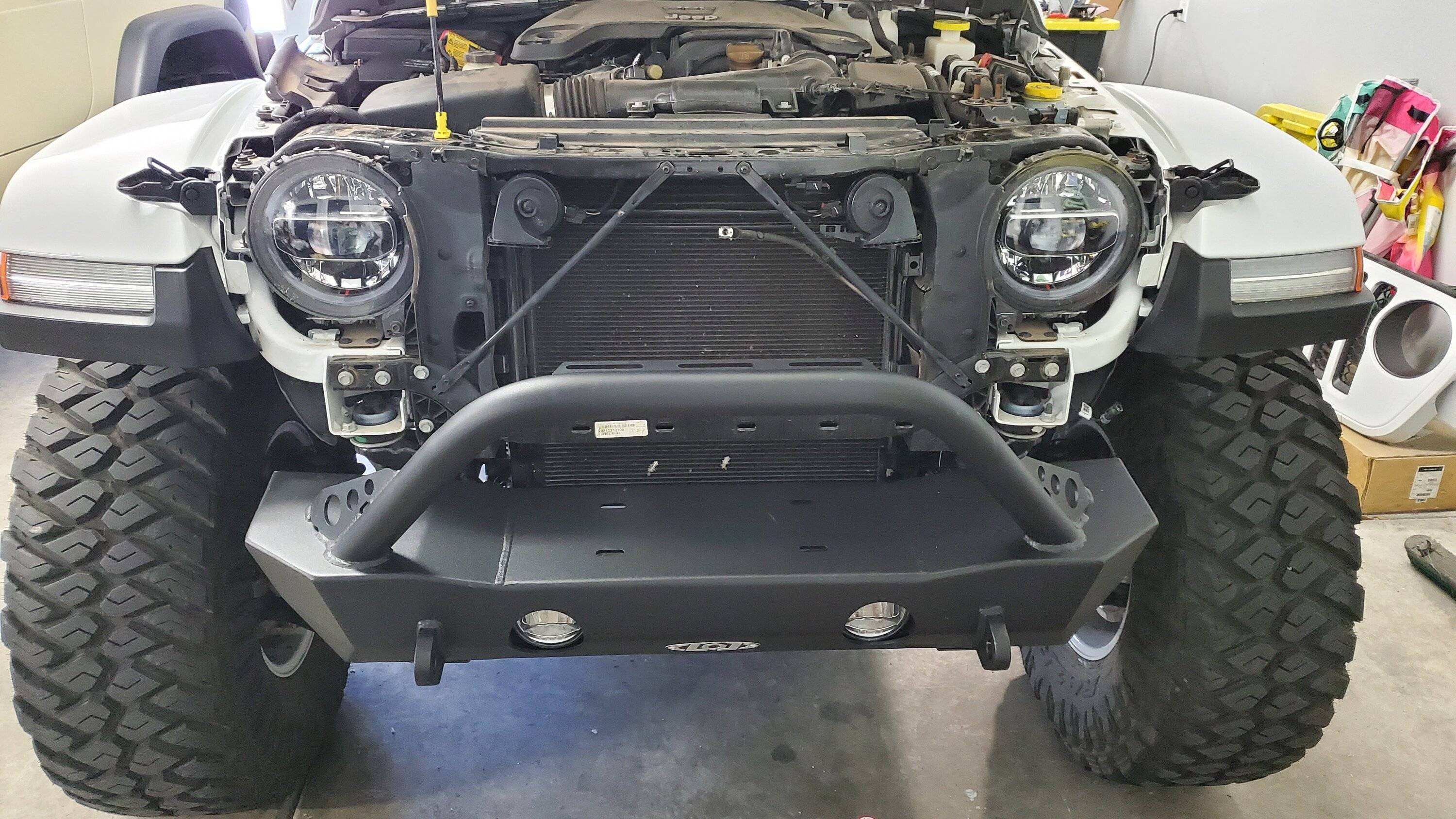

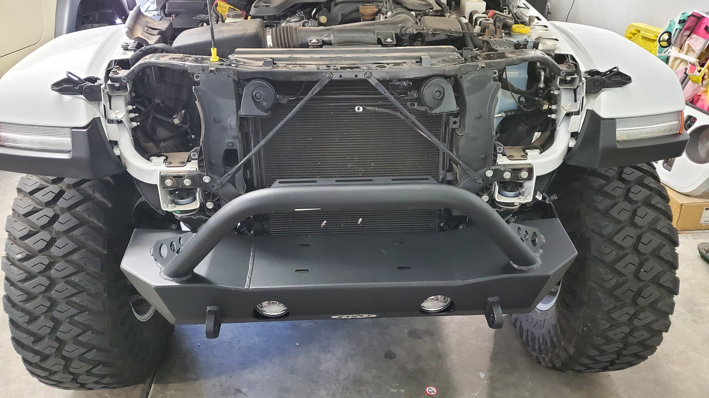

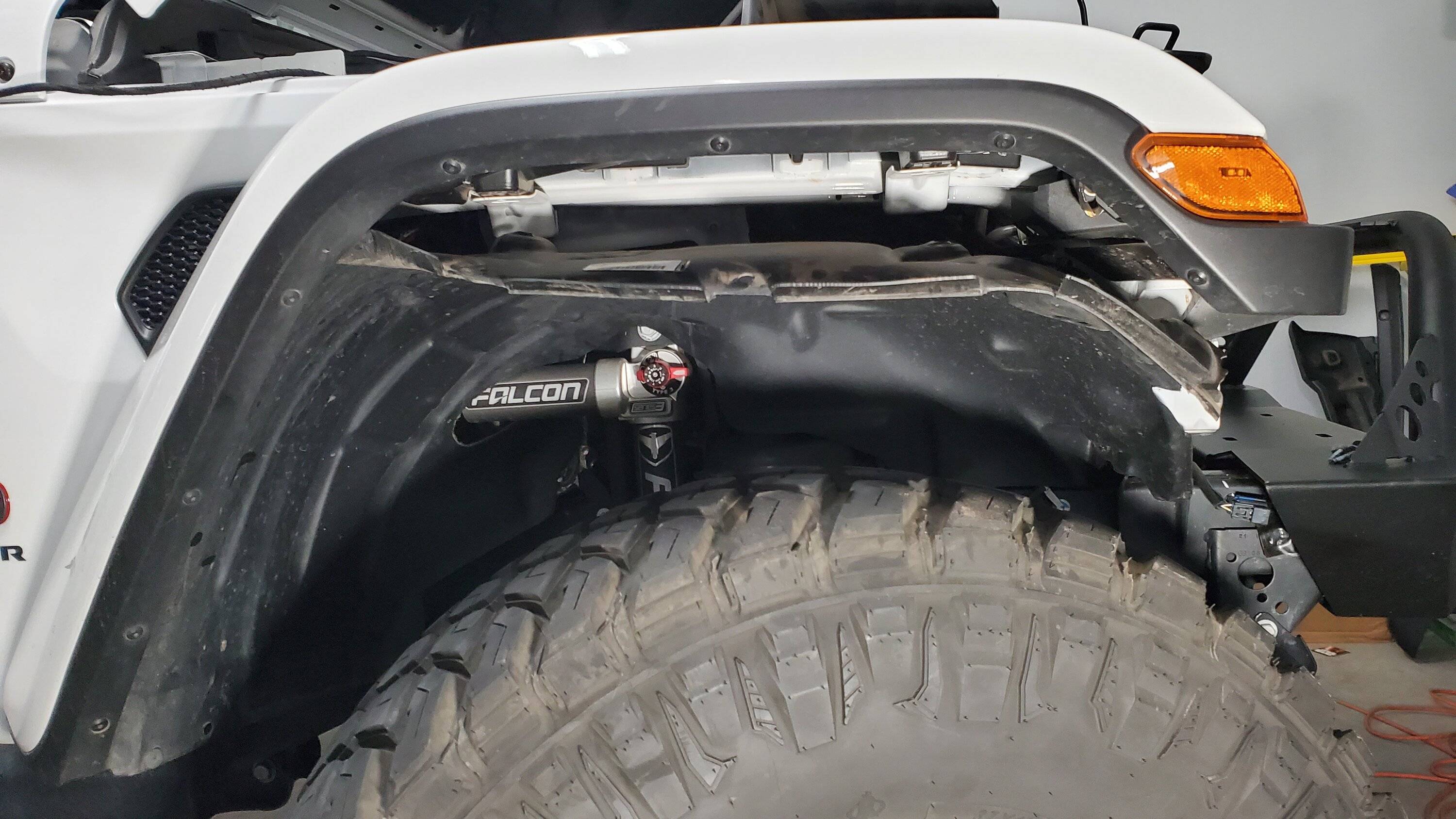

After holding off for a bit in hopes that there'd be an additional fix for the airbox wire positioning, I decided to work through the install. I will say, without tiny kid hands, I don't see how this install would be possible without either removing/completely loosening the inner fenders or removing the fenders. If I was to do this again, I would remove the fenders. The factory connectors for the side markers also felt like they were connected with Gorilla Glue. Even with the retention clips pulled out, they were very hard to remove.
Unfortunately for me, when I got to the headlight alignment step, my passenger light was pointed at the sky. Figured that would be an easy fix with the alignment tool provided. Turned the tool to lower the projector. Nothing. Went as far down as I could, still at the exact same location it was from the beginning. Based on this thread, it appears I'm not the only one who ran into this issue. Hoping the @Diode Dynamics warranty/RMA process goes quickly.
Some pictures that will hopefully assist others:
Grille off, getting ready to remove the factory LEDs.
Jeep Gladiator NEW! Elite Series JL Wrangler & JT Gladiator LED Headlights from Diode Dynamics 20230304_133952
Factory LEDs removed.
Jeep Gladiator NEW! Elite Series JL Wrangler & JT Gladiator LED Headlights from Diode Dynamics 20230304_134839

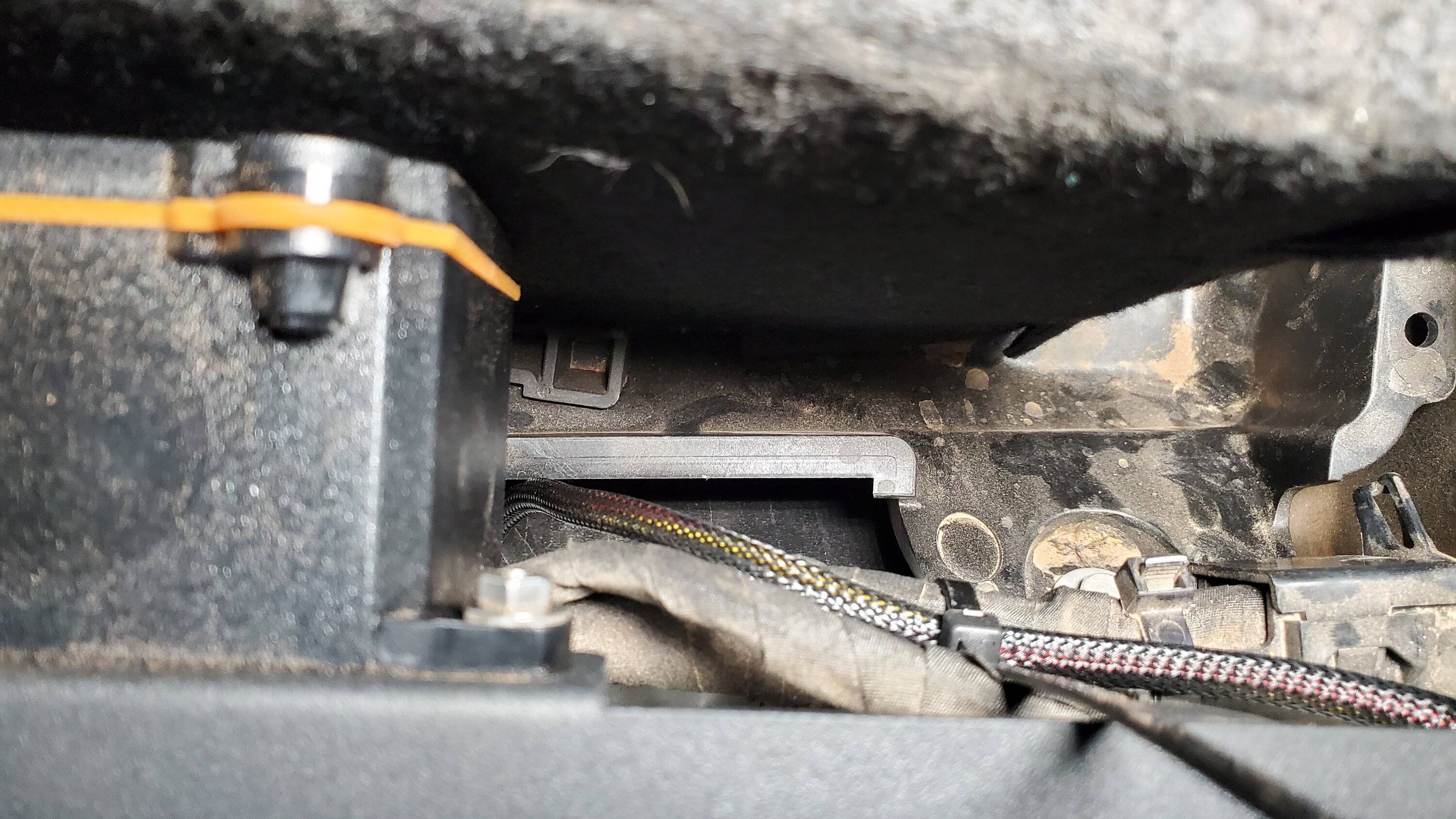

Passenger side marker connector location.
Jeep Gladiator NEW! Elite Series JL Wrangler & JT Gladiator LED Headlights from Diode Dynamics 20230304_181830

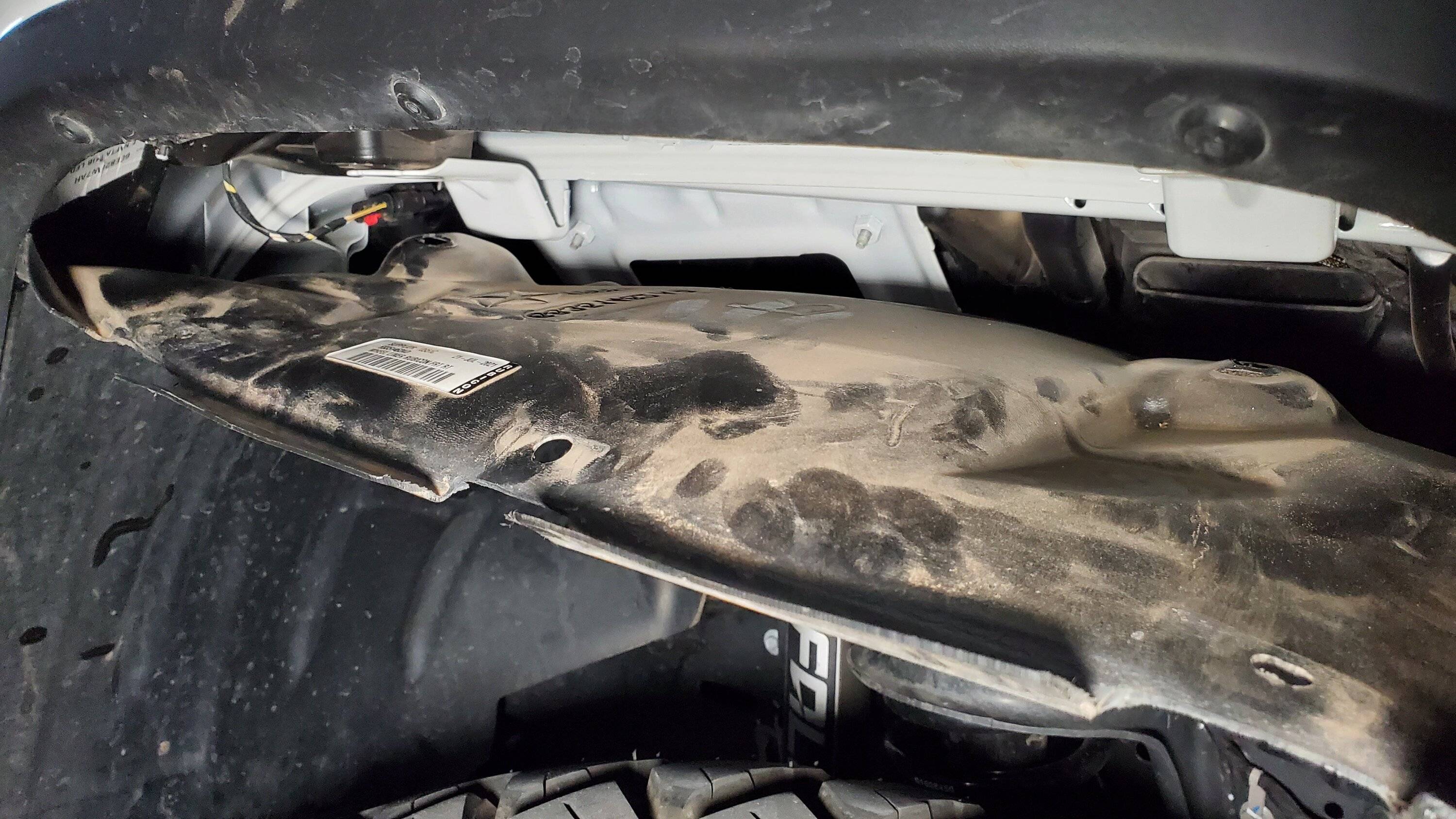

Passenger side access method:
Jeep Gladiator NEW! Elite Series JL Wrangler & JT Gladiator LED Headlights from Diode Dynamics 20230304_181846
Instructions call for the passenger side harness to run down between the battery and the fuse box. There was no opening there to do this. The battery box and the fuse box don't have a gap big enough for the harness to go through, at least on mine. Ended up routing it down a bit closer to the airbox.
Jeep Gladiator NEW! Elite Series JL Wrangler & JT Gladiator LED Headlights from Diode Dynamics 20230304_190926

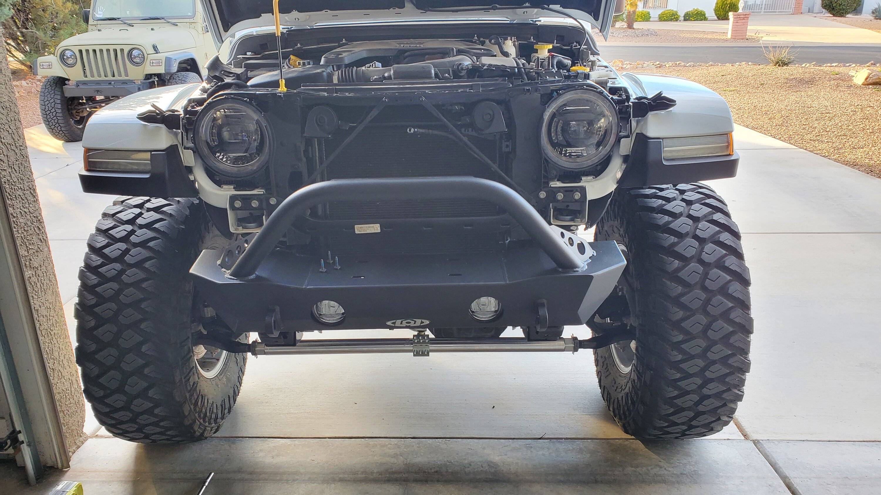

Now looking at the pictures I took during the process, I should have seen that the passenger light was aligned sky high.......
Jeep Gladiator NEW! Elite Series JL Wrangler & JT Gladiator LED Headlights from Diode Dynamics 20230305_173150
So my take so far. The install process is much more in-depth than anticipated from watching the install video. Removing the fenders would have probably been the best bet in my case. Disappointed in the defective alignment portion of the passenger light, but that'll give me a chance to see how the warranty/RMA process is. The lights and the harnesses are of high quality for sure. Just hope that my situation remains a rare occurrence.
It’s unfortunate, but they will do right by you. Just call tomorrow and don’t end the call before confirming a replacement will be shipped. Seems like there’s some QC stuff to be hammered out, but the good units are superb.
