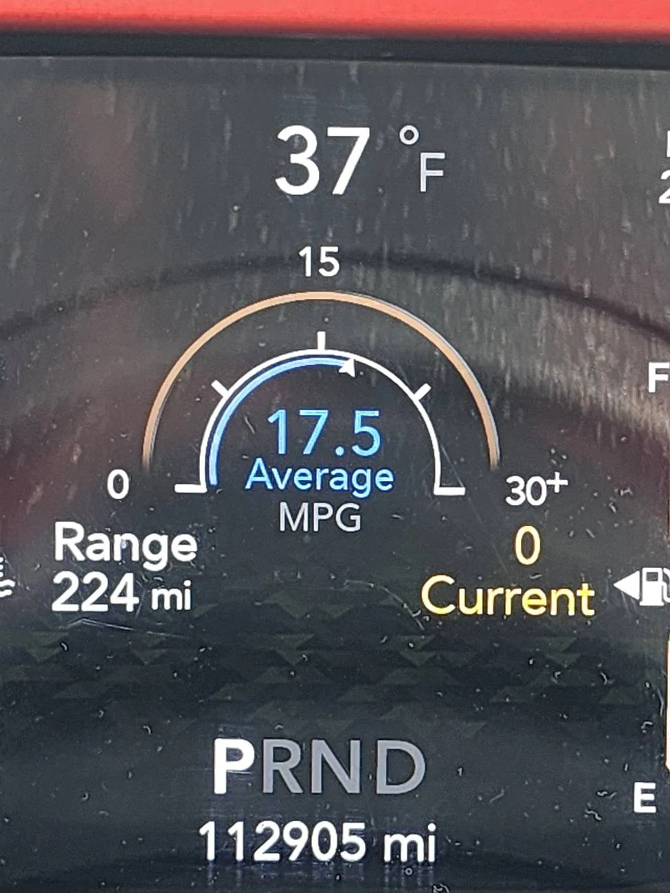

My usual mileage on 4.10's 35x12.50x17 ran 65mph most of the way and about 40 miles of that was nothing but twists and ups and downs .
I suggest raising your right foot of the go pedal a little
That's around what I get on the stock 33's in mine with 4.10's. I only have about 1400 miles on it so far so im hoping is just break in and it will get a little better after a few hundred more miles.
It was an 100 mile trip. I run 89 octane in mine and yes mine is well broken in....lol
