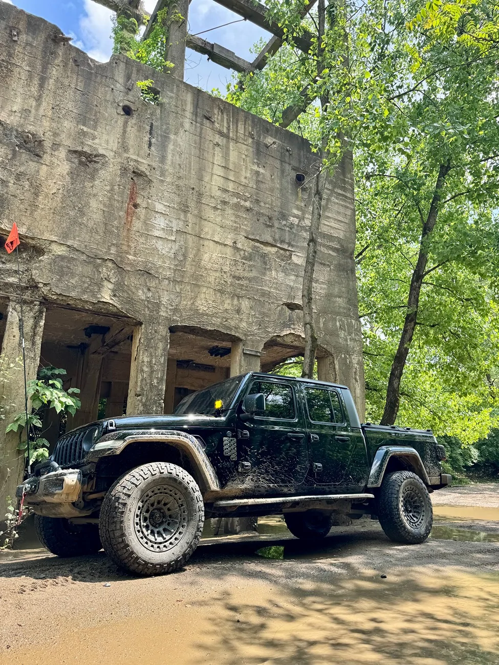

I purchased a 2023 Glaiator overland with 10k by miles, it’s indistinguishable from new. The truck came with a 2.5” lift (I think), jeep/ Fox shocks and Nitto Ridge Grabbers -285/75/18. Theses are E rated tires that are much stiffer than I would like, so I’m shopping for a new set.
I will not be hitting the trails as THE activity, rather in the woods for other activities
I think I’ve decided on the Falken A/T4W, but can’t decide on size.
There is a 285/70/18 that is a C rated tires, but has the stiffer sidewalls and is as heavy as the Nitto’s. I like that they wouldn’t stick out past the fenders, but the weight is not great on mileage and the stiffer sidewalls wouldn’t offer much of an improvement over the Nittos that are on it.
They also make a 35/11.5/18, C rated that is 8lbs lighter.
I'm wanting a more compliant ride on the pavement, but wonder if the extra width of the 35/11.5/18 would have a negative effect on tracking.
Any help and experience would be greatly appreciated.

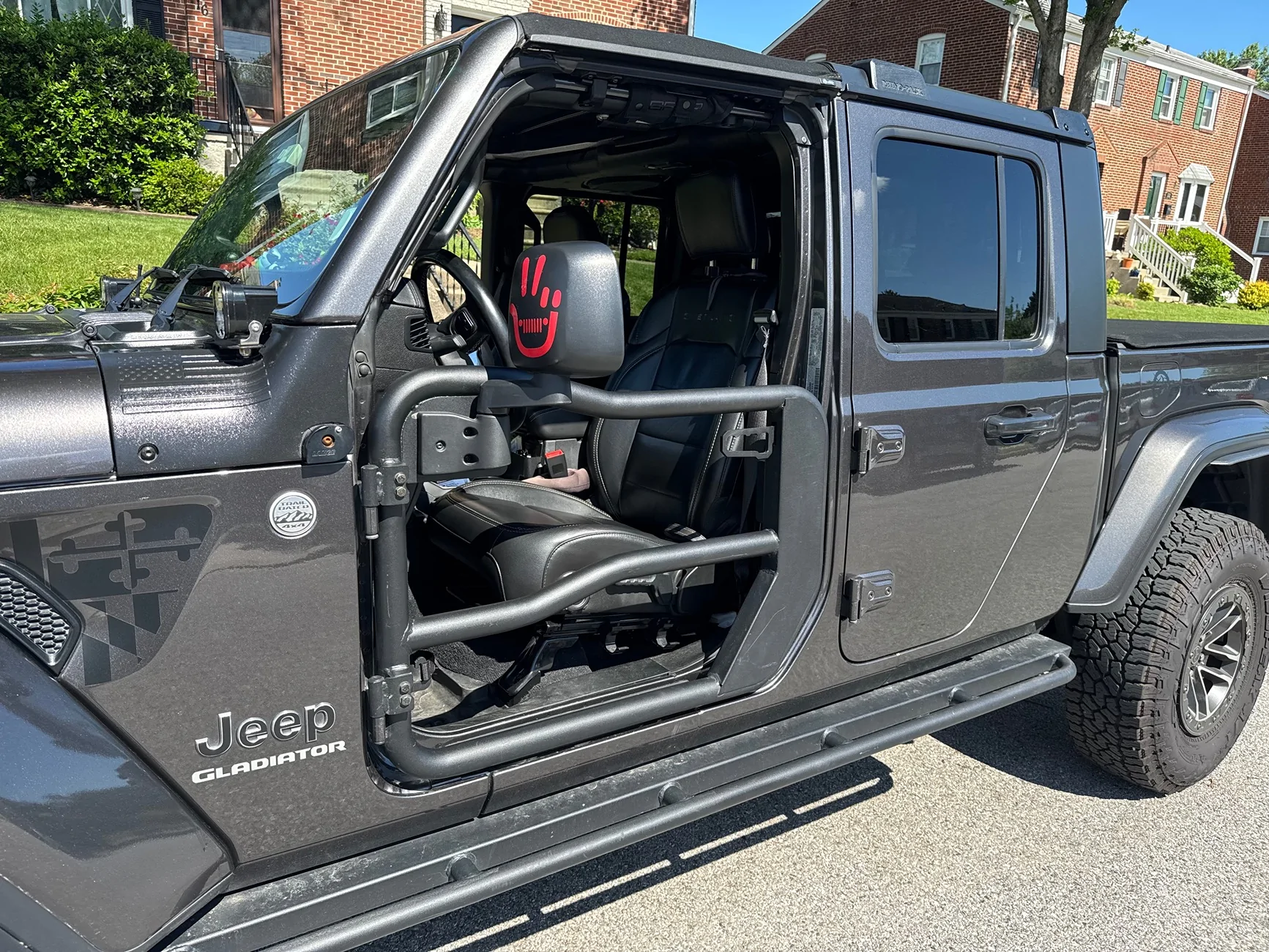

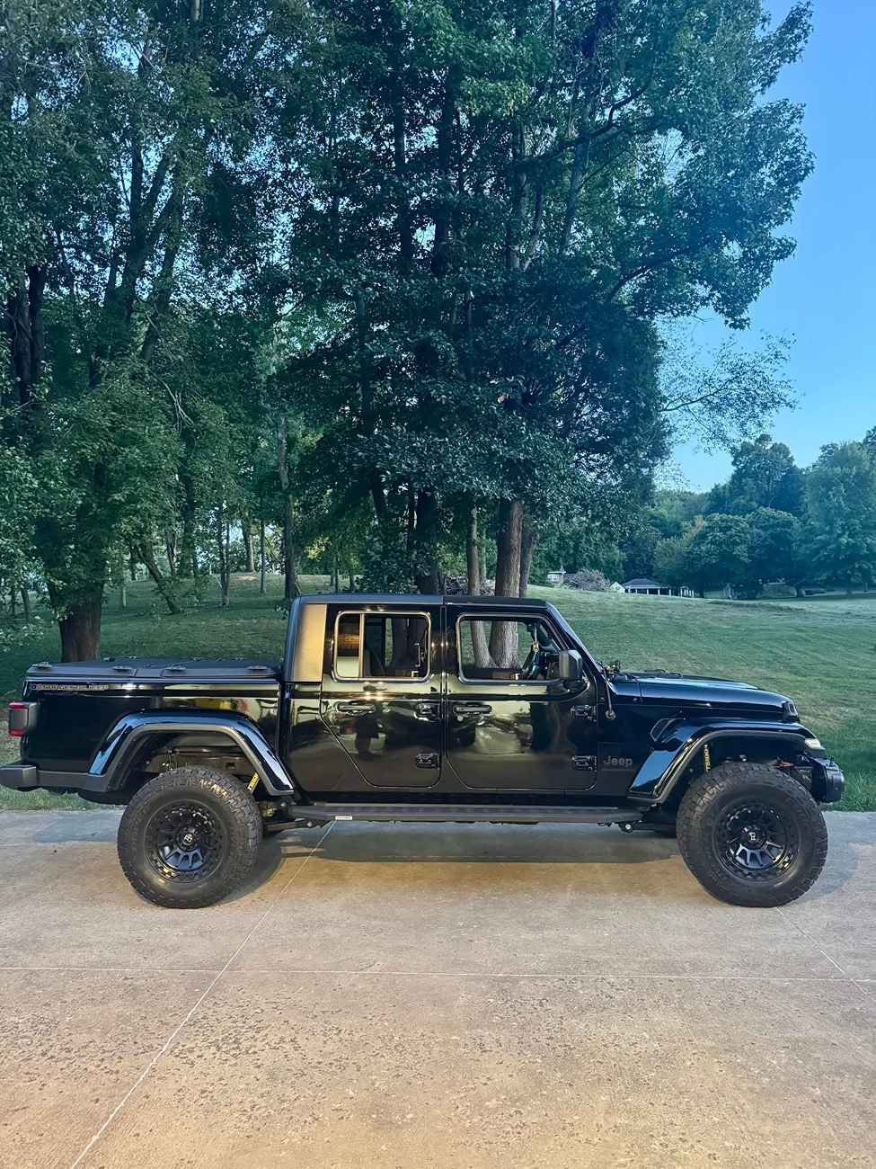

I have a 2021 Overland that I put the 2 inch Mopar lift on. I recently purchased the new Falken AT4 in 35 x11.5x17 on the upgraded mopar rims. They have offset to allow fir wider wheels. Great smooth ride and look great no extra poke. Very happy with them. I purchased five so I can replace the spare as well.

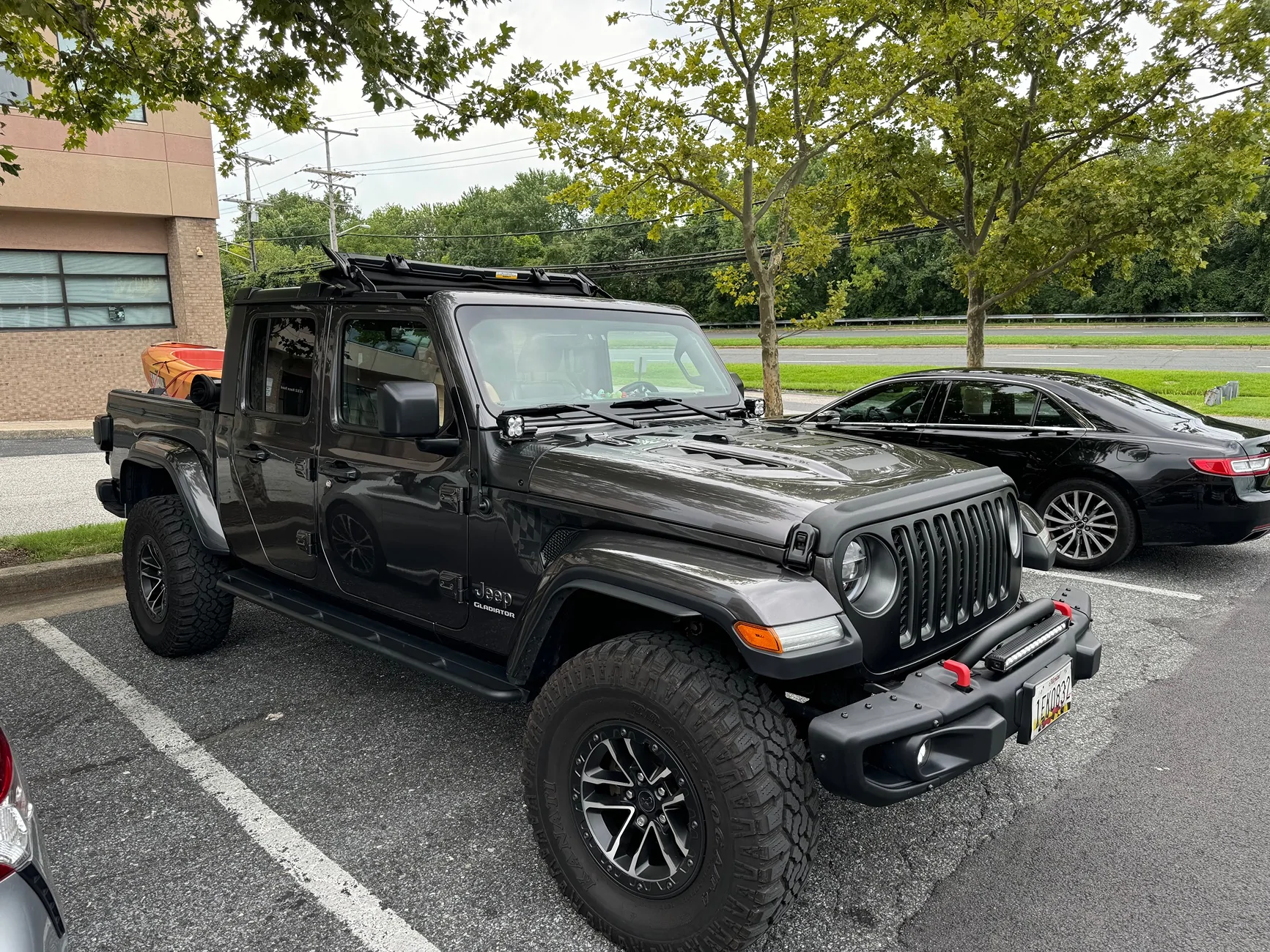

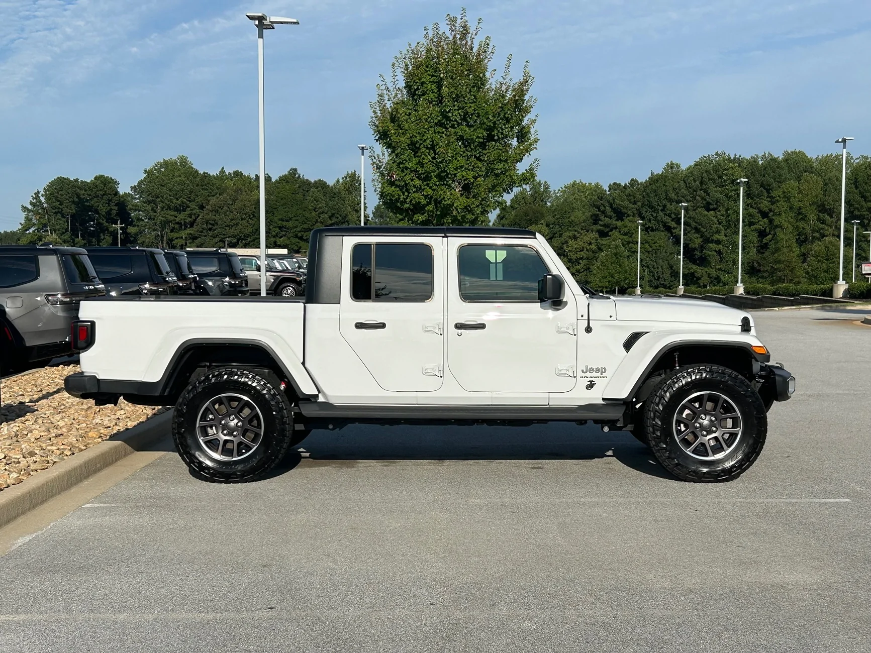

Overland owner here on 295/70/18s (35 equivalents) ran them on my stock overland wheels for the longest time before buy new wheels. Ran AEV 2" spacer lift for awhile but just added the AEV dual sport the other day.

NICE 😍
