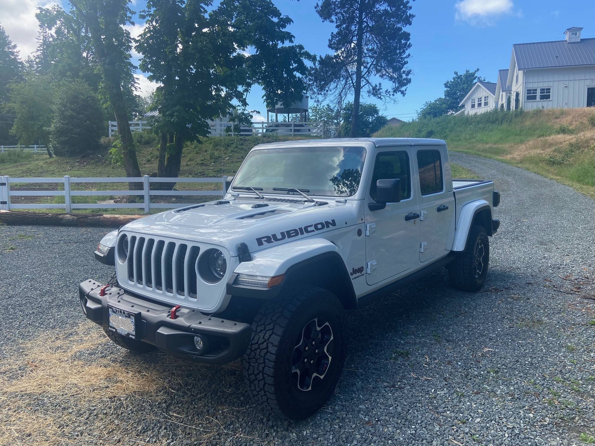

Hi guys I just got a new 2023 Rubicon. Not sure what mods if any I do. I comes with the 33" all terrain tires (not mud like Willys). I guess if I were to do something right away it may be steps sides to prevent rock damage on the hinges and fenders.
Mud flaps do that too. We have the overland steps, but don't do any rock crawling.
