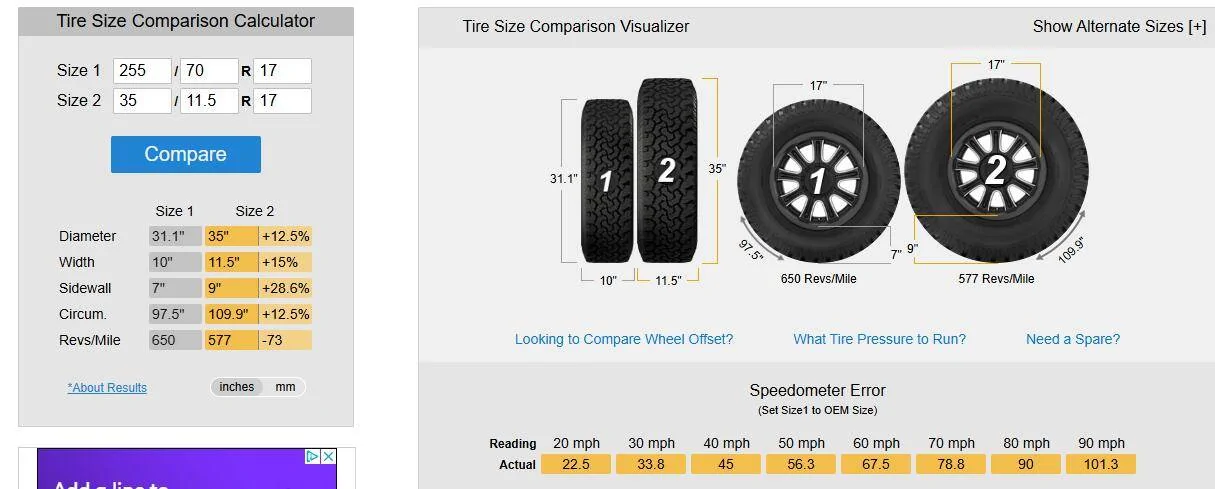

Plug OEM tire size and current tire size into this calculator to see deviation on speedo
https://tiresize.com/comparison/

Thank you all. The electronics are a couple of generations over my head so I’m going into to a learning curve.
I’m taking my near new 265/70/R17s E tires off my Ram 3500 and putting them on the Jeep. The Jeep 35s will go on the truck making both better for my purposes. Both get wheel alignments and I’ll deal with the lift kit. Research shows - so far - this is all good. Using the app that was so kindly sent tells me my speedometer will be dead on. I suspect my headlights will be fine when the lift kit is removed.
