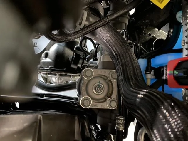

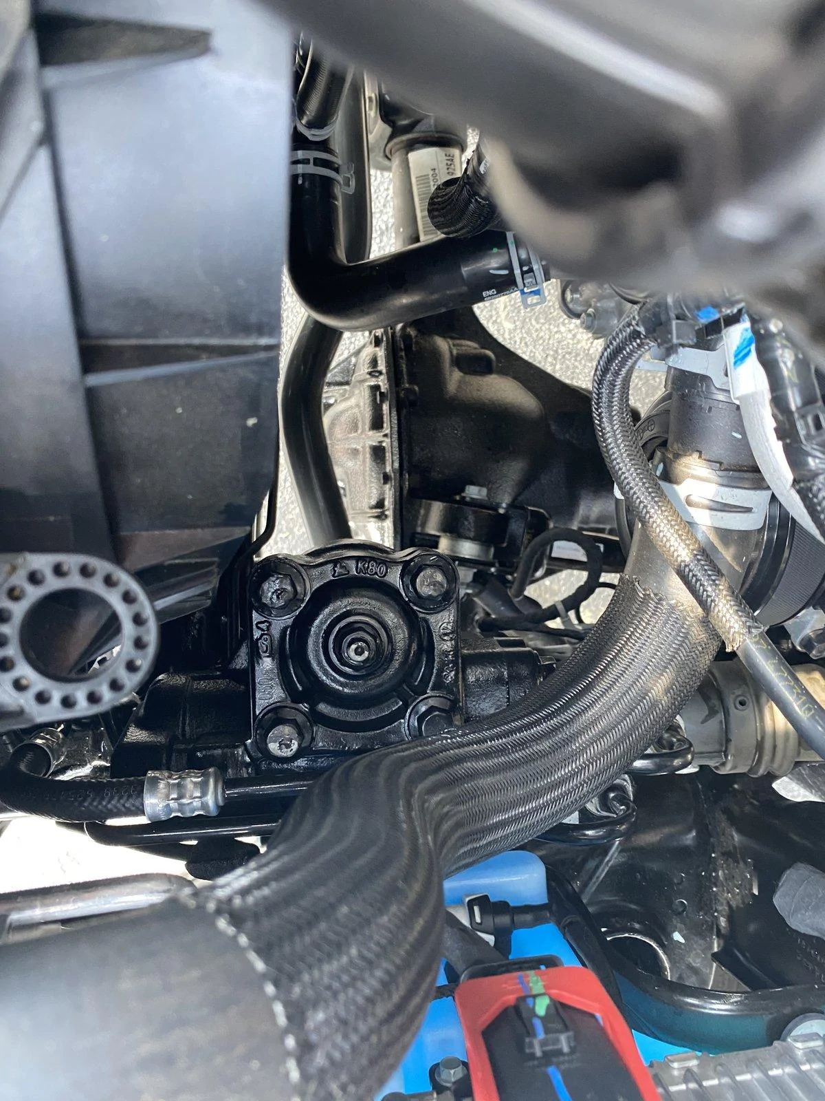

Got the fix drives like it supposed to. Before and after pictures. Left the fox stabilizer and sector brace on and they reinstated the brace and never mentioned anything.
Jeep Gladiator New JT Gladiator Steering Issue TSB 08-074-20 (for "Improved Steering Feel") 06E53261-0B45-4EB3-9B05-7F8BD0F82B51
Jeep Gladiator New JT Gladiator Steering Issue TSB 08-074-20 (for "Improved Steering Feel") C17804E6-8BE6-4897-884E-B0D7C6992E57
Great post.
Jeep Wrangler is a cult vehicle. Part of it's charm, and reason for many sales is that Owners can modify the Jeep.
I'm glad they left your parts in place.
Looking back, when this is all done, we'll know it was just an Obstacle and we overcame it.
