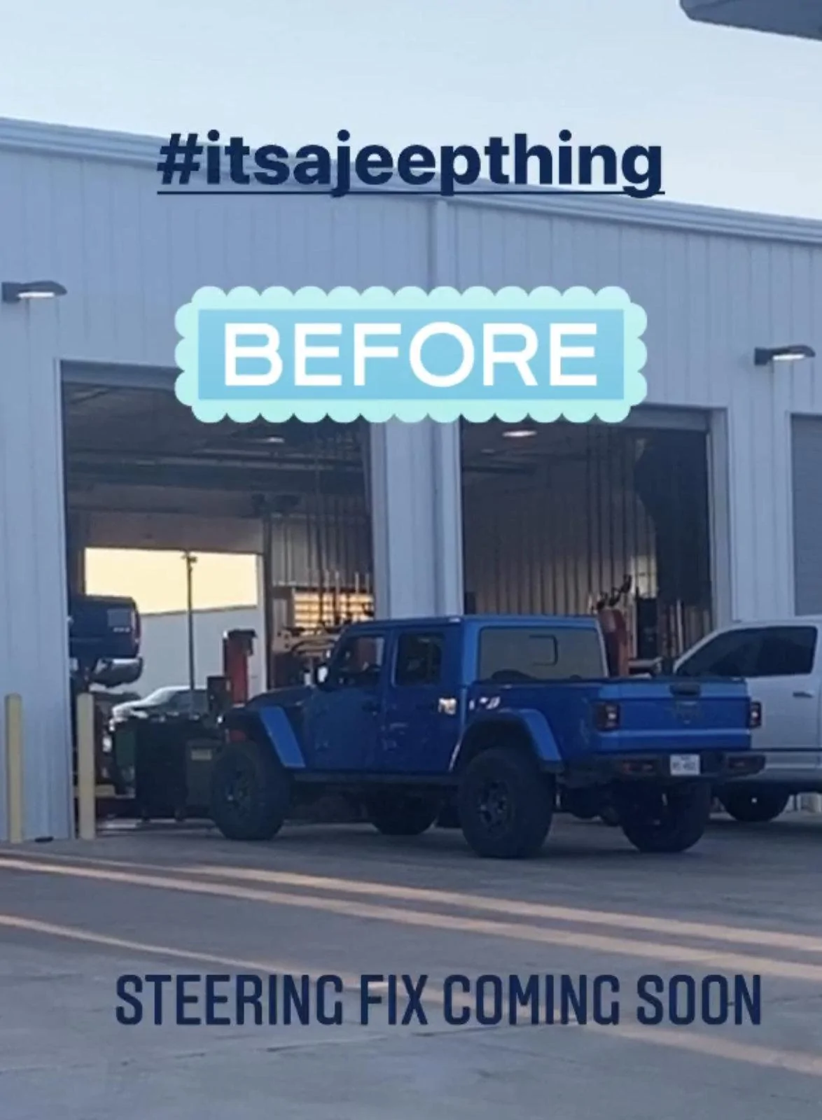

Here’s my take....I picked up my Gladiator after having the TSB taken care of. I also had them put a Teraflex adjustable track bar on while they were at it. I KNEW instantly the moment I was driving in the parking lot that the steering had changed 100% for the better. I never knew what people described as loose and sloppy steering could be experienced at less than 5mph. I just thought it was a “jeep thing” which I read a lot about. In either case, I thought it was normal until I now know it wasn’t. Easy to note how wandering occurs at high speeds, cross winds, pot holes or manhole covers, dips in the road can cause issues. What I didn’t notice until the TSB was done was the “feel of the wheel”. So much better!
That said...parts manager said I was the first at the dealership to get this done and to send anyone over on the forum that may need it done. The only limitation is he can only order 1 TSB parts kit every week.
