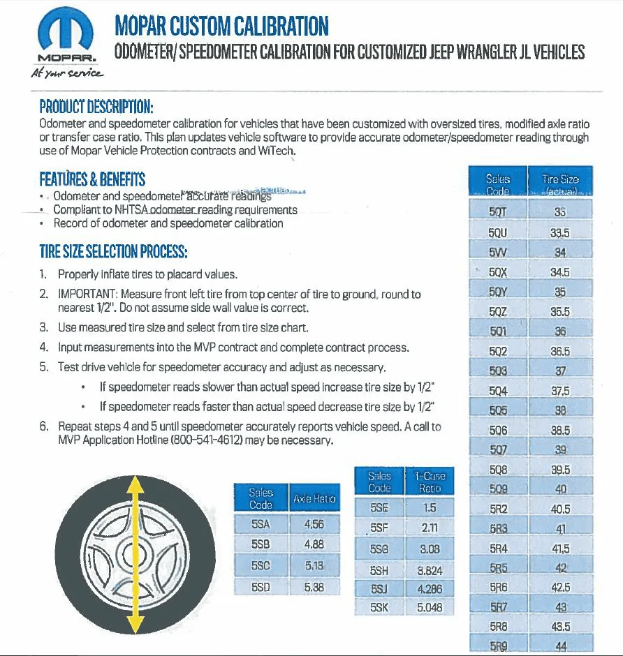

As of now, the techs cannot simply go in and make changes— they tried it. My dealership wasn’t even going to charge me. There is a “software” purchase you now have to make to even initiate the reprogramming.

If you read 4., that is where you have to buy the “contract” before the tech can now have access to the required screens.
This isn't true, my buddy used my JScan equipment to reprogram his 2021 Mojave he just bought, not sure what they told you at the dealership or why they said that
100% correct! The simple scan tool drop down menu went away when the JL was released. The dealership can not press a button and new tire setting is set using their FACTORY scan tool program.
Maybe at the dealership they can't but if you get the JScan license and the security bypass harness and the bluetooth module then it will get it done and that stuff cost around $95 and can do way more than just reprogram your tires. Not sure why you would spend $130 at the dealership.
You stated what NC4stroker said was not true when it 100% is. The technicians at the dealership can no longer just flip a setting in a second and send you on the way. Whether or not somebody thinks that the money spent is worth it is up to the owner.

Jamie was responding to the sentence that you now had to make a software purchase to even initiate the programming.
That is only true if you need to have the dealer do it.
I have the software so i could change tire sizes every month if i wish....and it does so much more!
