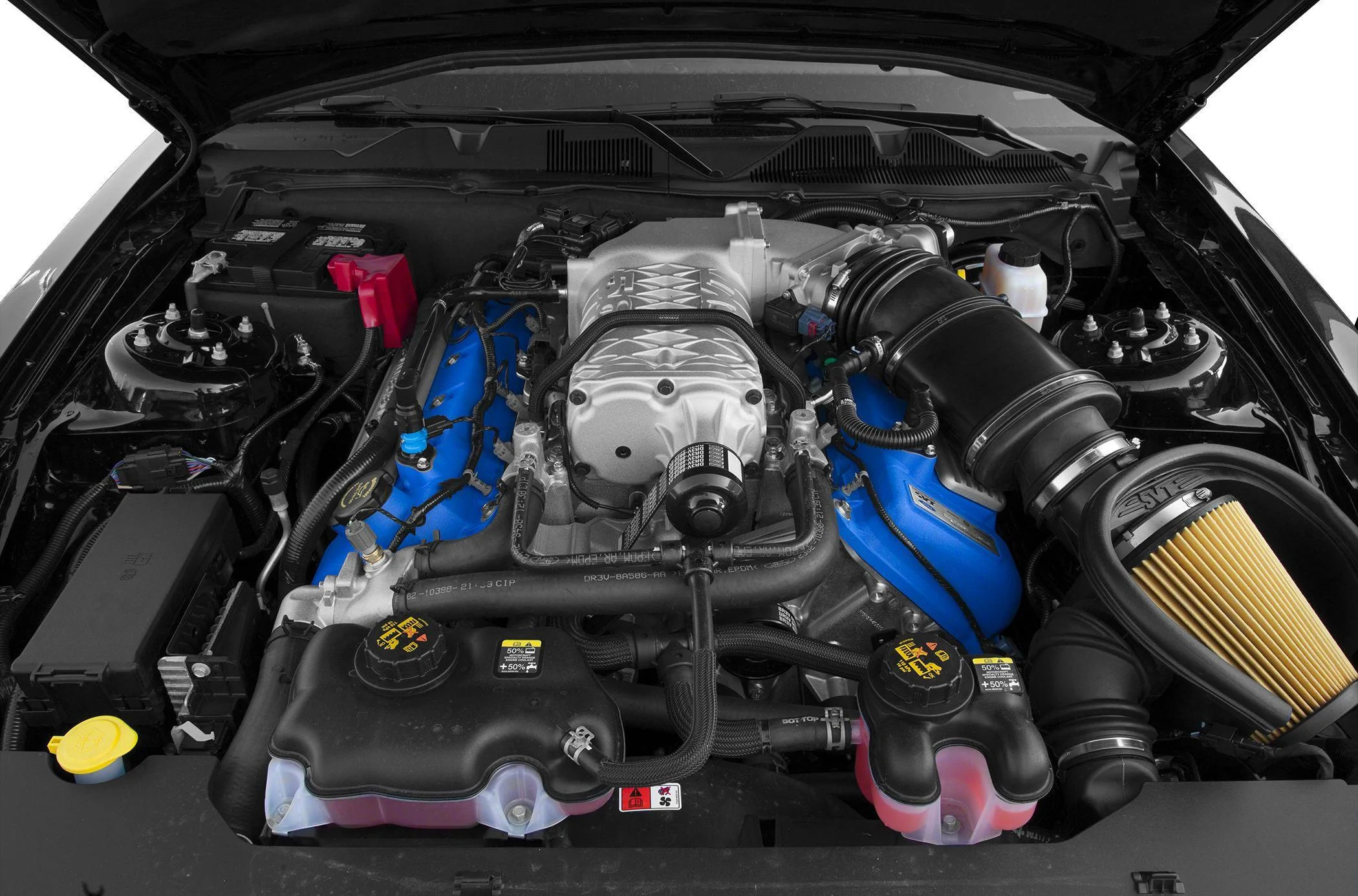

Cannot comment on the Gladiator here.. but on many vehicles in the past the engine cover was to hide the ugly engine with wire harnesses all over the place. No other purpose. Look at Ford's crown jewels - the Cobras... and GT500s too which were also Cobras....no engine cover in sight, even pre Terminator era ( no blower ). It was just a well designed aesthetic engine compartment.
2001 Cobra, NA:
Jeep Gladiator New Willys JT and no engine cover 1999_cobra_motor
Point stands - engine covers are for ugly engines.
40,479
53,962
2001 Cobra, NA:
We're talking performance cars there - a bit different than a vehicle trying to meet CAFE and sell based on other factors than that "look at me, I wreak of pure power and beauty".
Selling that engine sold cars. They didn't give a rip about sound or MPG.
But following the different developments of shielding and other factors, for the "average vehicle" and even more-so today, it's not because of looks.
Besides, where they hell would a cover fit under that hood! LOL. You want to see that engine - it's going to help sell the car.
