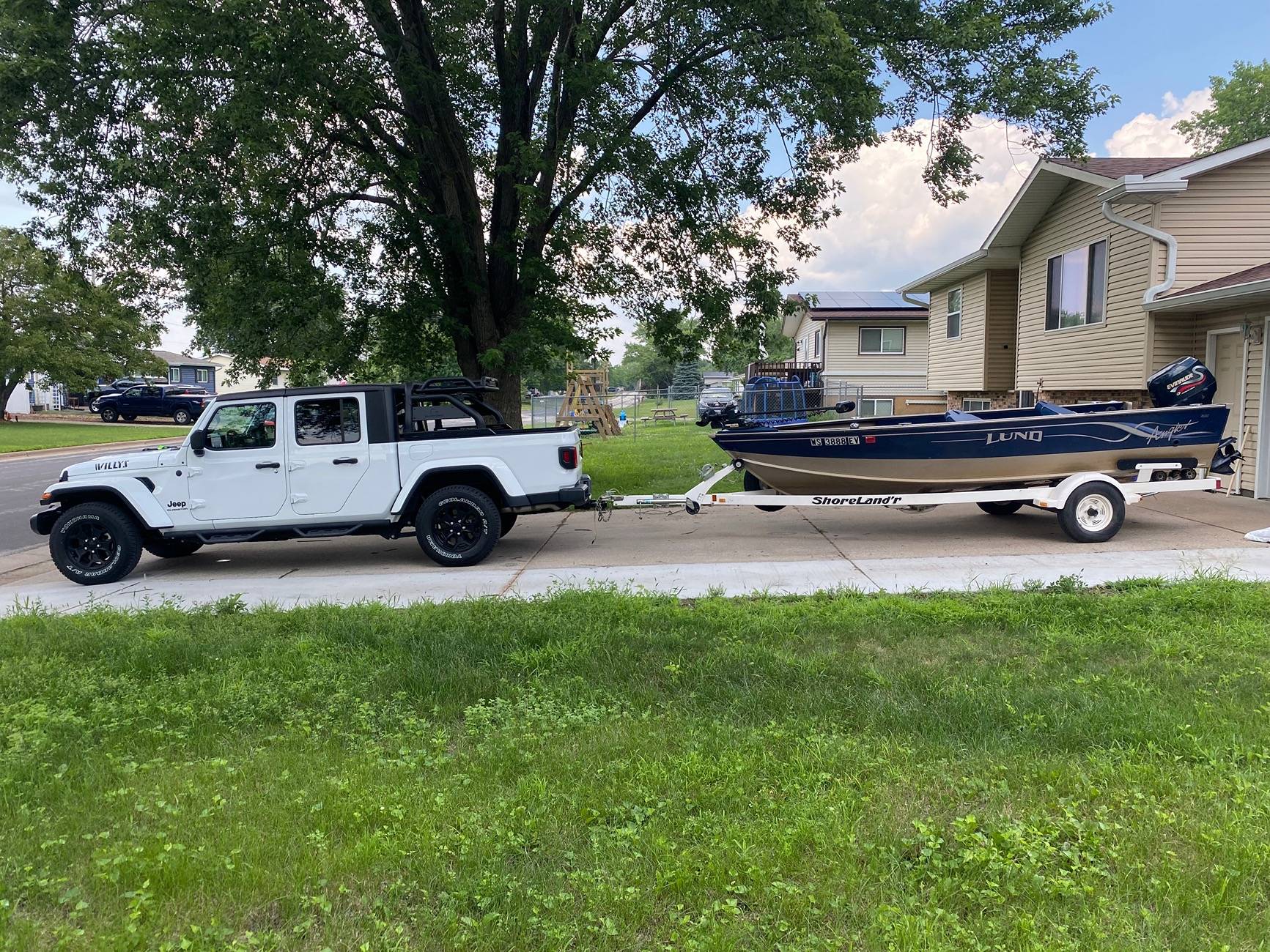

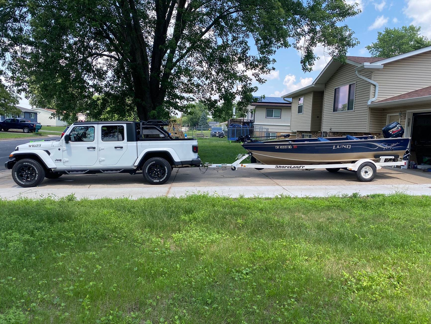

Got the boat on. I’ll have to go with an in-line straight hitch to counter the few invest I lost from the ram 1500 I had. The bottom sits about two inches low and the back two inches. Not bad and good enough to tow but I like keeping things inline.

I drove the trailer down the highway to a truck stop a couple towns over and weighed my boat and trailer. My guess was 2000lbs loaded how I would normally trailer it, which is with all my fishing gear in the boat. It can out to 2100lbs on the CAT scale with half tank of gas. Not to heavy at all. Still well under the 3/4s tow and tongue weight for class 2 hitch. It trailered nice. Coolant, trans, and oil were 215, 200, and 215 respectively at high end and that was usually merging with traffic so I was heavy on the gas or when I was going up hill. Otherwise they settled a bit under those temps. With the bot being so light I didn’t have to manually shift it. Shifting and rpm were fine with automatic. It does feel doffeeent than the 5.7 hemi that was in my ram 1500 though. lol. Totally expected but it wasn’t bad at all. You could just feel it more under heavy acceleration.
