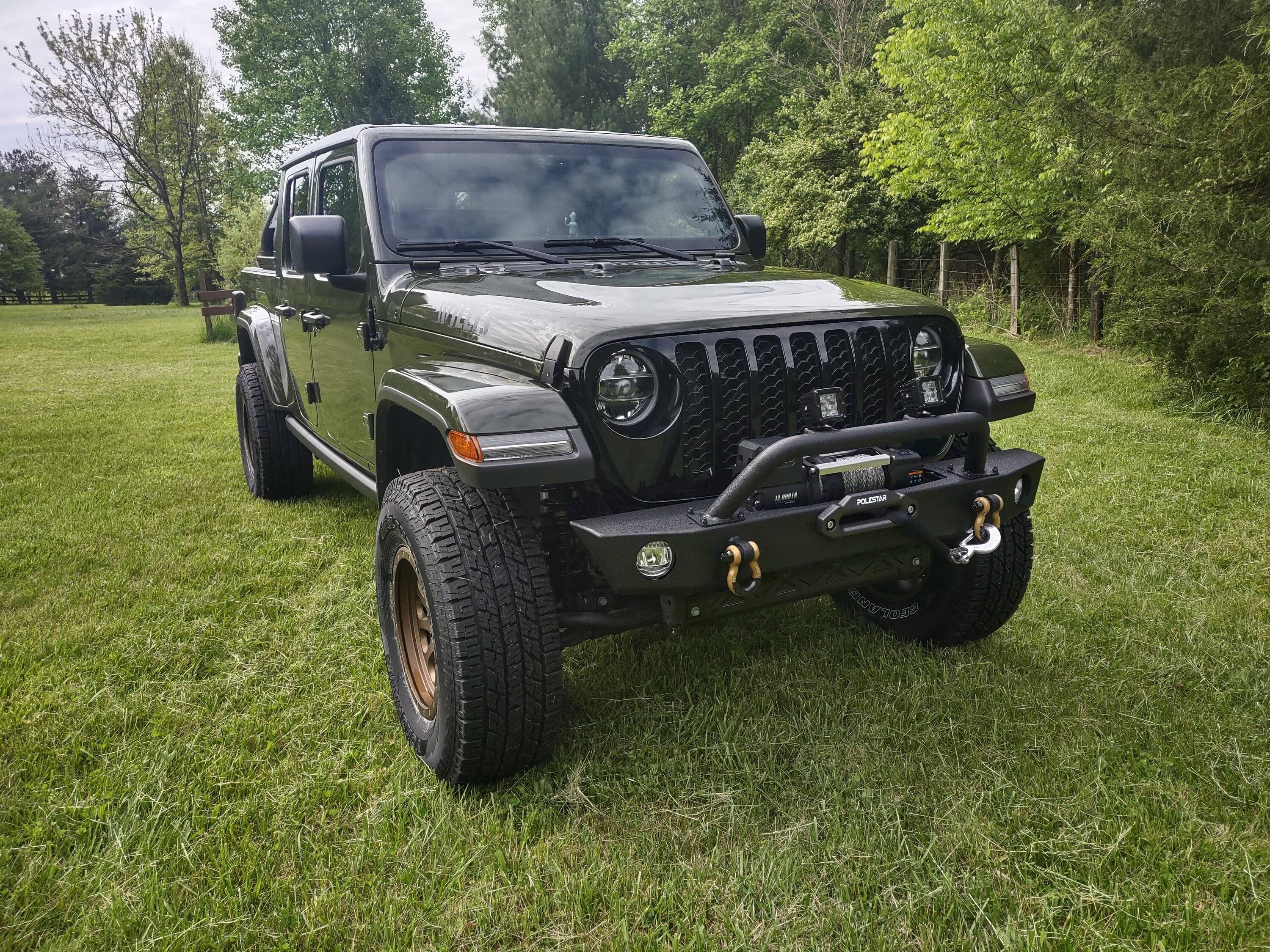

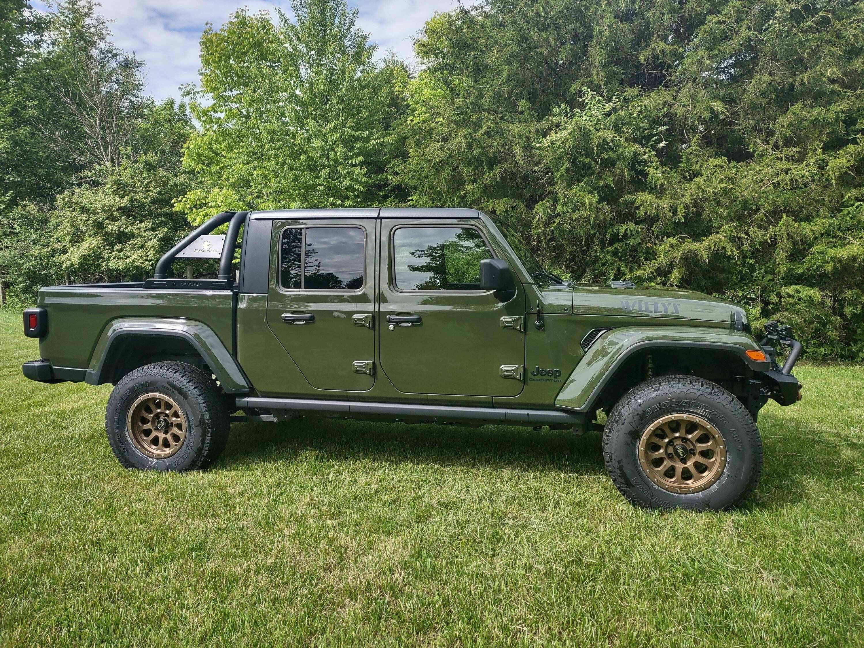

It was invaluable! Many thanks to everyone here who offered help as I was new and mostly clueless as to how best get the look I wanted: especially in the wheel and tire dept. I went with the 315/70/17 Yokohama tires and +12 offset on the rims. To the guys that talked me out of the -12 rims I was about to buy..so grateful these have just the amount of poke I wanted I was going to be way off. Lastly the one mod I had but is now gone are the Oracle taillights so many warned me against, thanks for the effort, here my stubbornness screwed me: those pieces of shit stopped working a week after I installed them ?

I’m curious, what stopped working with your Oracle tail lights? I’ve had mine on for over a year at this point and haven’t had any issues.

Liked the look but the backup lights started working only sporadically maybe it always did but I noticed it about a week in.

Oh yeah, they’re not truly plug and play unfortunately - need to set the backup lights to LED using a tool like JSCAN or a Tazer. The factory LEDs look slick though, I wouldn’t have gotten oracles if my truck came with led’s.
