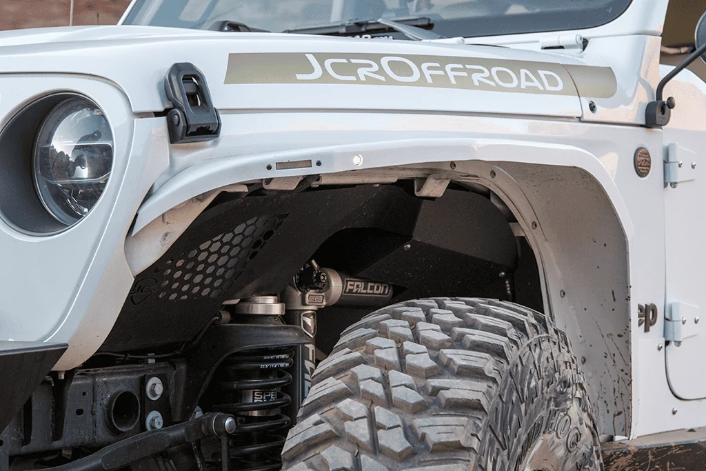

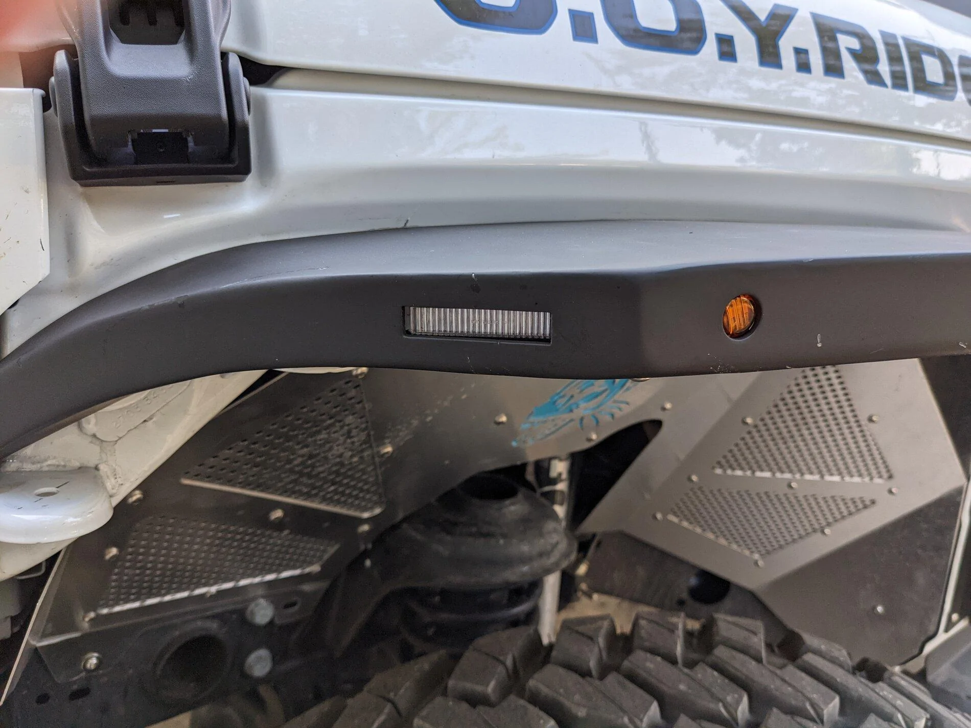

JCR fenders have really minimal lights. You don't wanna go with zero side markers.
Interesting fender and clever light placement, etc.

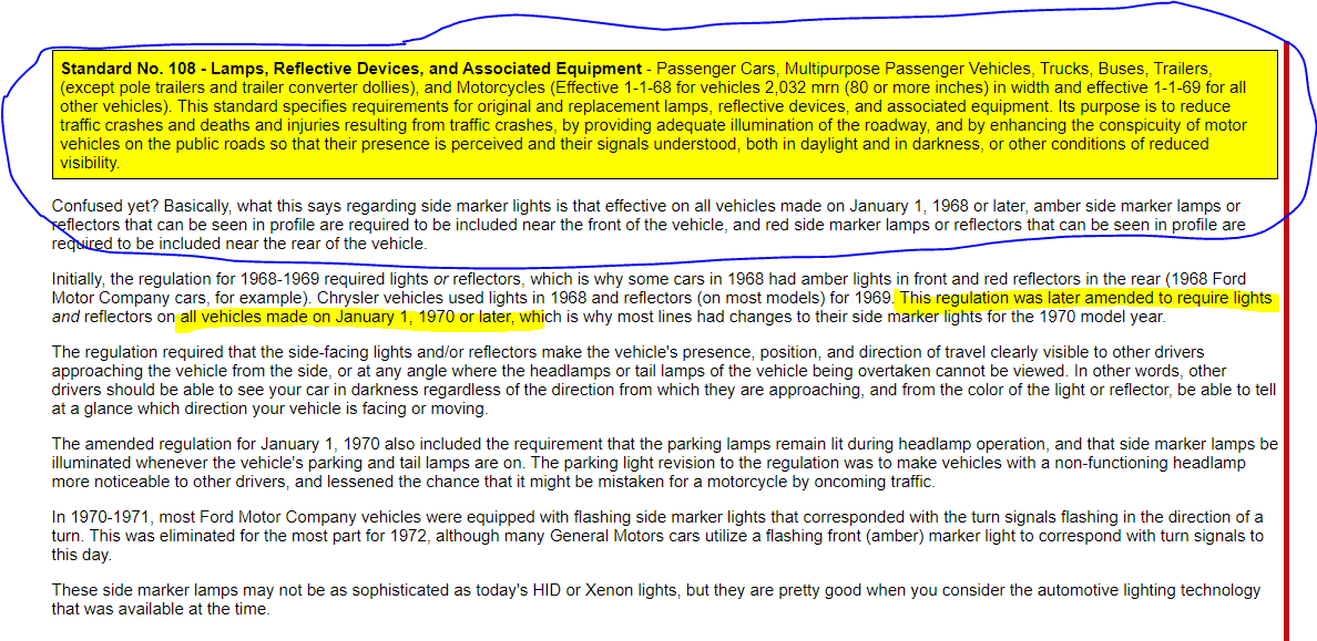

Here is from a major automotive site -
Effective January 1, 1968, all passenger cars built for sale in the United States were required to display amber lights or reflectors on the sides of front fenders, and red lights or reflectors on the sides of rear quarter panels.

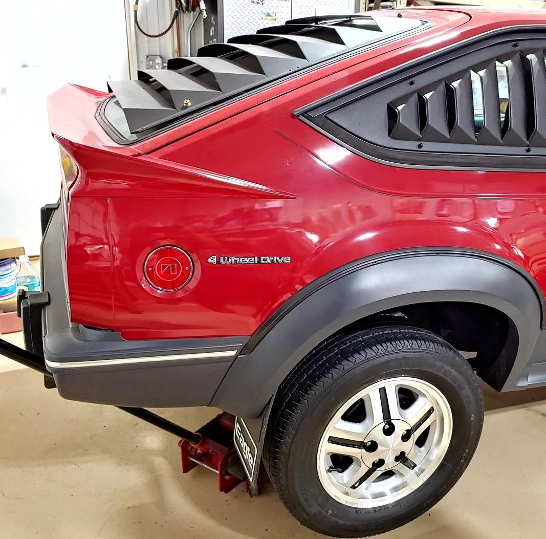

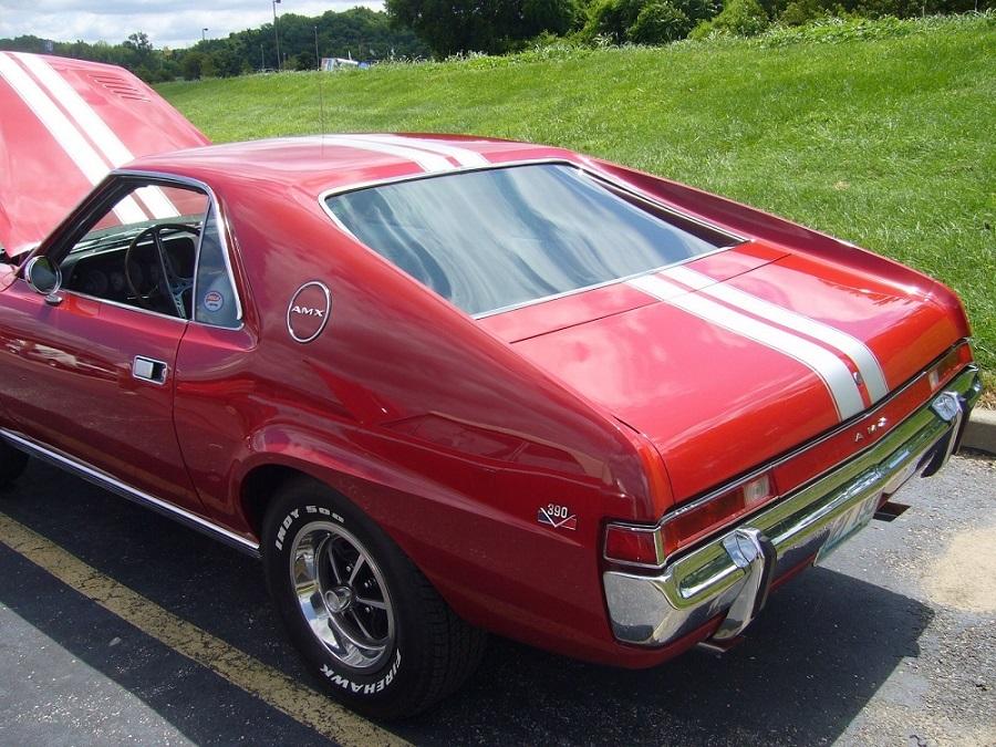

Here is how one company complied - wrapped the tail light around the side - for the 1970 model year they shrunk the tail lights and put independent side marker lights in the quarter panel.
The pic below is how many companies handled the requirement over the years. They simply made the red or amber lights visible from the side - they didn't always have distinct lights in the quarter panel or the fender.
Jeep Gladiator No DRL / Blinkers options P1060897
And in the late 70s they got clever and put their logo on the lights. Do you really think that if it wasn't law that auto makers would spend money coming up with new wiring harnesses, expensive light housings, revamp their quarter panel and fender stampings to put lights in them?
Also - side marker lights like this have a LEFT and a RIGHT so that the light is not visible from the front or an angle. Most side markers are marked for which side they belong on because of the requirements for reflecting light certain ways.
Jeep Gladiator No DRL / Blinkers options rear-marker
