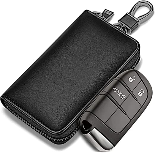

Some have suggested to keep an extra key in a faraday bag hidden inside the vehicle. That way, you can always get yourself home if you find yourself with the key. They run around $15. Of course the Jeep key fob may require a tablet bag, lol.

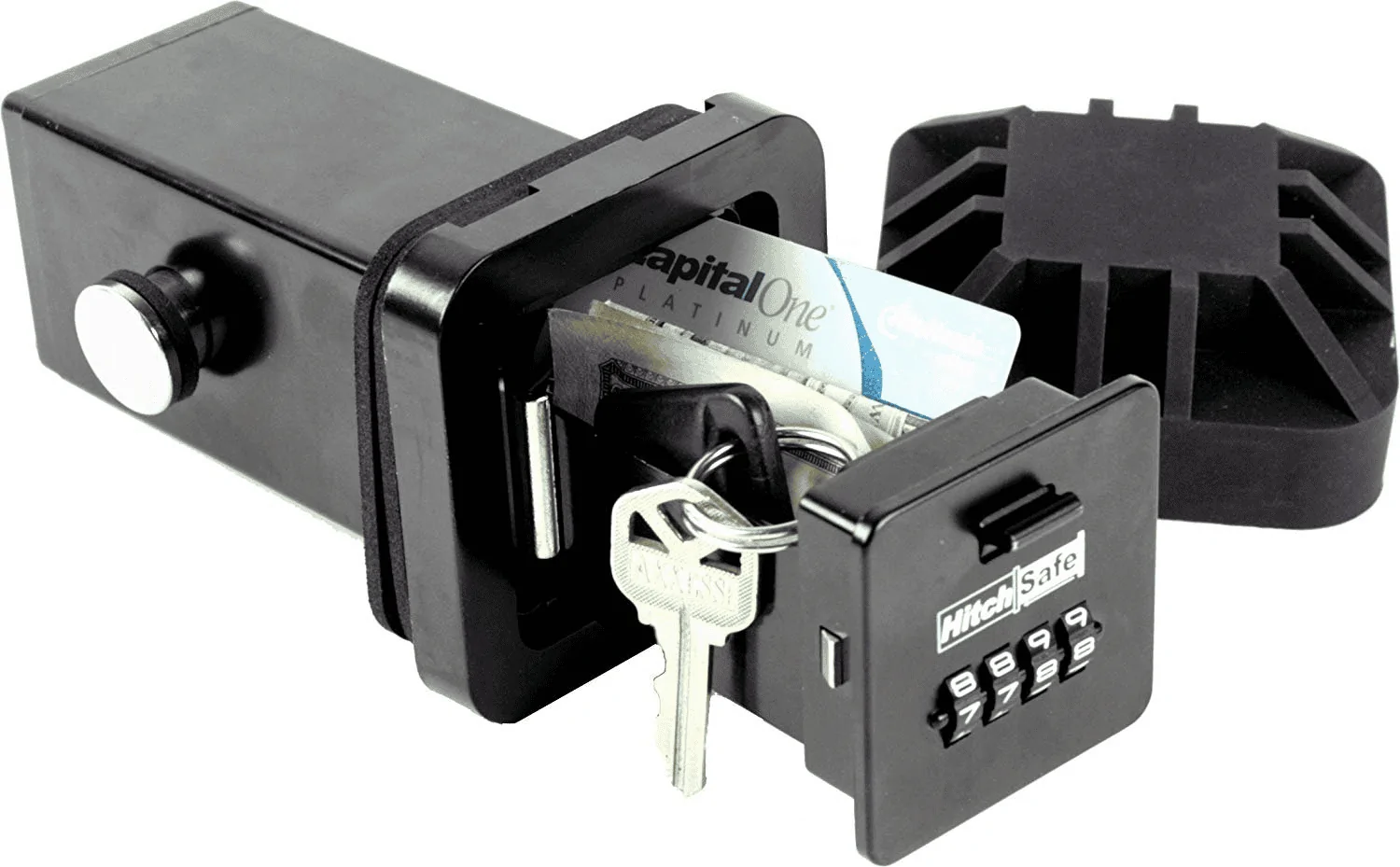

Yea that is a good thing to remember. So pretty much keep the spare hidden in a faraday bag and learn how to use the Sirius remote access and you will be in good shape. I do lots of water and outdoor activities (fishing, boating, hiking, hunting, and running at parks) where I could easily loose the keys. I've seen the hitch key lock and thought about buying it instead of hiding my key (what i do now).
