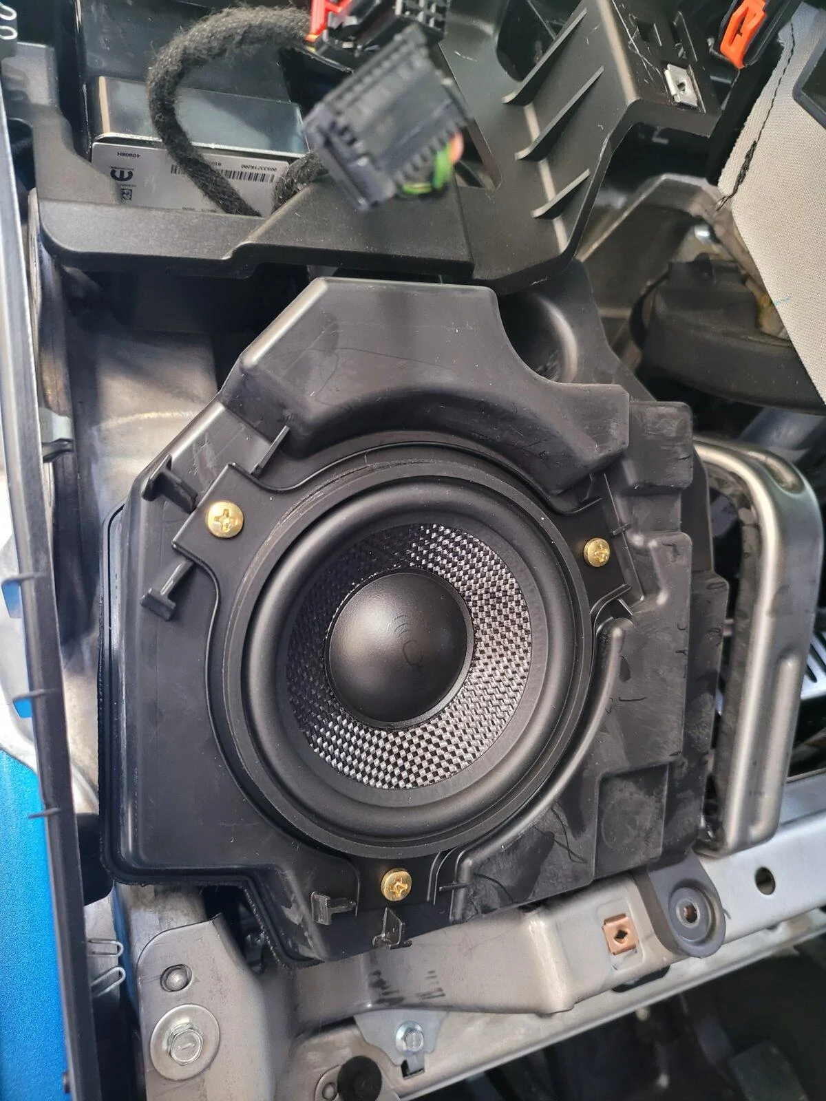

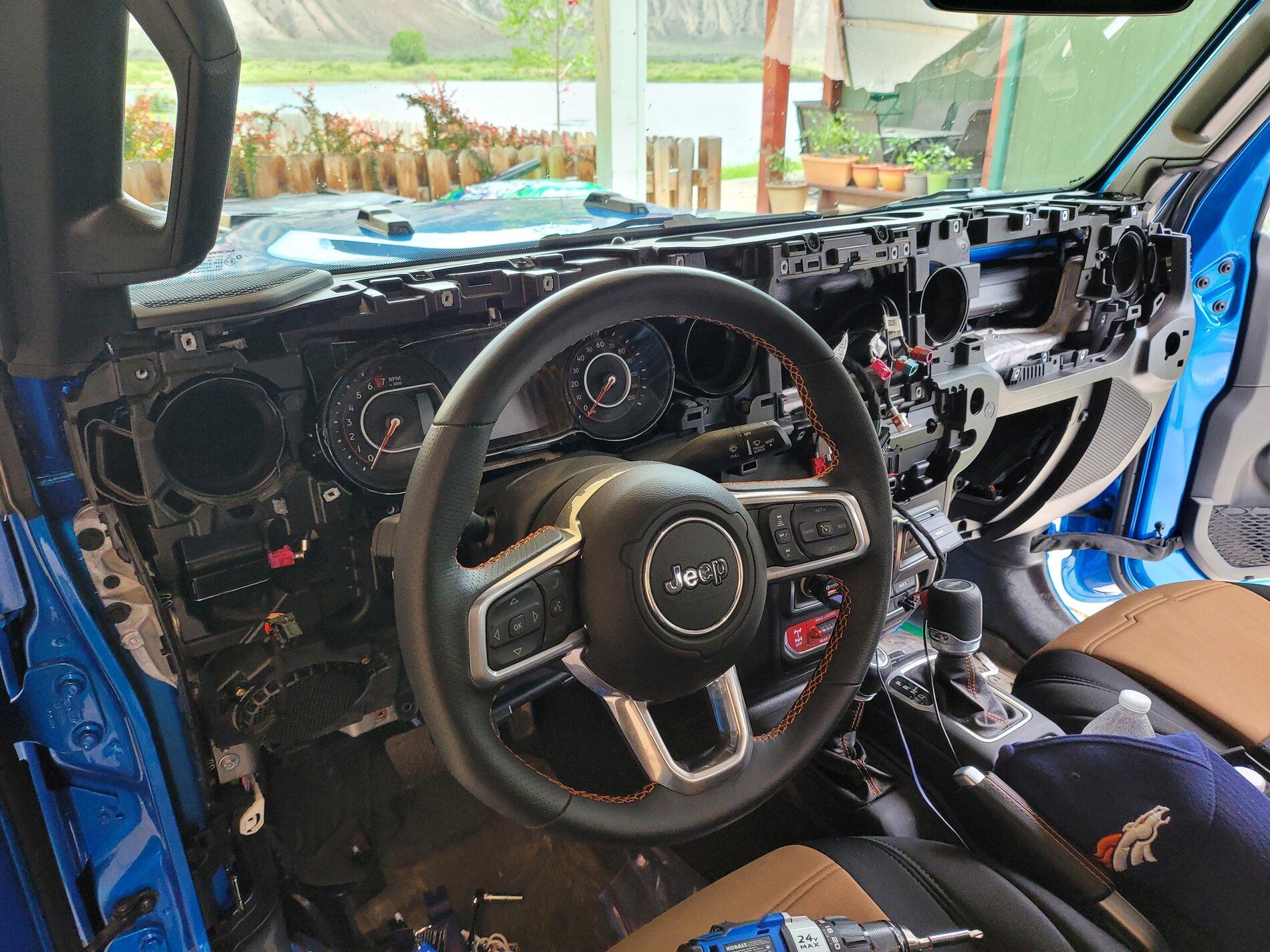

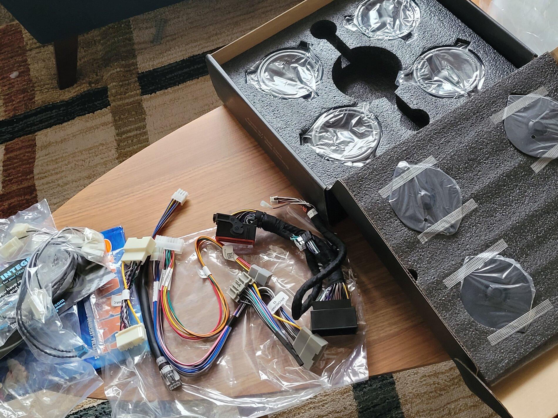

Hit a snag, missing critical harnesses but they are sending another box so in the meantime, it's on pause and my truck is in pieces. Besides the oversight, packaging, harnesses, quality, and customer service is top notch.
I have the power inverter so it cannot go back in as that space is now occupied by the OEM+ sub amp and bracket.

Wow. Definitely torn apart. Hate to hear about the snag but you definitely look ready to go once they get you the harness. Good to hear otherwise everything looks top notch, probably as expected. Thanks for update. Good luck finishing install, and definitely interested in impression when you’re finally in business.

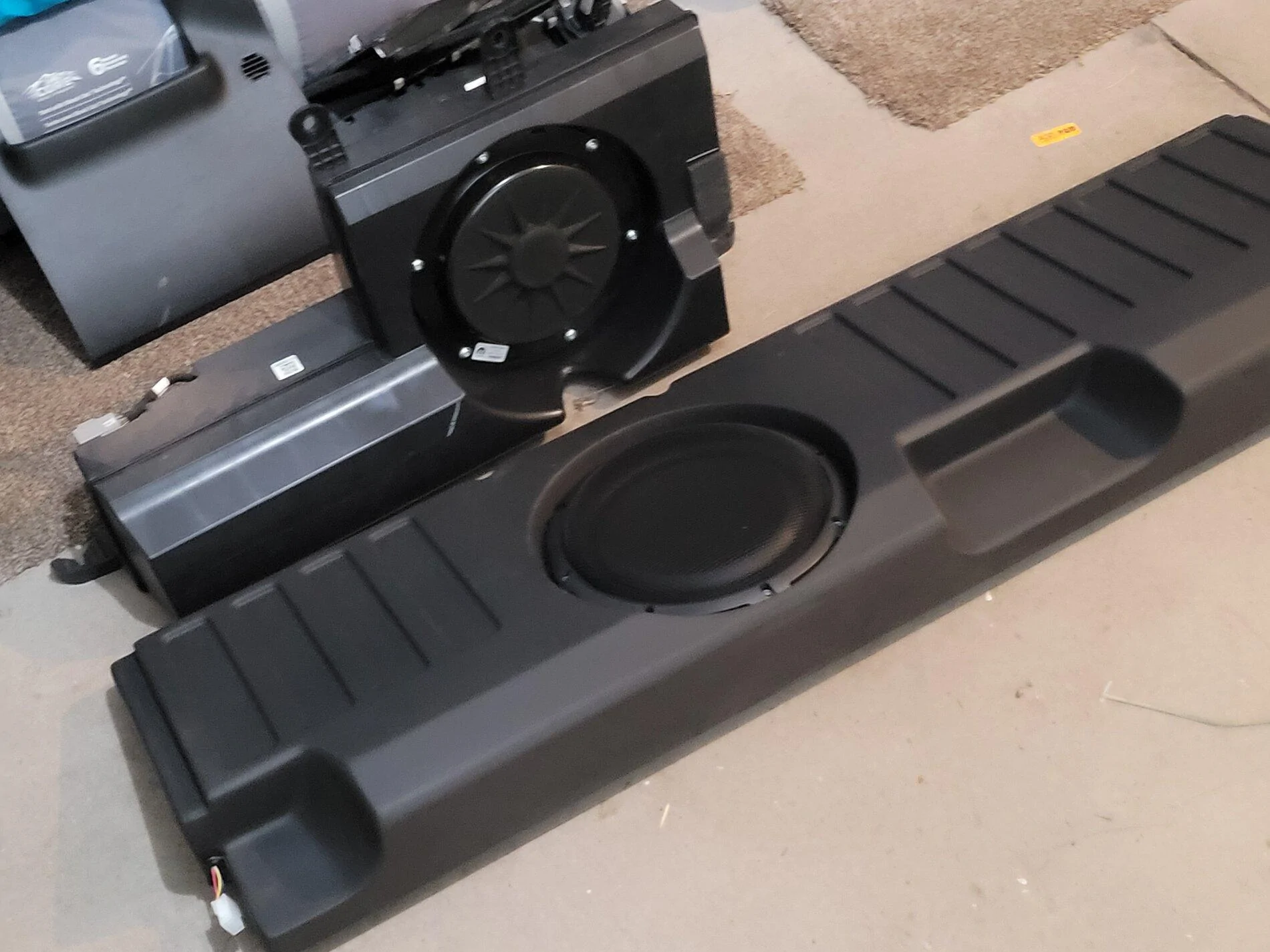

Guys, after listening to the sound tuning Spotify playlist Daniel @ OEM+ sent me and other playlists on Spotify, the sound and staging is great. The factory Alpine system was a bit muffled and the sub was muddied, hence my purchase. My favorite component of the OEM+ system is the sub for sure. It's in a 200% quality built fiberglass custom enclosure that fits in the rear storage cubbies against the back wall.
@ $3K (after $500 disc) plus another $400 for non-Alpine back panel and storage cubbies, it's a bit steep.
Daniel said they were able to restore the power invert back under the dash, and if this is true, I will be very happy.
Except from some minor oversights and the high cost, overall, I'm very happy with the system's design (plug and play), sound staging and tuning, It's genius.
I have yet to have a listening comparison with the factory Alpine system but I can honestly say that OEM+ is much better and will sustain clarity at higher volume.

No, the harnesses integrate factory amp with OEM+ main amp. Only the speakers, sub, rear panel and storage cubbies are removed. I broke the clips and put a small crack in the rear panel during the removal process, although, it can still be reinstalled.
