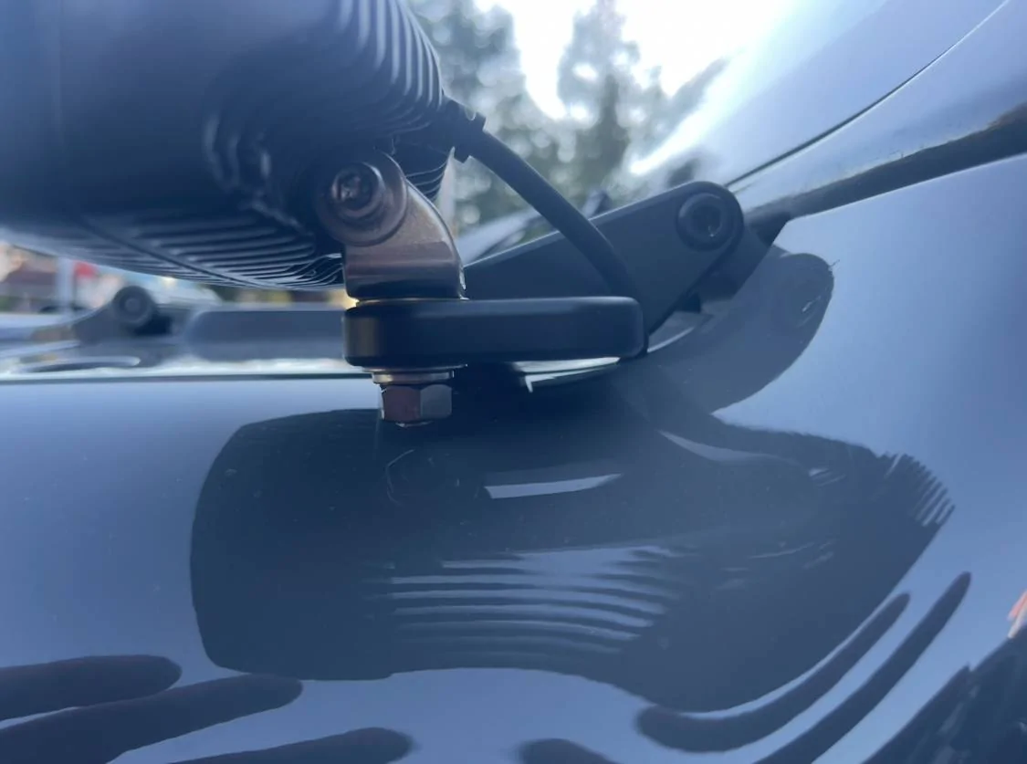

How did you mount those bumper lights? TIA
I mounted them via one of the bolts in the top of the factory steel bumper. More than likely going to move them to the front but need to remove/get a different bar for the bumper as they won't fit with the Mopar bar I have on there.

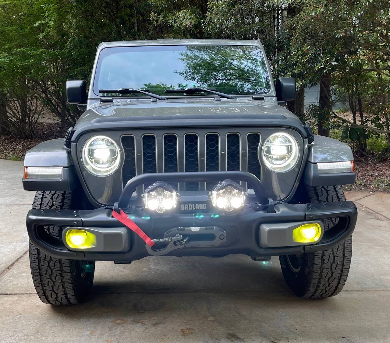

I have roadshock 4s that have hi, low and markers
The marker lights I have tapped to the running lights
The highs and lows are connected to a 5 pin relay and connect to an aux switch. Off the relay, I have the high beams triggered by the vehicle high beam ciruit.
Headlights off, aux switch off= no lights
Running lights on, aux switch off =no offroad lights but marker lights on
Vehicle Low beams on, aux switch off= no offroad lights
Vehicle low beams on, aux switch on=offroad low beams on
Vehicle high beams on, aux switch on=offroad high beams on
Vehicle high beams on, aux switch off=offroad high beams off

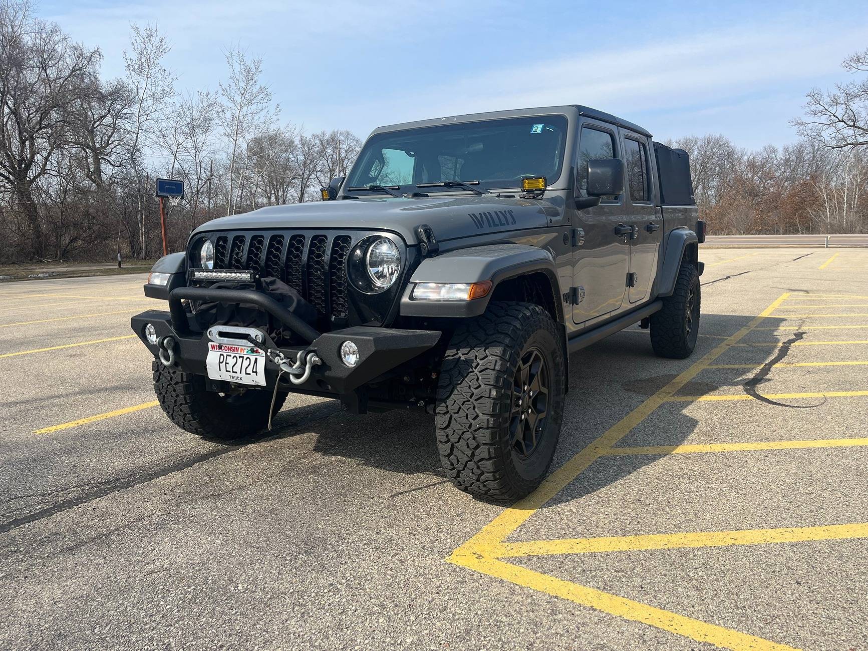

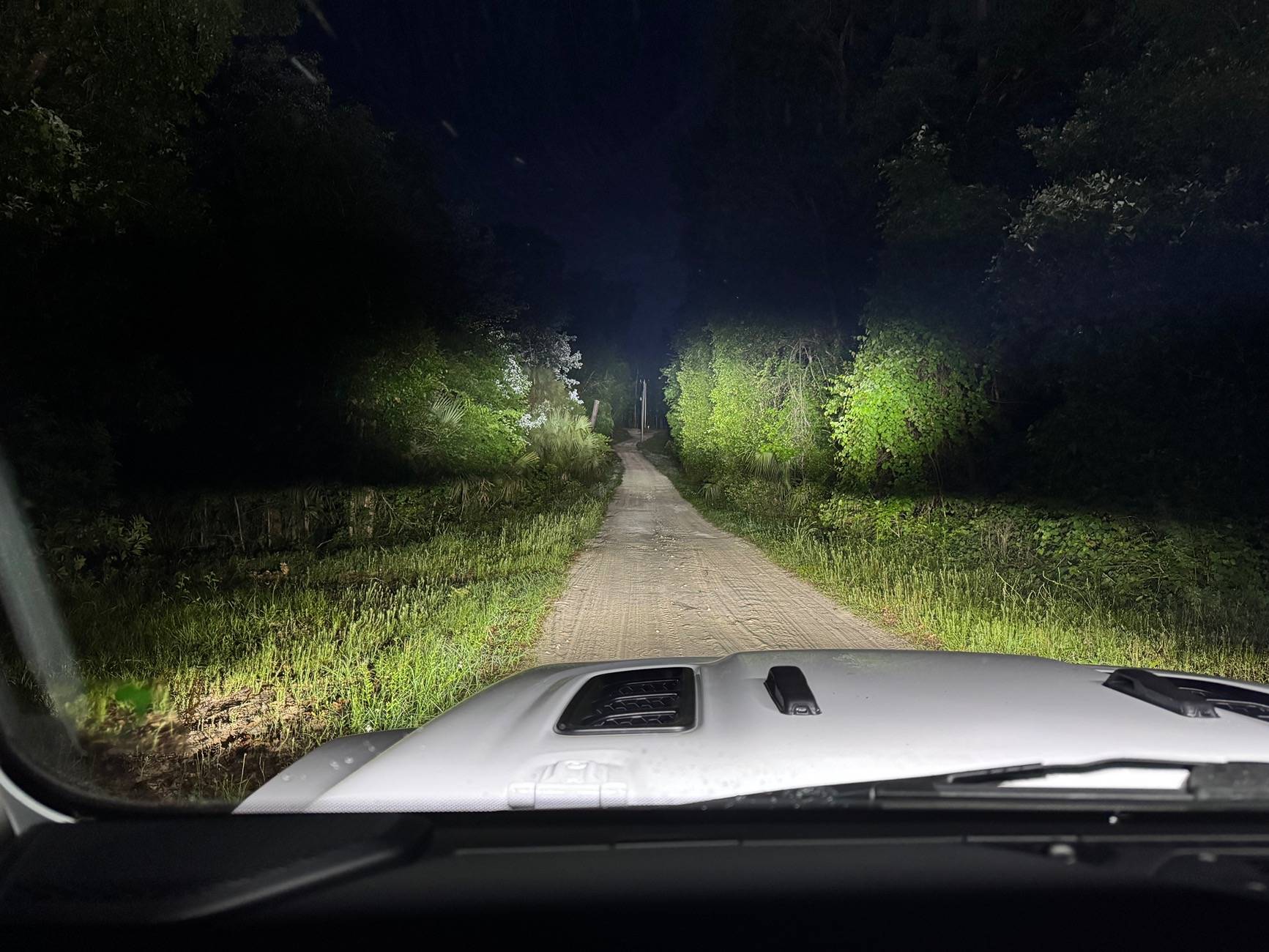

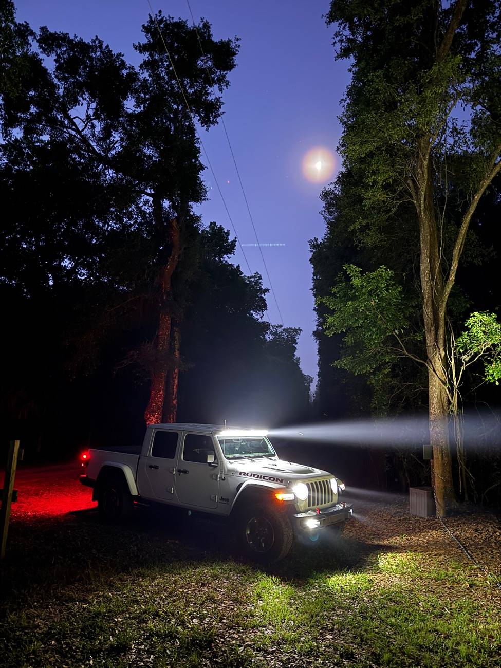

I have ni-lights amber on the side of the hood and a simple white bar in front. Lot's of light for just about anything you would need it for...
Jeep Gladiator Off road lights - what's everyone running? IMG_7114

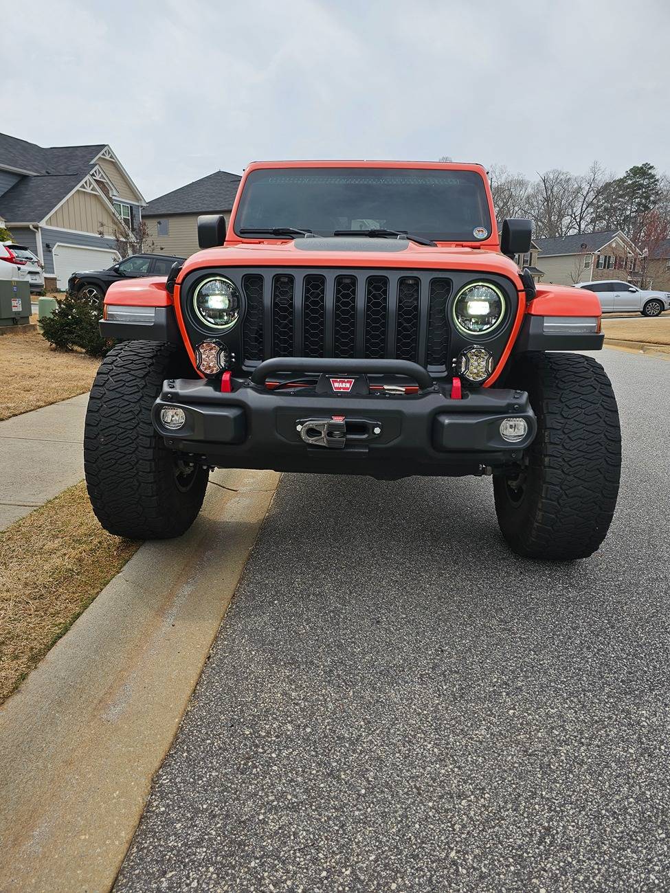

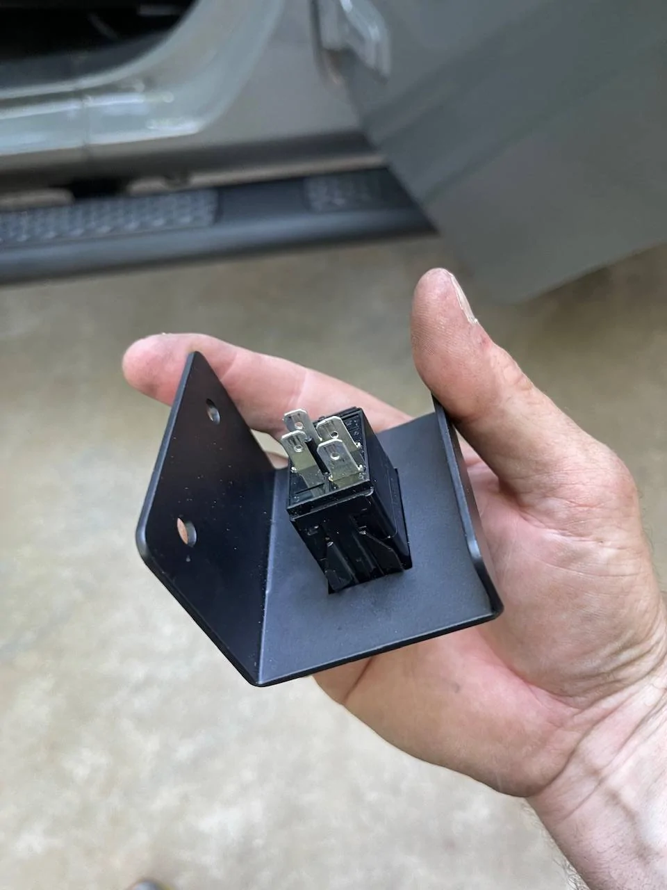

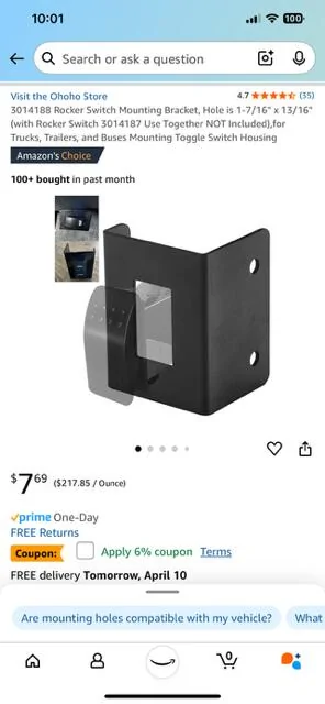

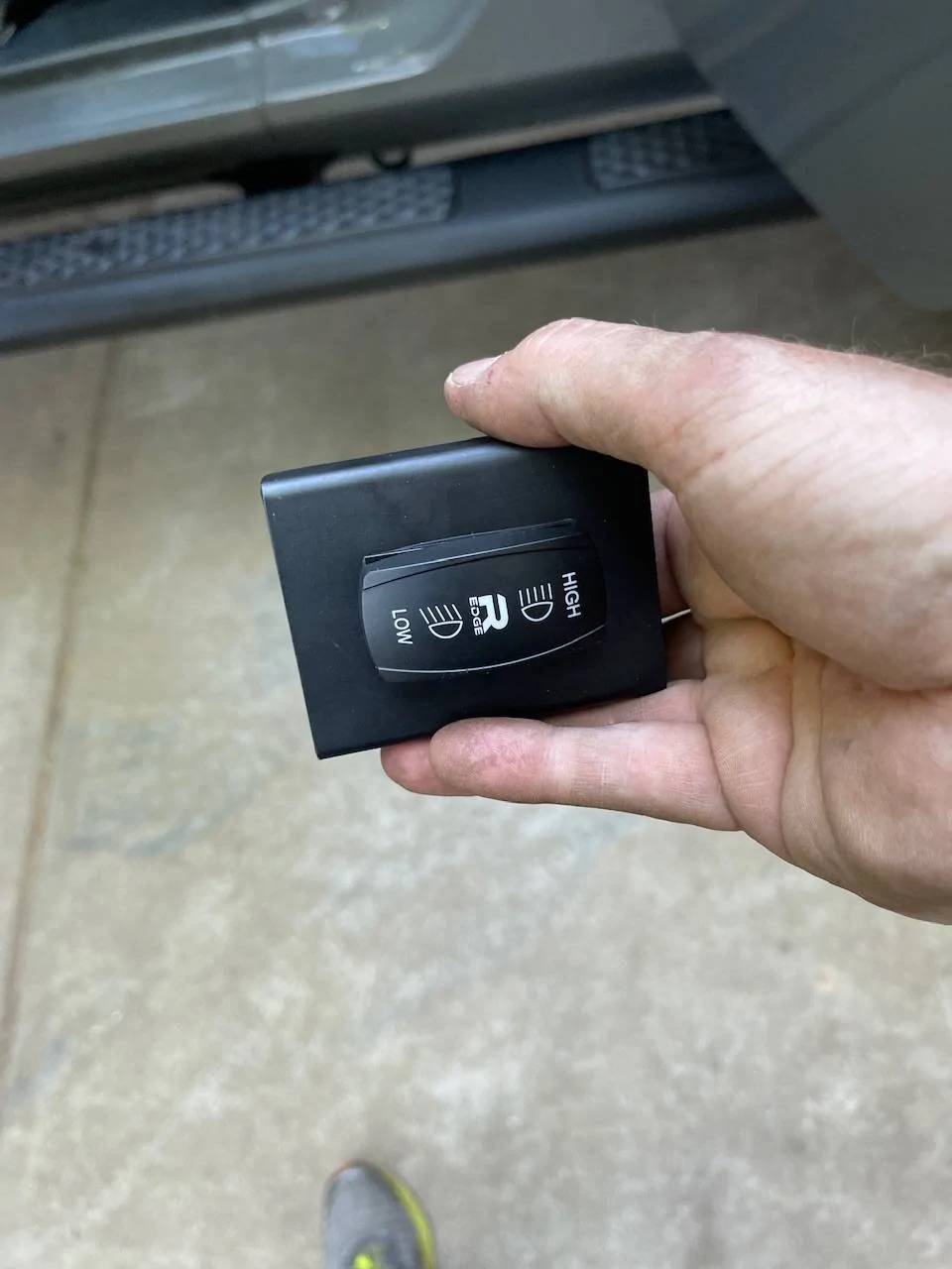

Nice work! I have no idea how to do this. lol I ordered a bracket to hide the rocker switch out of sight for if I ever do want to switch to the spot lights. Otherwise, it’ll stay on flood and be powered on and off with one of my Aux switches.
Jeep Gladiator Off road lights - what's everyone running? IMG_3656

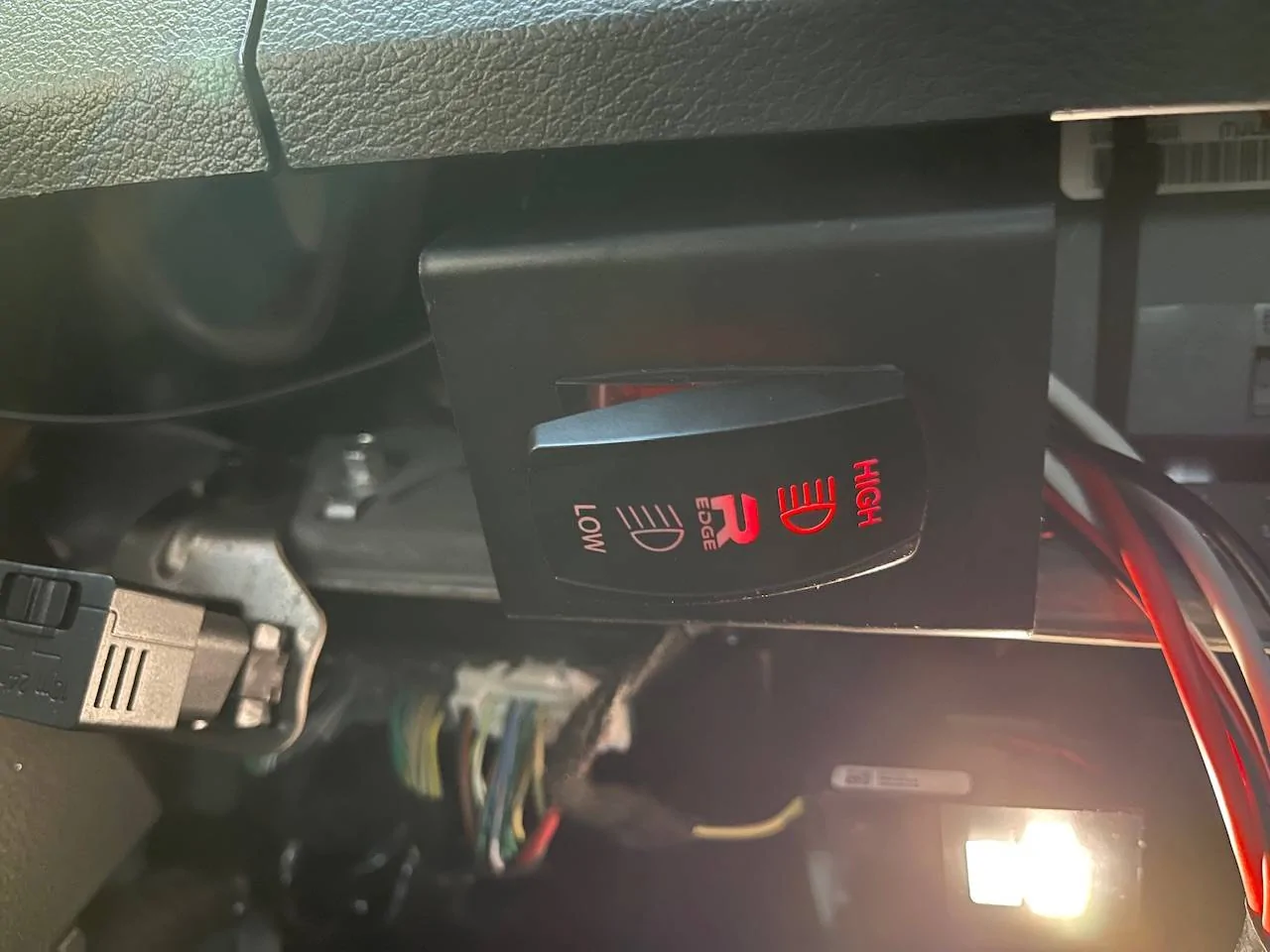

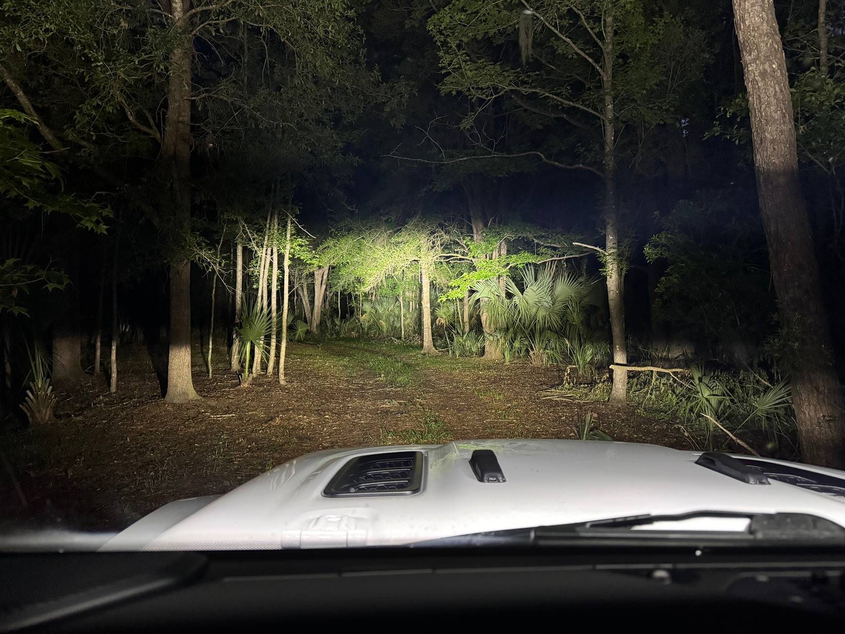

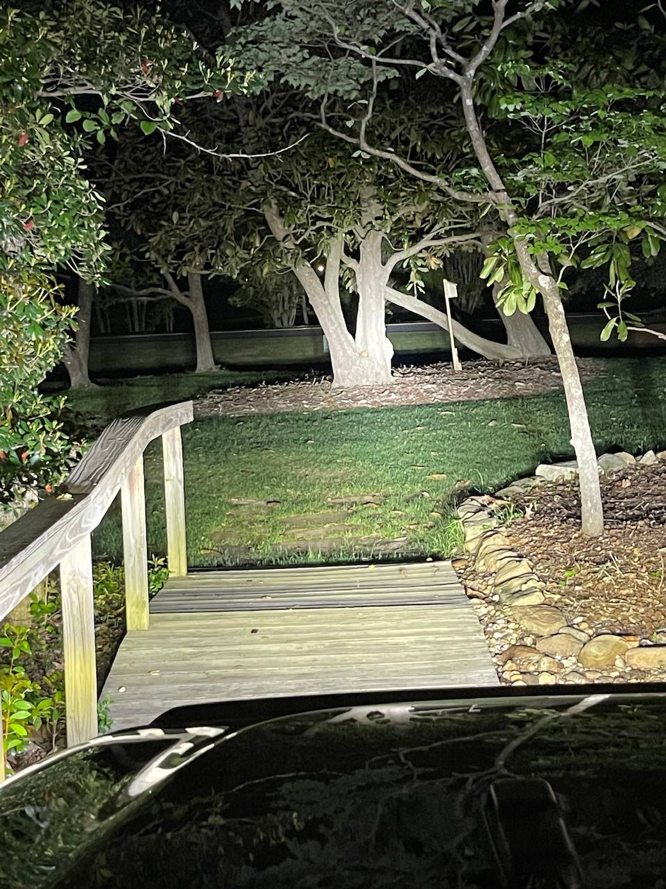

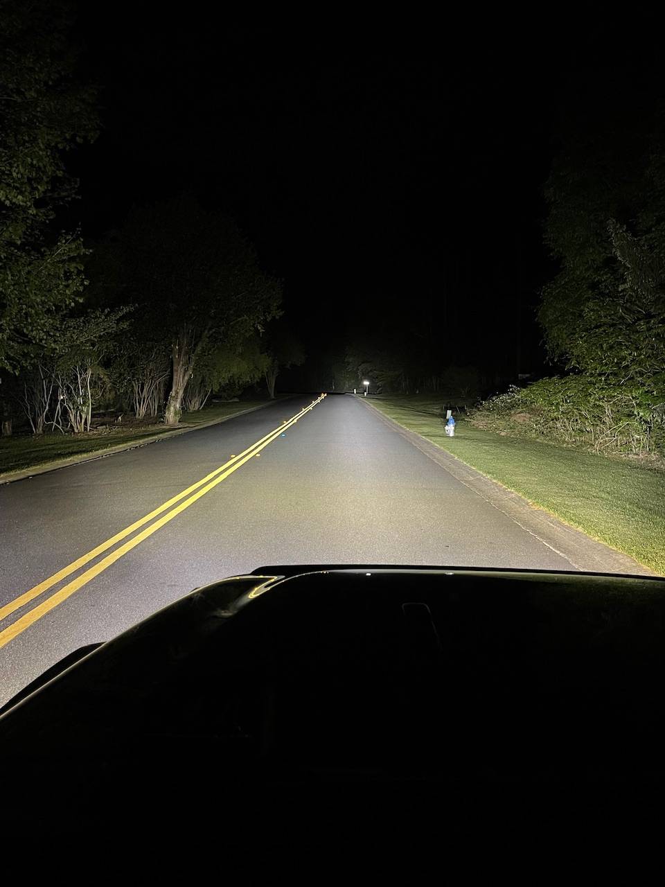

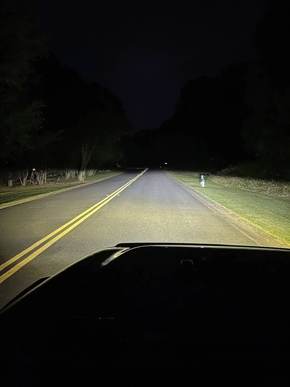

I never followed up with this. I got the 6” roadshock edge from harbor freight. I had a $130 credit and they were on sale. Their performance is great and it has a nice wiring harness so even if they crap out, I’ll just re-use the wiring. I hid the flood/spot rocker under the dash, but easily reachable. I’m very happy with the results.
