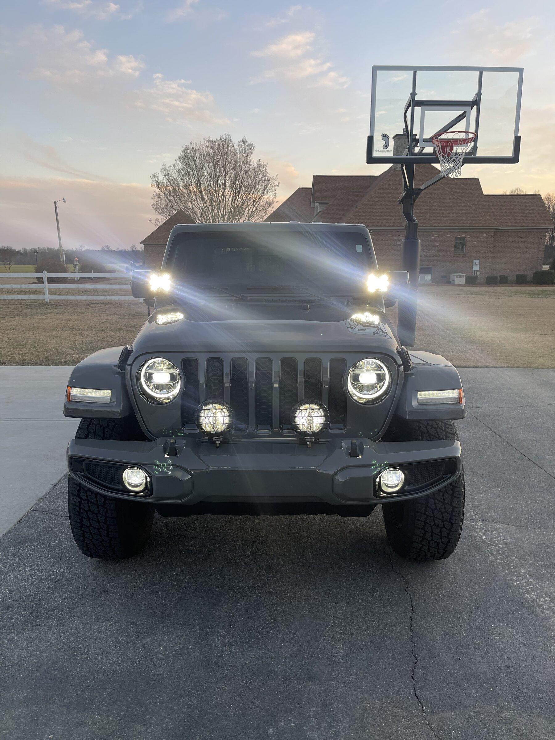

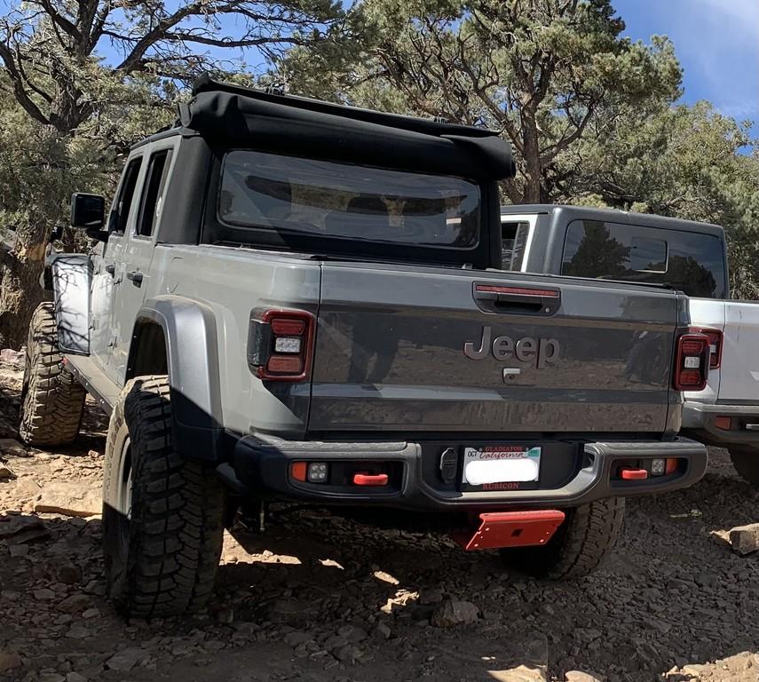

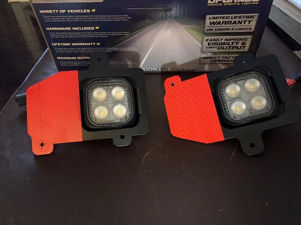

I have the big Mopar lights - pointed towards the side of the trail on a warn loop. These are a perfect complement to the LED headlights and fog lights. I am also running VisionX flood lights in the rear bumper (note: I added reflective tape to the mount). Both hooked up to my aux switches. I am very pleased with both.

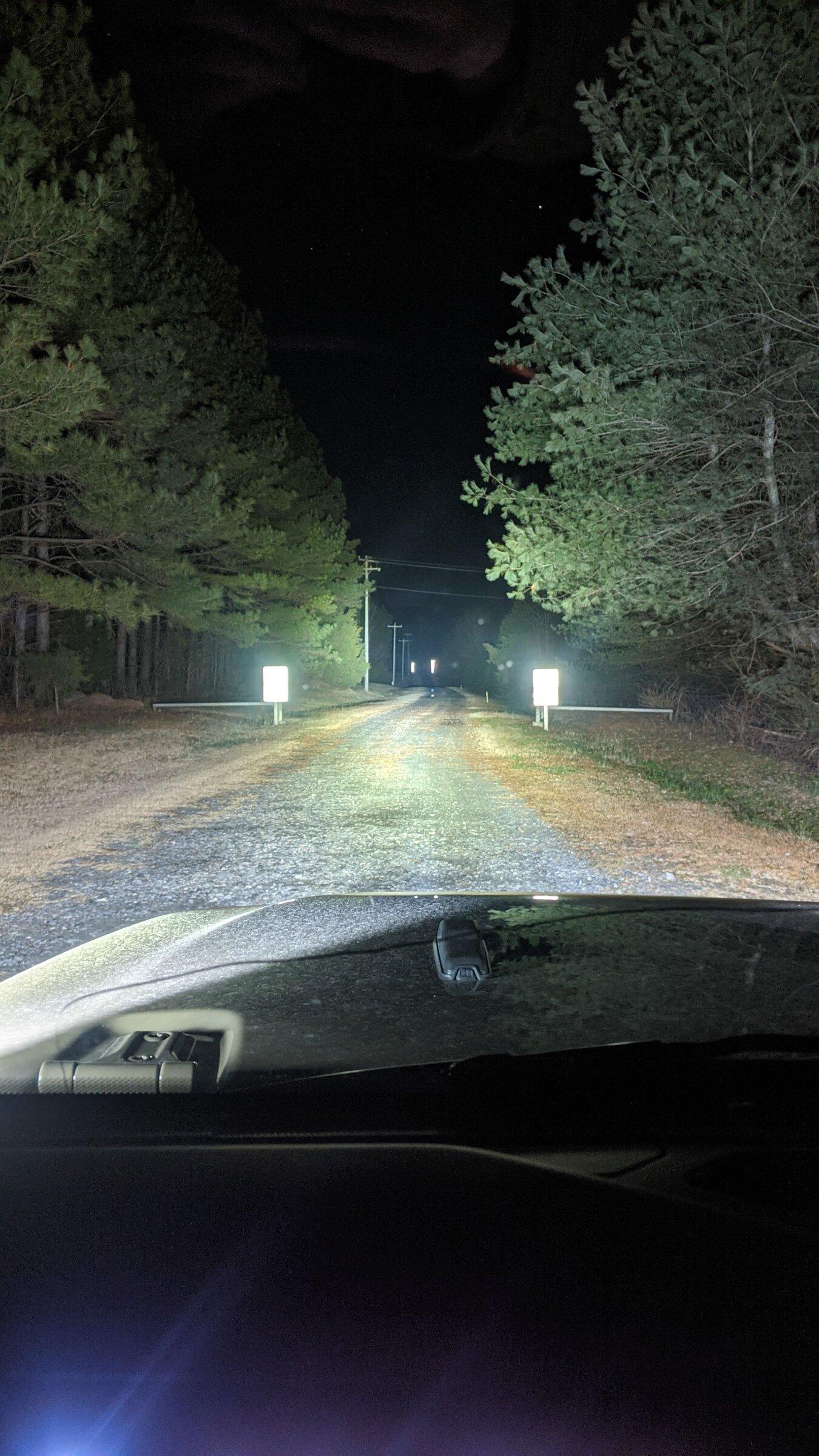

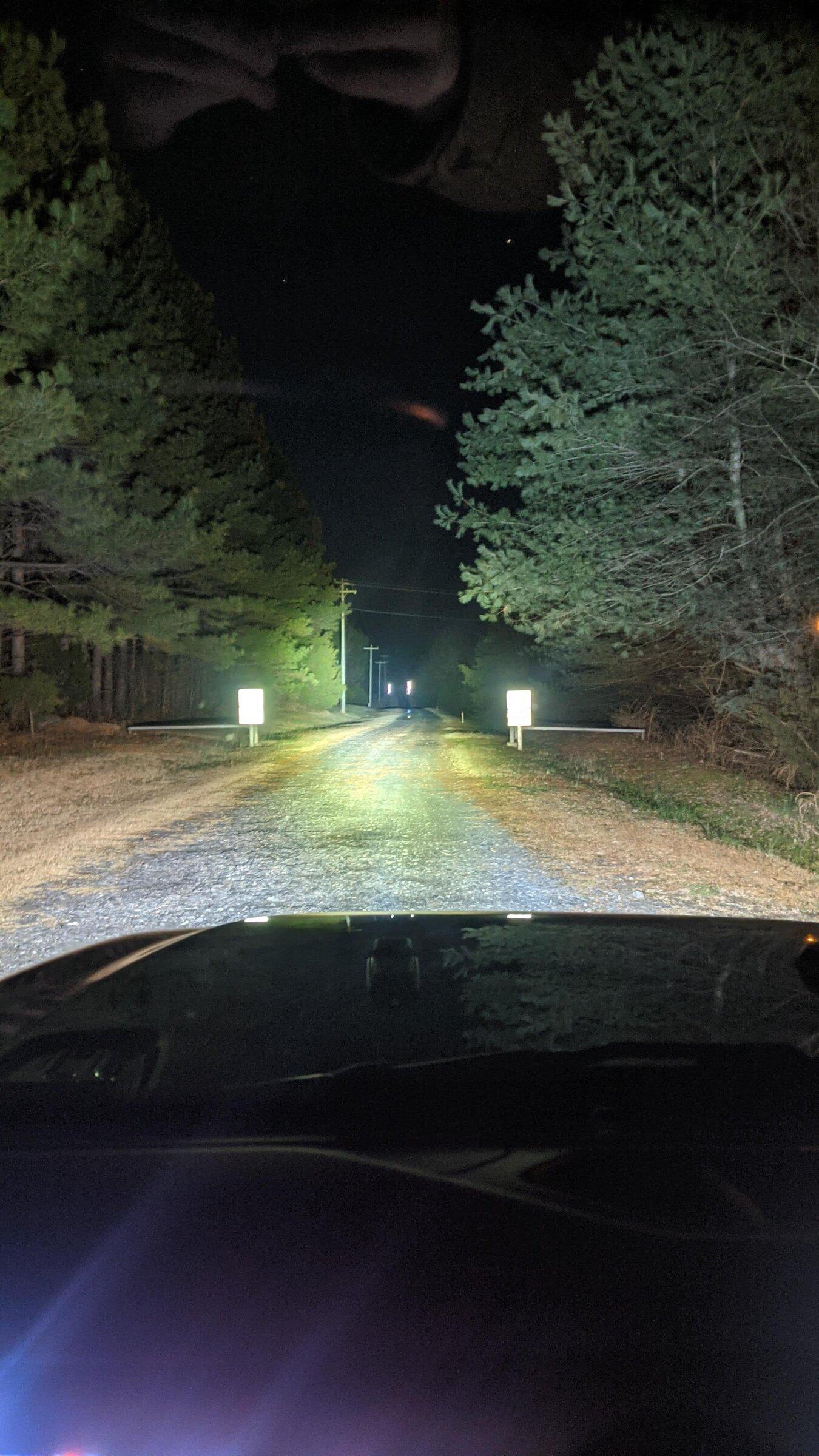

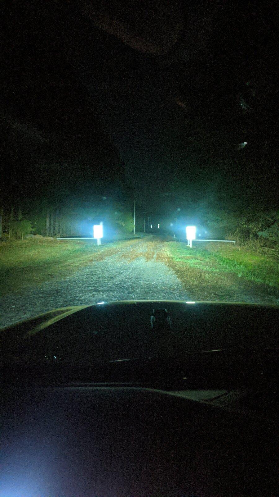

Loyo 4.5" cannons on the front in spot beam and Hella 3" lights on the A pillar in spot beam. Love the amount of light they give off and came in at under $150 for everything including the mounts for the A pillar.
Railroad tracks in the distance are .31 miles down the road, only know the distance because I run on this road at lunch time.

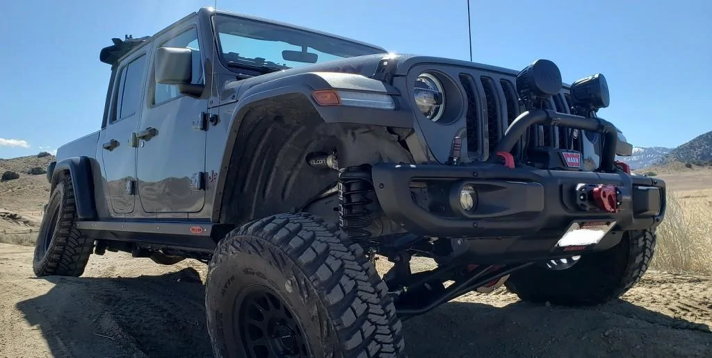

I have Baja Designs Squadron Pro’s in a combo pattern on the cowl slightly angled out for peripheral lighting and some extra down the road. They’re small enough to not notice but big on output. I also have the S1’s on the bed rack with a work light pattern. Loads of light for working on the gate, backing up, or hooking up a trailer. I bet these in a spot would be awesome to hide in little places they won’t get snagged. I’ve had other brands on other vehicles, but once I saw BD I don’t even look at other brands. I just wish they weren’t so expensive.

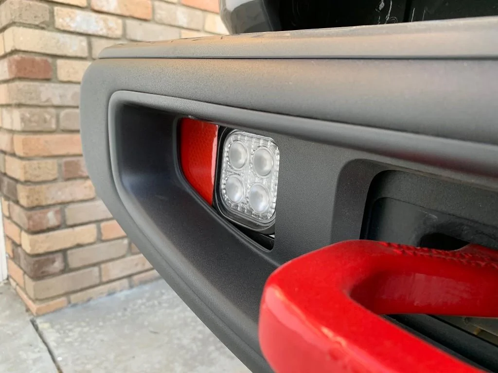

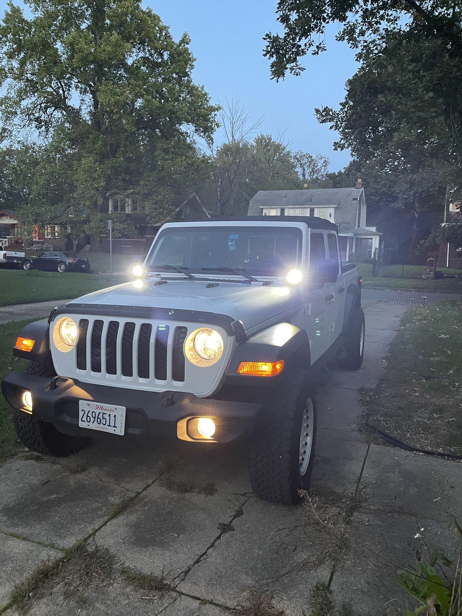

I had KC’s but one of my Flex chase lights inexplicably failed, and then the same happened with one of my G34’s ditch lights stopped working. After a lot of trouble shooting, decided to do a complete makeover. While I can afford it, and they don’t have the brand cache of KC, Baja, or Rigid….Diode Dynamics performance easily rivals those others at a fraction of the cost. Highly recommend them.

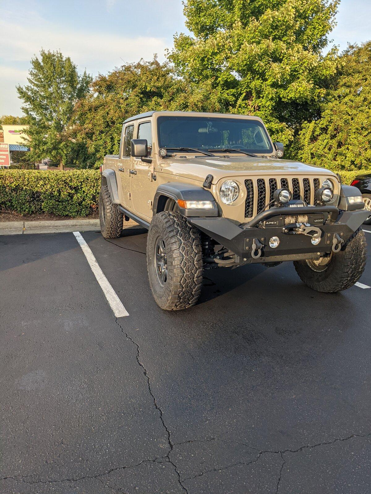

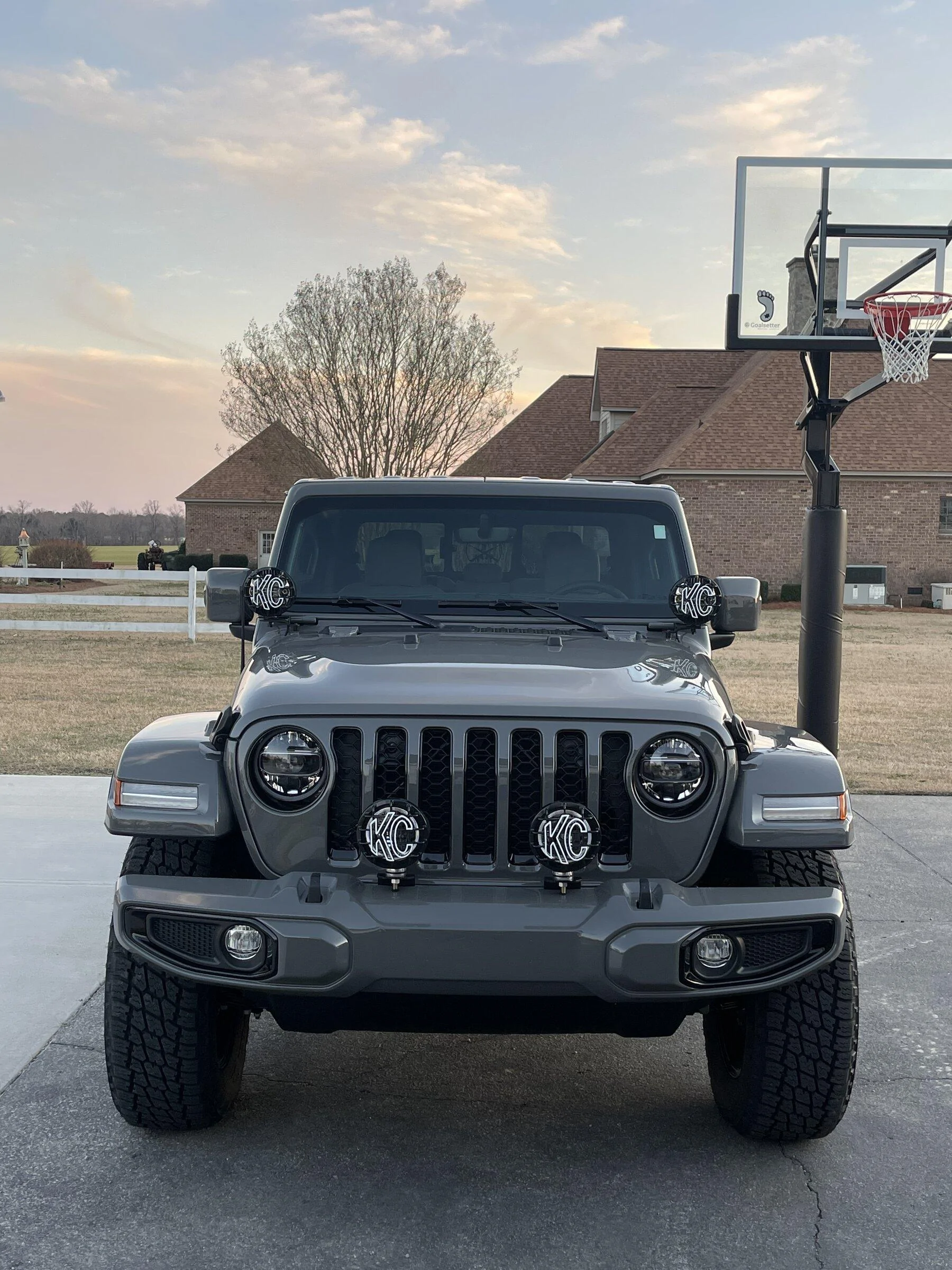

KC Flex Era 4’s on the bumper in combo spread/spot pattern. Amber lenses on them for snow driving. I remove the amber covers to expose the white with red rings for off road. Oracle reverse lights in the bumper. Very happy with the whole setup.

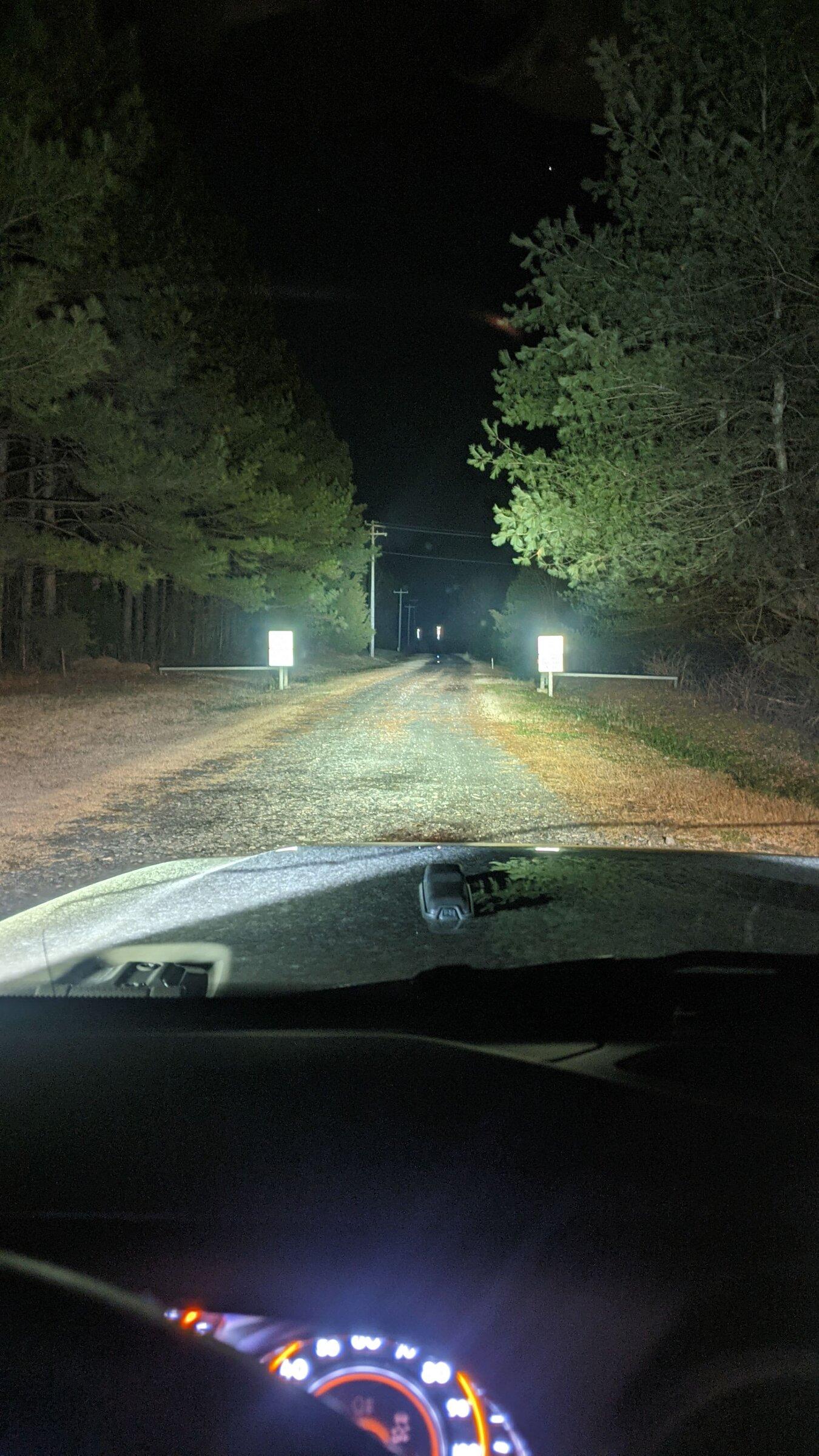

You ordered Flood pattern for the cowls, a flood pattern should be mounted below the hood to get the best results, lower to the ground. Spot or pencil beam patterns go above the hood. I used to sell lights and test them and from most vendors that's what they recommend. Depending on how you aim those floods will determine how much hood reflection you get from them.
I do have spot beams on my front bumper and spot beams on my coils though. I should of probably mounted a driving light on the bumper but I got the lights for free for the bumper from one of my old Manufacturers I used to buy lights from so I went ahead and mounted them to the bumper for now. The ones on my hood are Hella lights, I've been pleased with both. $50 for the lights and the brackets to mint them on the coil
Lights on the bumper
Jeep Gladiator Off road lights - what's everyone running? PXL_20210117_064146300.NIGHT
Lights on the cowl
Jeep Gladiator Off road lights - what's everyone running? PXL_20210117_064218113.NIGHT
All together
Jeep Gladiator Off road lights - what's everyone running? PXL_20210117_064246284.NIGHT

Honestly I've never heard of a lighting company suggesting flood lights above the hood and yes I feel like you'll get more Hood reflection from floods than from a spot beam for sure. Bad thing is it's hard to find a light bar that's either all flood or all spot I used to have to have them custom made like that they are normally a combo which is better served above the windshield.
I guess if you turn them more to the left and right it would take away some of the hood glare but you can see mine in the picture and even my spots have some Hood glare if those were floods it would be almost all the way across my hood in the front.
