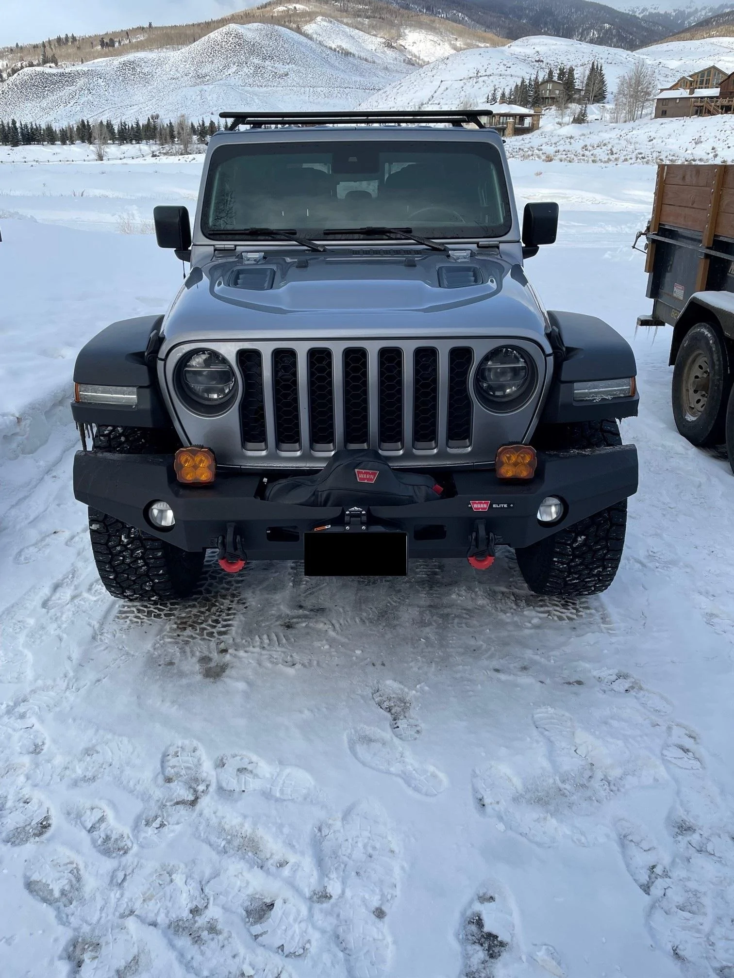

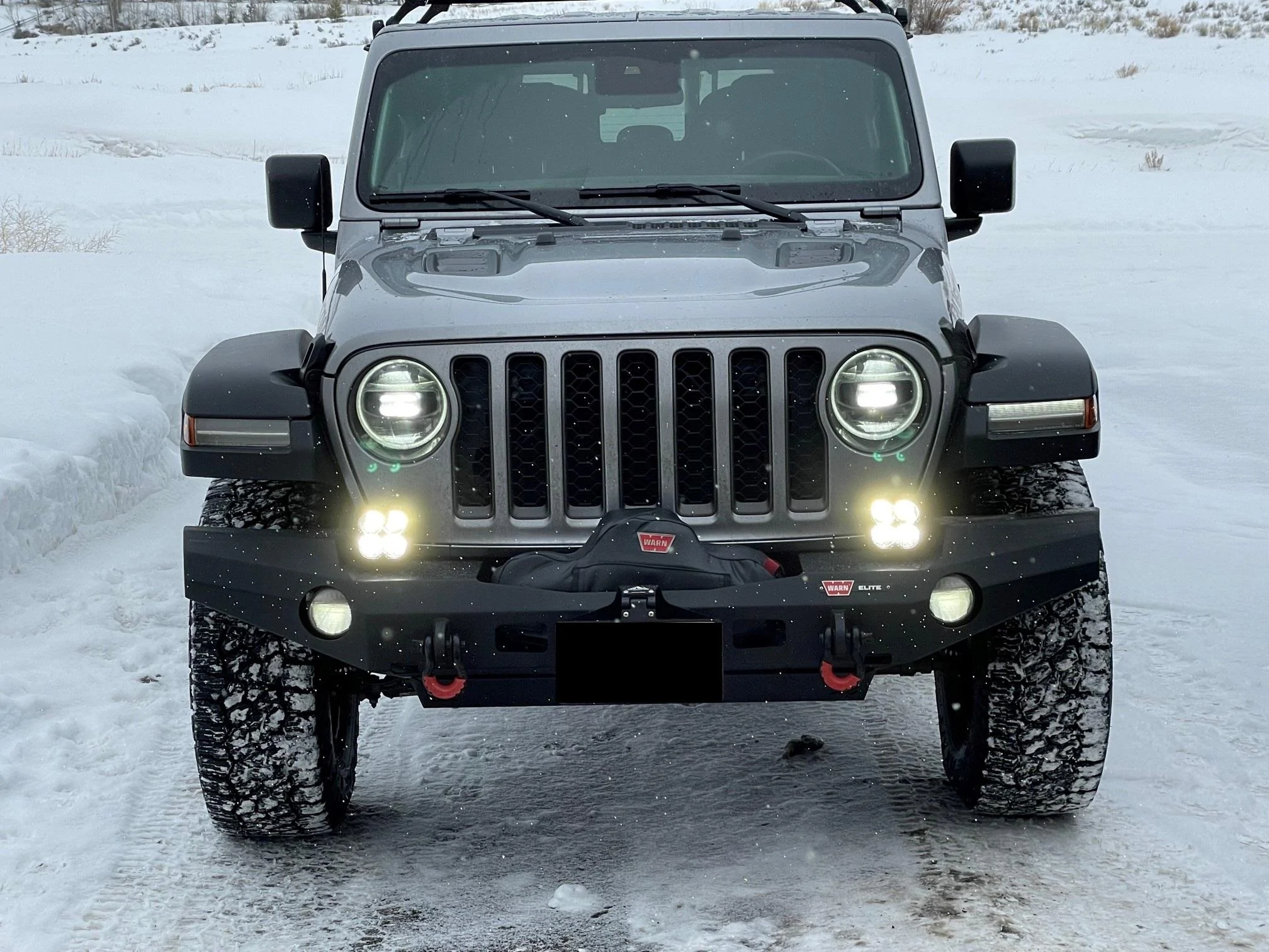

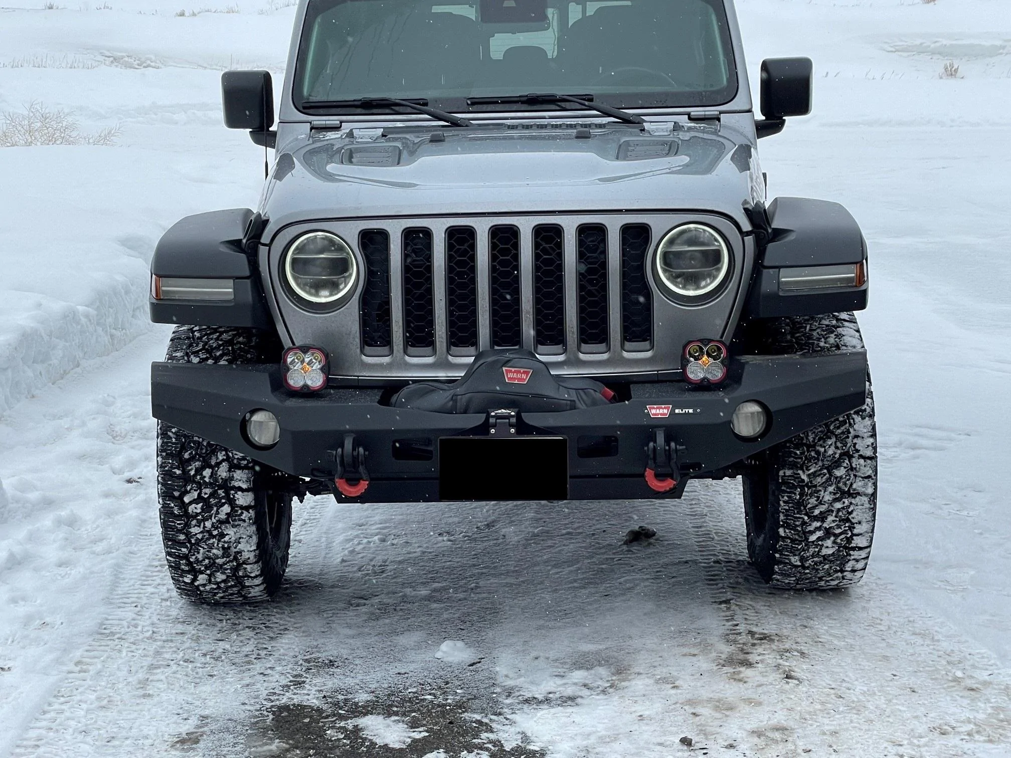

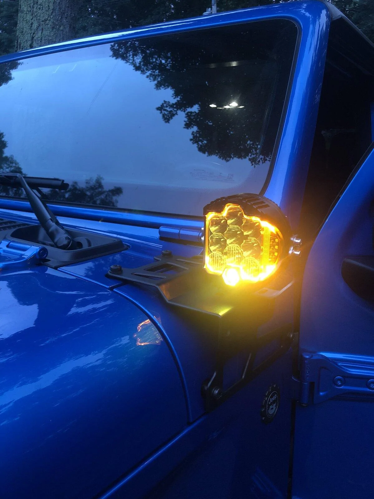

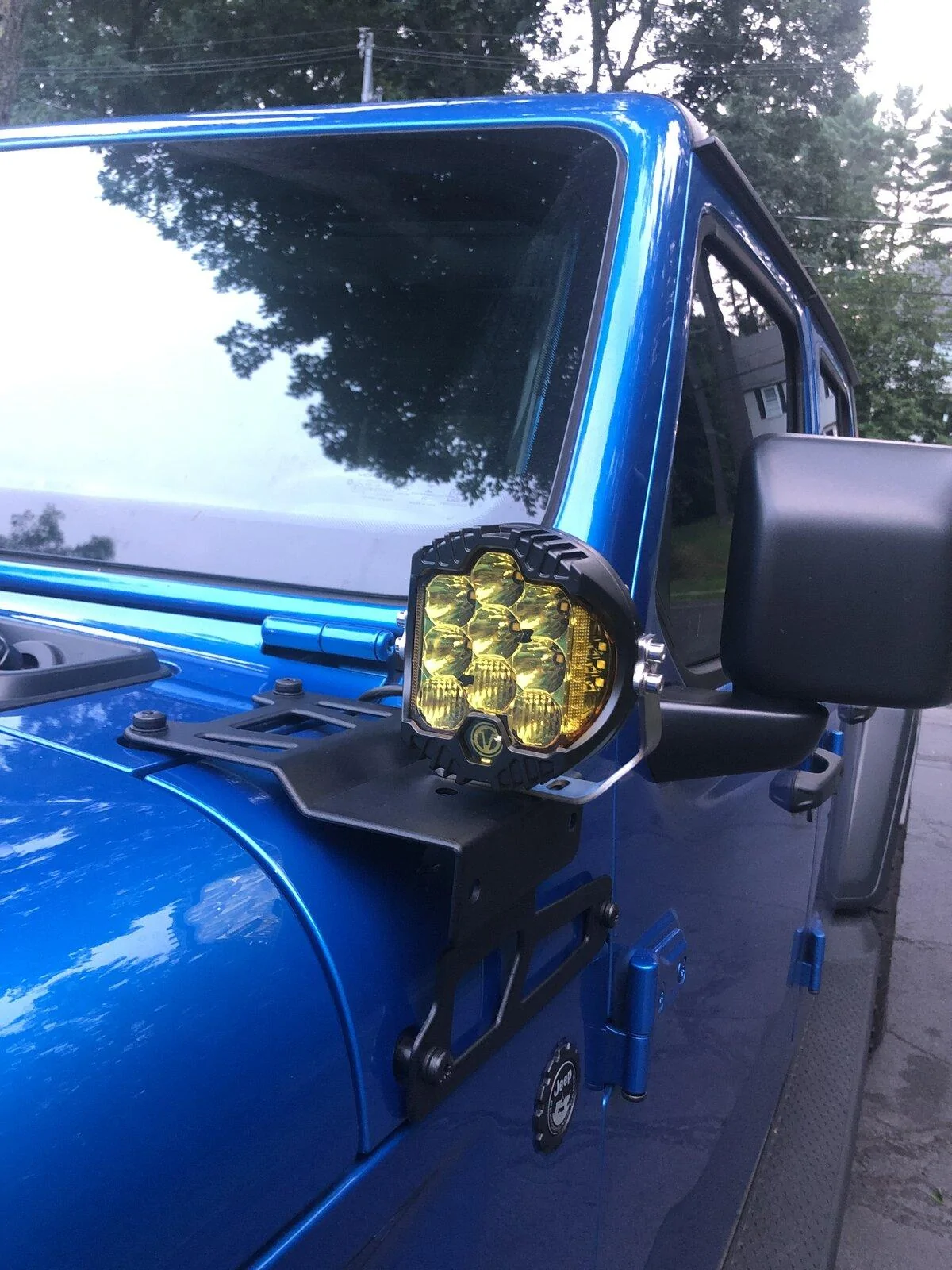

KC Flex Era 4’s on the bumper in combo spread/spot pattern. Amber lenses on them for snow driving. I remove the amber covers to expose the white with red rings for off road. Oracle reverse lights in the bumper. Very happy with the whole setup.
Update, just drove through my first mountain blizzard in the middle of the night since these KC’s were installed. They were amazing. Game changer.

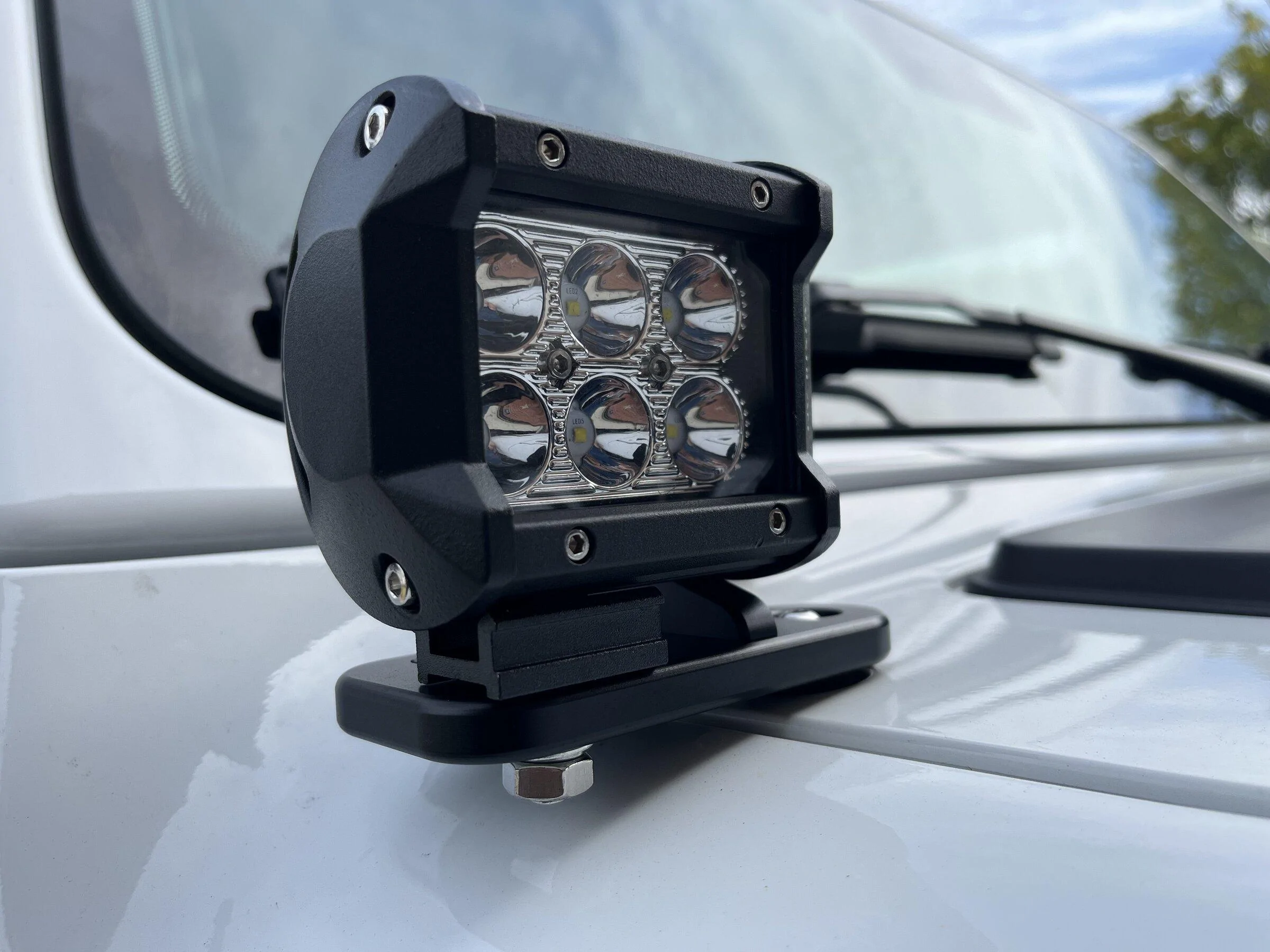

Some no name yellow spots on Mopar cowl mounts. They have a cool drl I have hooked up to one of my aux switches the main light uses another.
Who makes these?

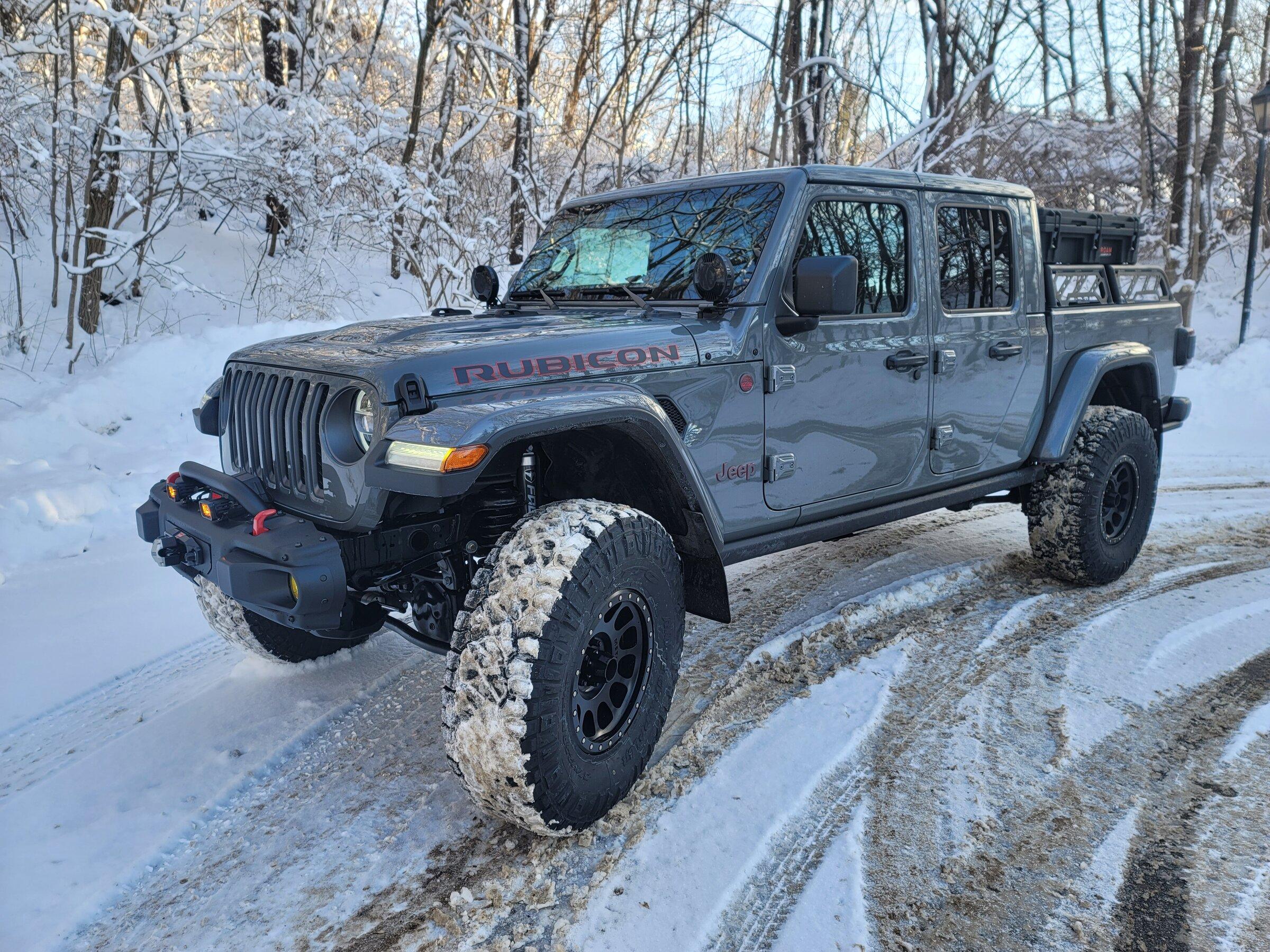

KC slimlites on the cowl, Diode Dynamics on the bumper. Planning to add more Diodes to the rack when I get motivated.

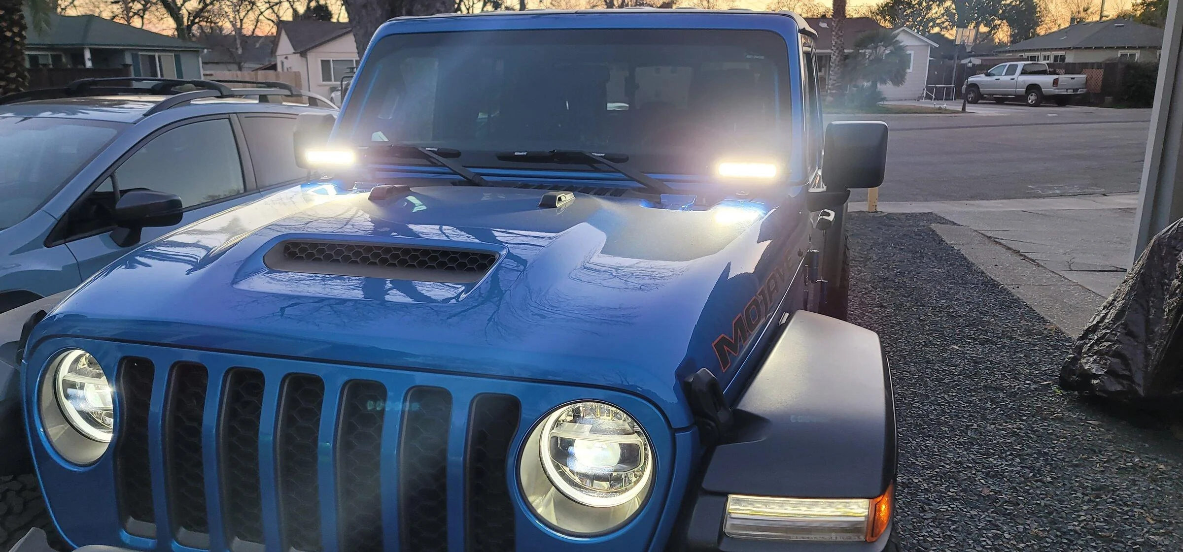

Honestly I've never heard of a lighting company suggesting flood lights above the hood and yes I feel like you'll get more Hood reflection from floods than from a spot beam for sure. Bad thing is it's hard to find a light bar that's either all flood or all spot I used to have to have them custom made like that they are normally a combo which is better served above the windshield.
I guess if you turn them more to the left and right it would take away some of the hood glare but you can see mine in the picture and even my spots have some Hood glare if those were floods it would be almost all the way across my hood in the front.
I just wanted to get back to your post and say that after mounting these I can definitely say you were 100% correct. The flood pattern was completely wrong for the cowl mount. I just switched to wide beam/fog lenses and it’s much better as far as glare goes. I also ordered the driving lenses to try out as well. Just wanted to thank you for your post. ?
No problem boss, glad to offer the help and input

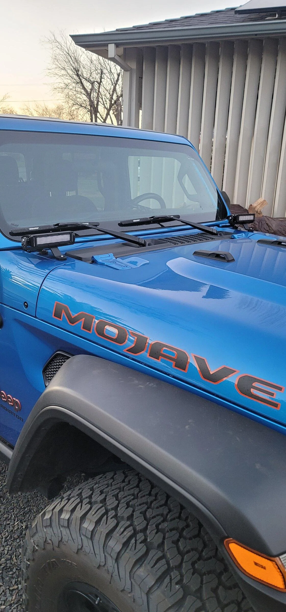

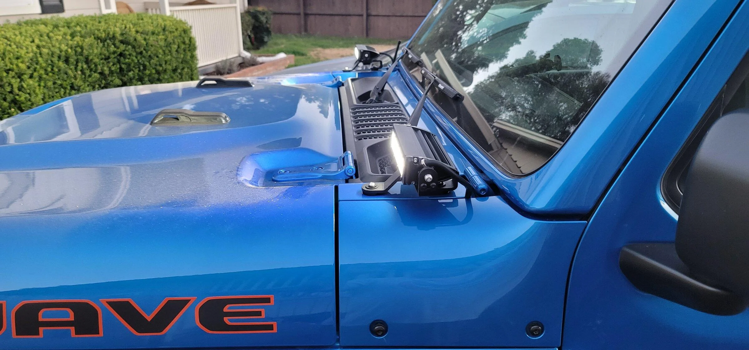

Flood was a bad choice so I switched to the wide/fog lenses which I like so far. I also ordered the driving lenses as well. If you use the same mounts just know that the design of the DD bars is a little narrow for the mount. I just shimmed each side with some flat washers to fill the gap. I also bought some m6x 20mm buttonhead bolts to use. I think the GoRhino mounts are designed to work with the Rigid bars which are a little different.
