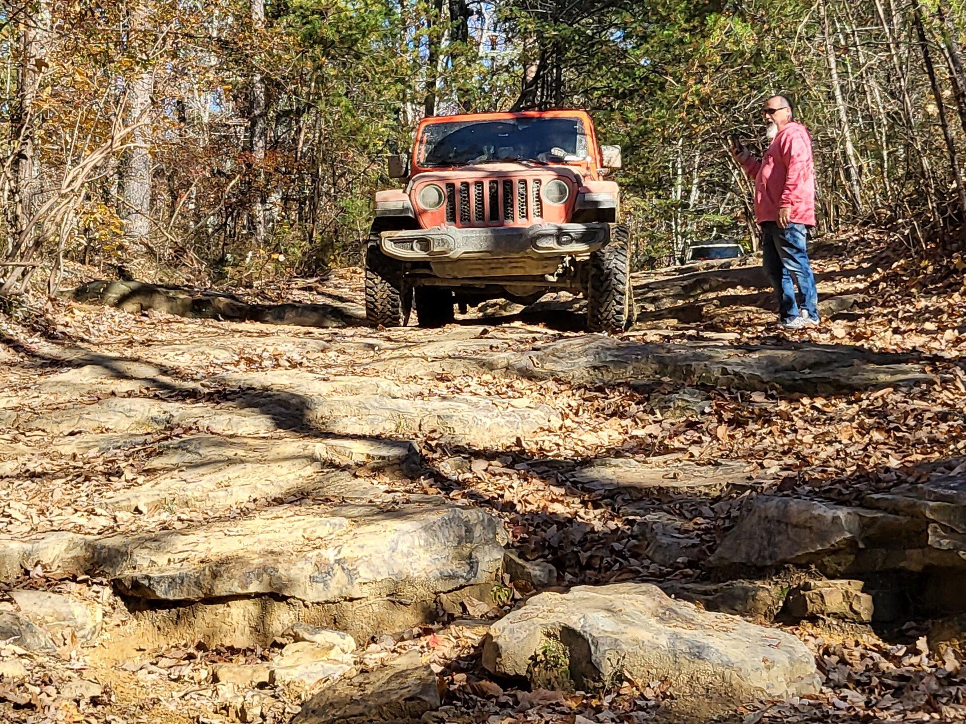

I just went on an all day offroading trip in the Tennessee Mountains.
Not a single locker was engaged on the trip in our caravan. Including the rock shelf obstacles.
OP, what you need is clearance and bigger tires.
We do not allow stock Gladiators including stock Rubicons on these trips because of clearance.
Minimum of a 2.5" lift and 35s are needed for any real offroading. Someone is going to say, I did so and so trail stock. Great, good for you. In my area (Tennessee, Alabama, Georgia) a stock truck would get damaged.
I'll never go rock crawling in my Gladiator. It's really big. To do legit rock crawling and not worry about damage, I'd want Dana 60s or 80s on 40" tires. By then the factory lockers would be left in the stock axles anyways.
Jeep Gladiator Off Road question 20211113_142852
Pictures always flatten out the elevation.
I skipped this obstacle even though I have a 2.5" lift on 35s. Everyone else in my group had 37s and at least a 2.5" lift. Most had 3.5-4".
They had an easy time on the trip. I had to be much more careful and still scraped a few times.
I'm not discounting lockers at all. This is actually the first 4x4 that doesn't at least have a rear locker for me.
It's just for my use case, I don't need lockers. But I have a winch and recovery gear for when that statement comes to bite me in the ass.

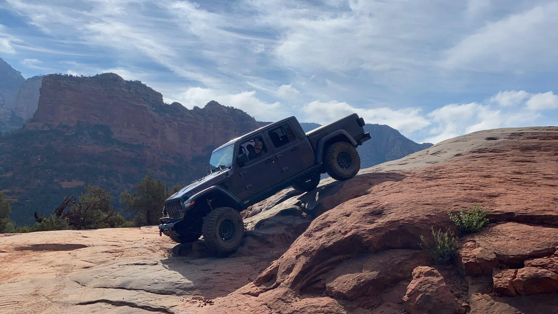

While some will disagree with me, but lockers should only be a last resort. My wife and I attended an event in Moab held by a very reputable survival/recovery team. They taught us to rely on your ability and not what may or may not have available through your equipment. Equipment fails.
One thing they did teach us was the “2 footed” approach to getting traction. If you use both the brake pedal and the gas you in essence will have “lockers”. You trick the computer to sending power to all wheels instead of just the wheel the computer “feels” has most traction.
Neither the wife nor I have grabbed our lockers since that class. Now mind you, we are not doing level 9/10 stuff, but we are crawling through areas where other Jeepers are using lockers.
Your vehicle is more capable than most will be comfortable in doing. Just be smart in your decisions. Know to the best of your ability of what lies ahead and plan.
Pic is some stuff the wifey was wheeling in her JL ....she hasn’t grabbed a locker since she bought her Chief.
