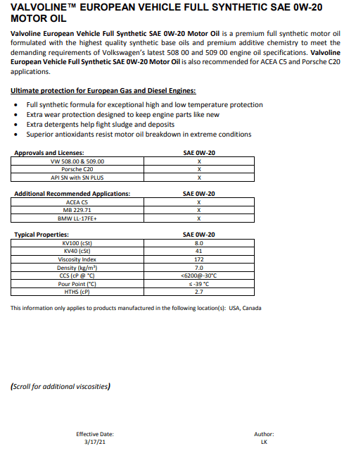

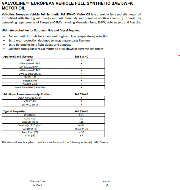

Like most I am a bit surprised by the incredibly specific non-diesel engine oil this requires. But since I'm changing my own oil and these engines are still very young I'm not going to stray at all from a verified, well-documented path of compliance in case a warranty issue arises.
Which brings me to my question. This list says Valvoline Full Synth Euro Car 5w-40 meets the Chrysler MS-12991 spec. This is appealing because you can get 5qt jugs of it for cheaper than the single qts volumetric price of everything else. But looking at pictures of the back of the physical bottle does not reveal the listed spec. Given that product images can be out of date, I went here:
https://www.valvoline.com/our-products/motor-oil/european-vehicle-full-synthetic-motor-oil
downloaded the product information sheet and pasted below. Nothing. Notice the effective date at the bottom, 2 days ago.
Can someone prove otherwise? If so that would be great. If not this oil should be pulled from the list in the first post.

Which brings me to my question. This list says Valvoline Full Synth Euro Car 5w-40 meets the Chrysler MS-12991 spec. But looking at pictures of the back of the physical bottle does not reveal the listed spec.
You will have to call Valvoline. Their tech department confirmed it met the MS-12991 spec. It's possible that Valvoline didn't want to pay for the certification, at least not this early in the game.
I think I was the first guy to run Valvoline in the Gen 3 EcoDiesel. But, I was buying it when it was still labeled under the MST name, and it had the MS-12991 stamp on the bottle.
Shortly afterward, Valvoline started to change the branding on that oil. It went from "MST" to "European Vehicle". When that happened, the MS-12991 certification was also removed from the label. I contacted Valvoline myself and asked if the oil still met the cert that I needed. They told me that it does, and that they are working to update their product data sheets.
Well, several months have now passed and they haven't ever done so. In fact, another member said that when he contacted Valvoline to inquire about the status of this recently, they told him that they aren't going to spec the European Vehicle bottles for MS-12991.
Does this mean that it's not an acceptable oil? Absolutely not. It's the correct viscosity and the correct API category. You can certainly use it and the owners manual states that you can. However, if you are concerned about the *recommendation* for MS-12991 oils, then you need to look elsewhere.
