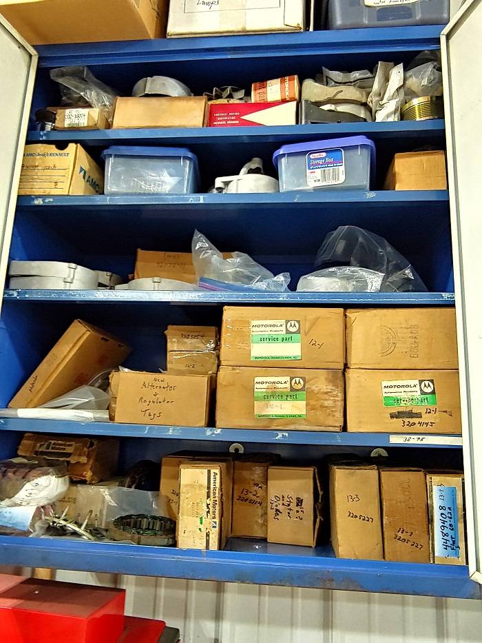

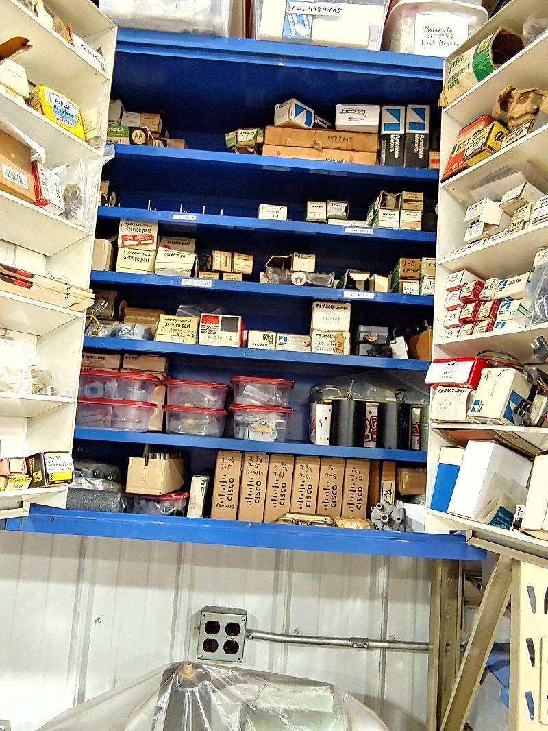

"Follow the damned book" is hilarious from someone who makes their money rebuilding old parts to be new again with parts that are not from "the damned book".
Really? Looks like genuine OEM replacement parts to me.
I've spent thousands to be able to duplicate the original plating and other finishes.
Now you're reaching.
Can't see how restoration has any connection with using what's recommended in the owners manual for a new vehicle. How does it compare? In 50 years you won't be able to get original parts for the JT very easily so let's compare apples to apples. Restoration of antiques for which you can't get parts (and yet - I have 'em) or for a new vehicle for which parts are freely available. Quite a stretch comparing the two, isn't it?
I have original New Old Stock (NOS) parts for Motorola, Prestolite., AMC and others.
I use factory style crimps on direct factory style replacement terminals on the wires.
(this is a tiny fraction of the parts I have)

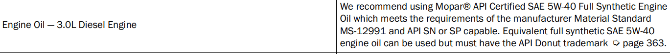

Owner's manual page 393:
" We recommend you use 5W-40 synthetic engine oil such as Mopar® that meets the manufacturer Material Standard MS-12991 and the API SN engine oil category is required. "
