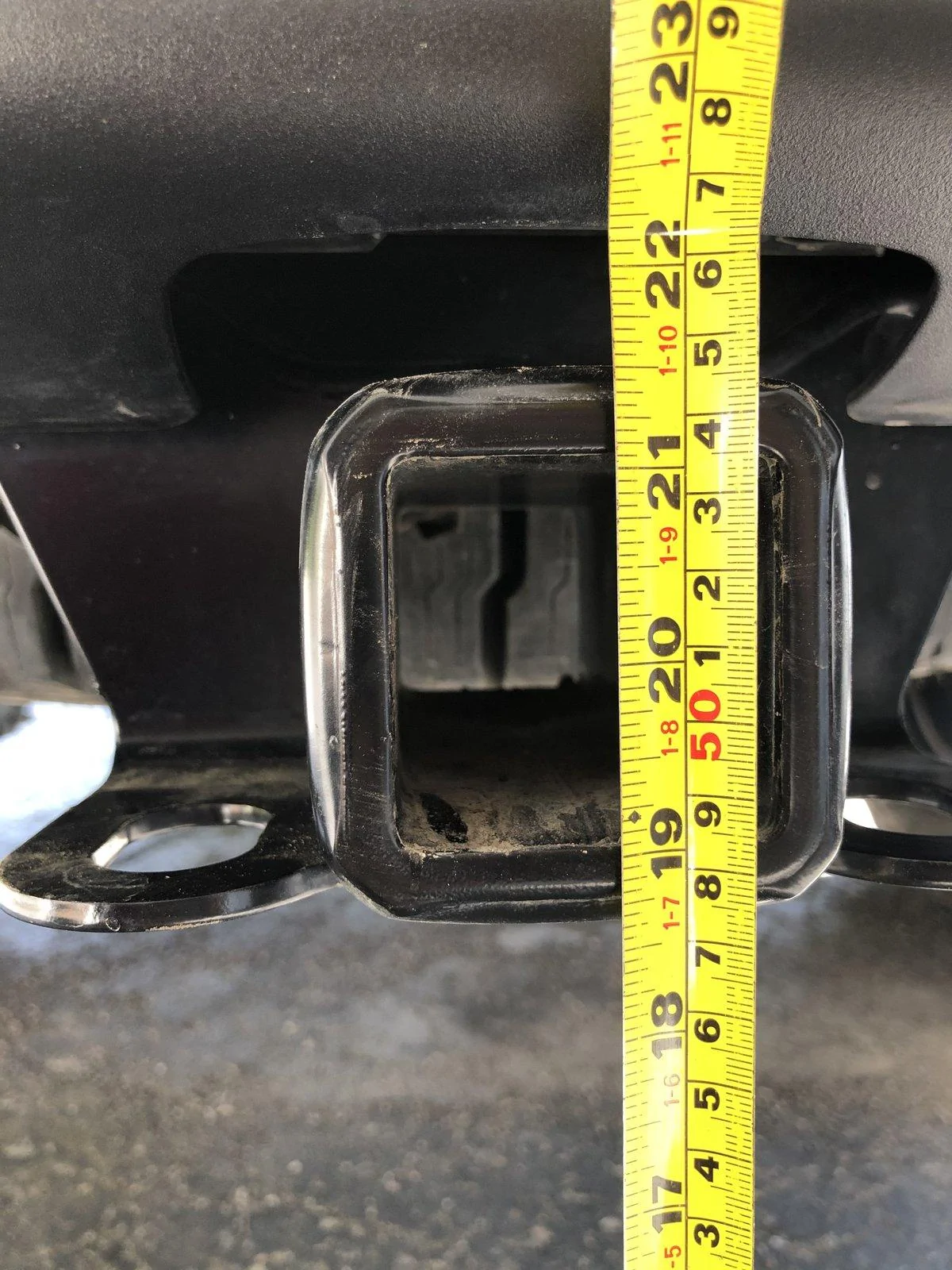

How high is the hitch receiver off the ground?
The bottom of the hitch would be sitting exactly at 19” from the ground inside of the receiver on my stock Jeep Gladiator Rubicon Launch Edition (and the bed free of any cargo weight!!!)
The bottom of the receiver is 18 ⅝” high off the ground, just a little above the spare tire bottom.
What's the height on a stock sport s?
