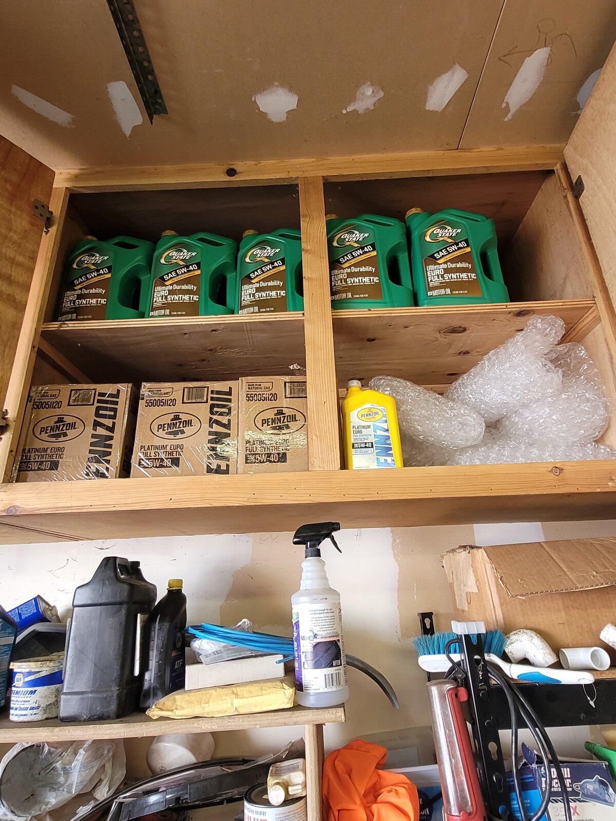

Never wait if you find it. 3 deep and got 5 more on the way.
And I got it all at my local Walmart except the last 5. For some reason they are shipping it from back east 🤷‍♂️🤷‍♂️
