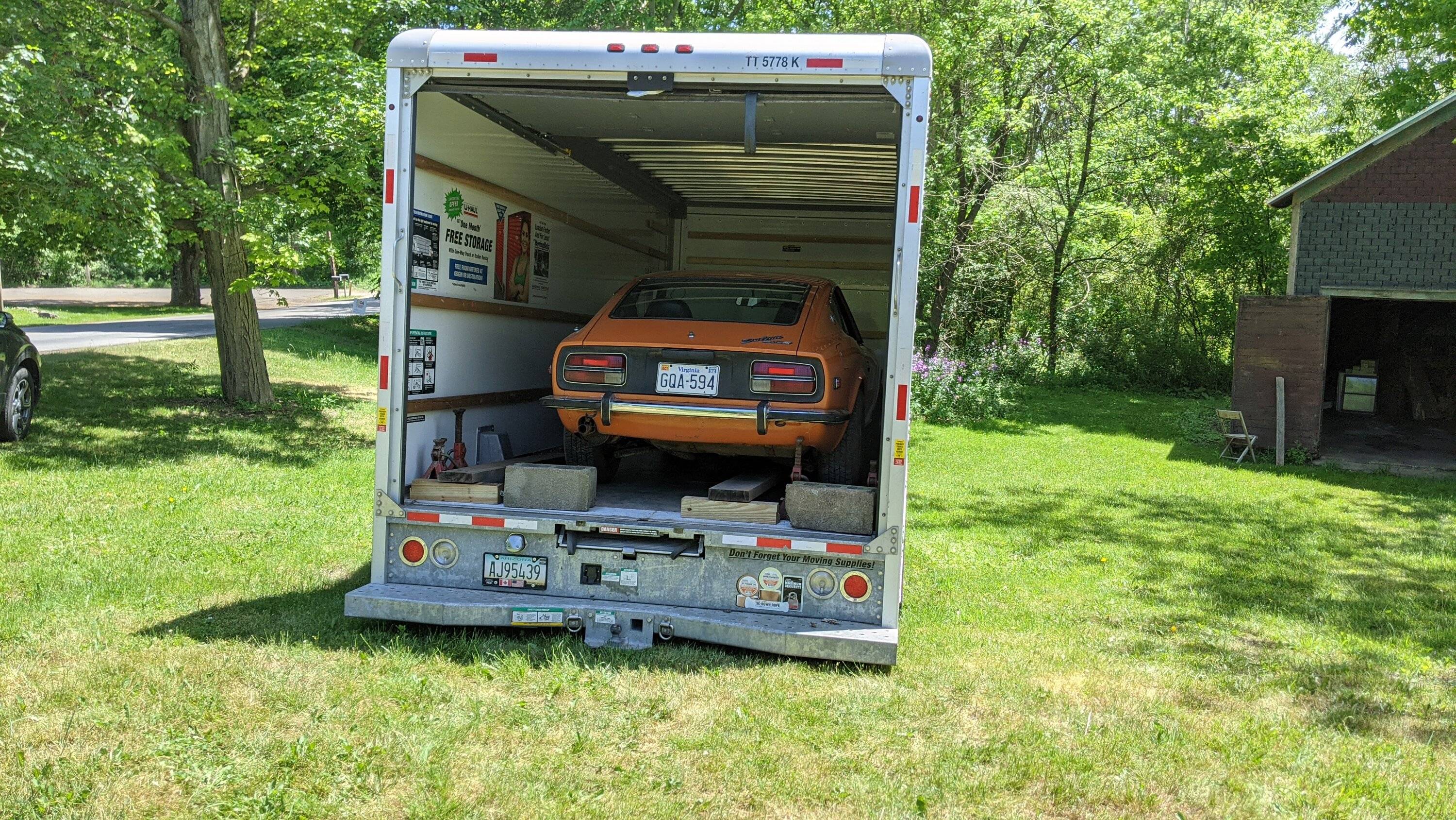

lol this is more my style! My last sketchy load was rolling the z car down a hill into the back of a uhaul using some oak planks and jack stands I found in the shed ?
That's a clean looking Z for Virginia humidity!

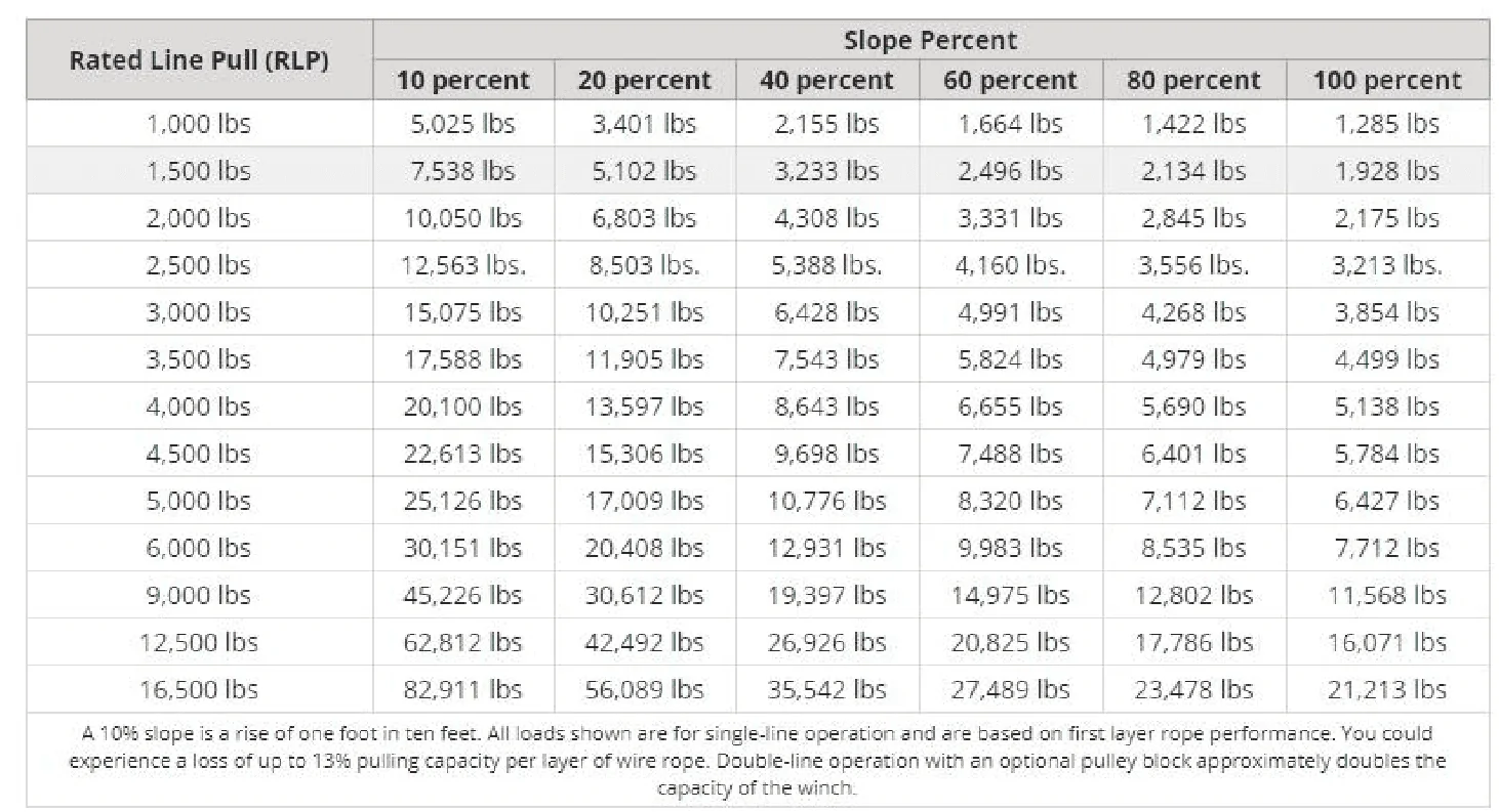

I've done some reading and research into how much effort it takes to pull a car up an incline like trailer ramps or even a tilt bed trailer and honestly, even a 2500 pound winch is more than enough - most figure at a 10% incline a 2500 pound winch could pull a rolling load of over 10,000 pounds.

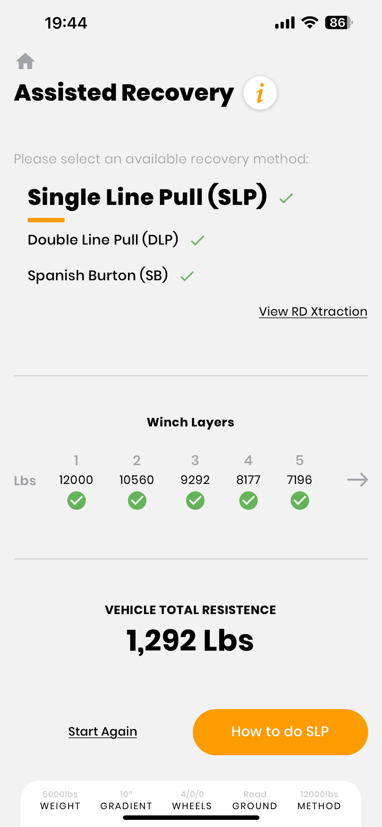

With a 12K winch you have more than enough capacity. Safe-x-tract has a cool little app to calculate loads based on varying terrain and vehicle damage and status. Assuming a 5,000 pound car the resistance would be 1,292 pounds. As others have mentioned I think the biggest concern would adding a sleeve or two to avoid damaging the synthetic line.

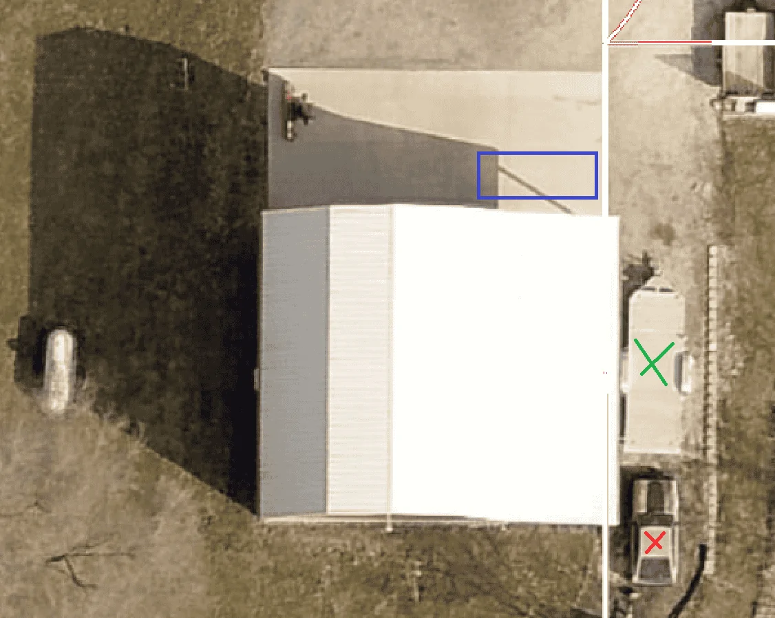

I'm thinking more that I like the idea of at least with this car, which should roll easily (funny thing, the car has been sitting by my shop for 5 years and when I went to air the tires up, each had over 20 psi in them!) so in this case, I'll move my trailer out of the way, pull the car ahead several feet with my truck so I can pull my truck off to the side if the front of their trailer and pull the car on - easy as it shouldn't take more than about 1500 pounds or so of pull.
My trailer will move - green X
The car is the one with the red X on the roof
I'll put my truck where the blue box is facing east (to the right) and they can back up to the car.
Should work fine.
Was worth asking as got good ideas and can use the sleeves if necessary to protect the rope at the back end of the trailer if it rubs on the trailer in any place.
Property line is where that wall or row of blocks is that prevents a huge wall of water coming at my shop in event of a heavy rain. So I've got to do all of this to the left of that block wall.
It's loose gravel on the right of my shops concrete approach and starting at that corner of the concrete, the gravel goes up sharply - meaning it's all up hill loose gravel in that area.
It looks flat from the air, but far from it.
Thanks all - it will save a ton of messing around and make loading that car really easy.
