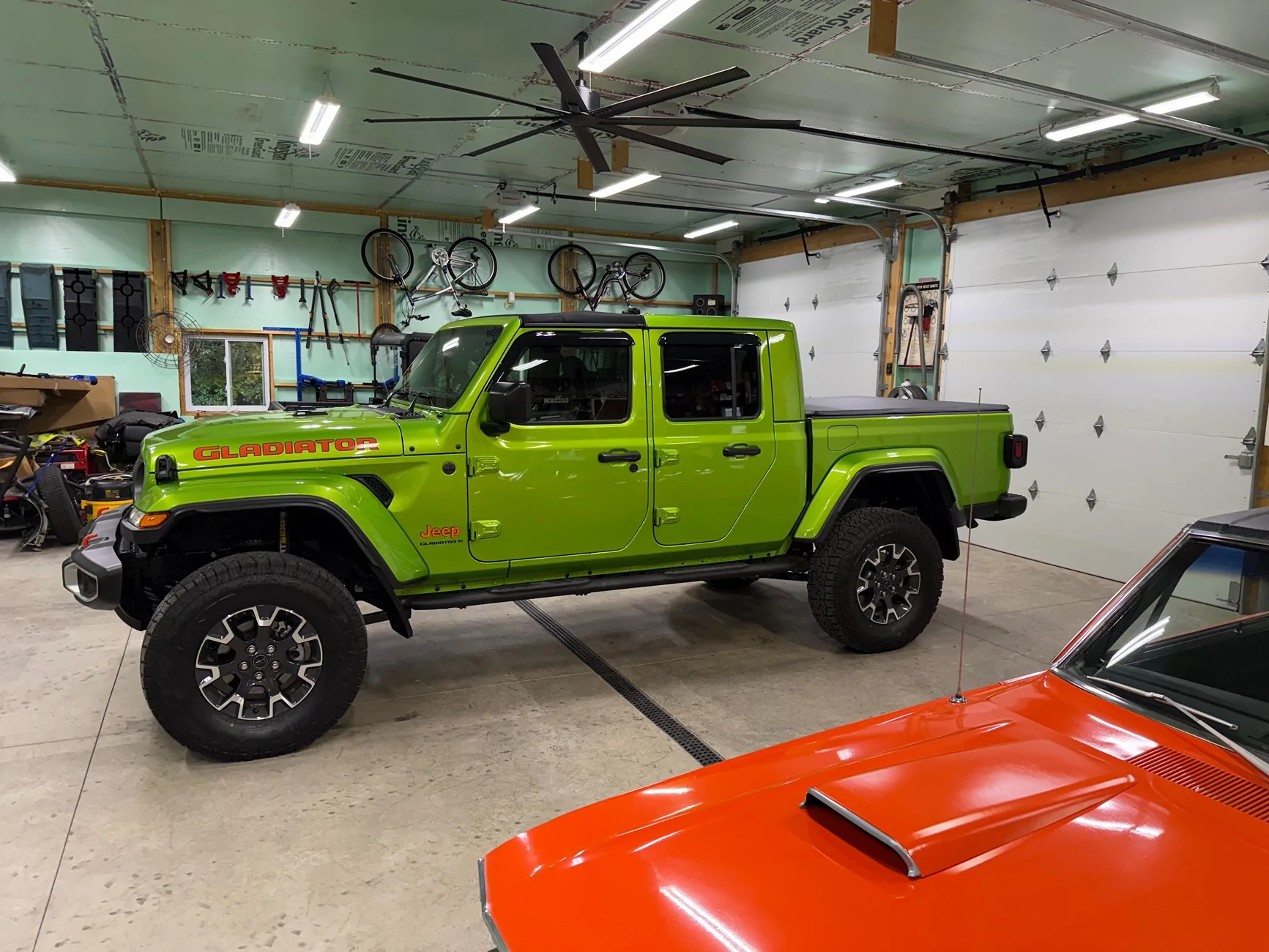

I just installed the AEV 3” dual sport lift with there geometry correction brackets and billstein 5100 shocks, I netted about 4” of lift, I did add a TeraFlex front adjustable track bar to it .
That looks really sharp the way it sits

Thank you, that’s sitting on 35’s by the way

It rides like a 3/4 ton truck right now, but I will start adding the camper, and steel bumpers and winch

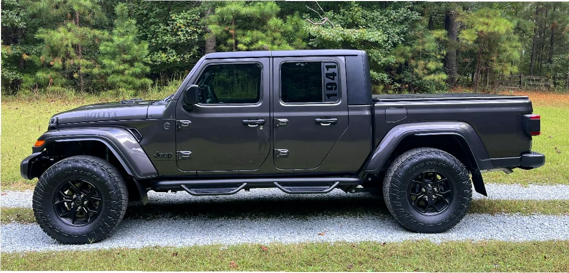

I installed the teraflex 2.5 sport st2 lift. I also added lower adjustable lower control arms, adjustable track bar with bilstein 5100 shocks. Toyo at3 35x11.5x17 (factory rims) the tires did rub the lower control arms. Adjusting the steering stop bolt kept the tires from rubbing but I installed 1.75 synergy spacers so I could have full turn. Down the road will add new wheels with the correct backspacing. 95% of driving is Hwy and for looks. The truck drives great with this setup.
That’s a perfect look, that’s how I want to be set up, thanks for the info

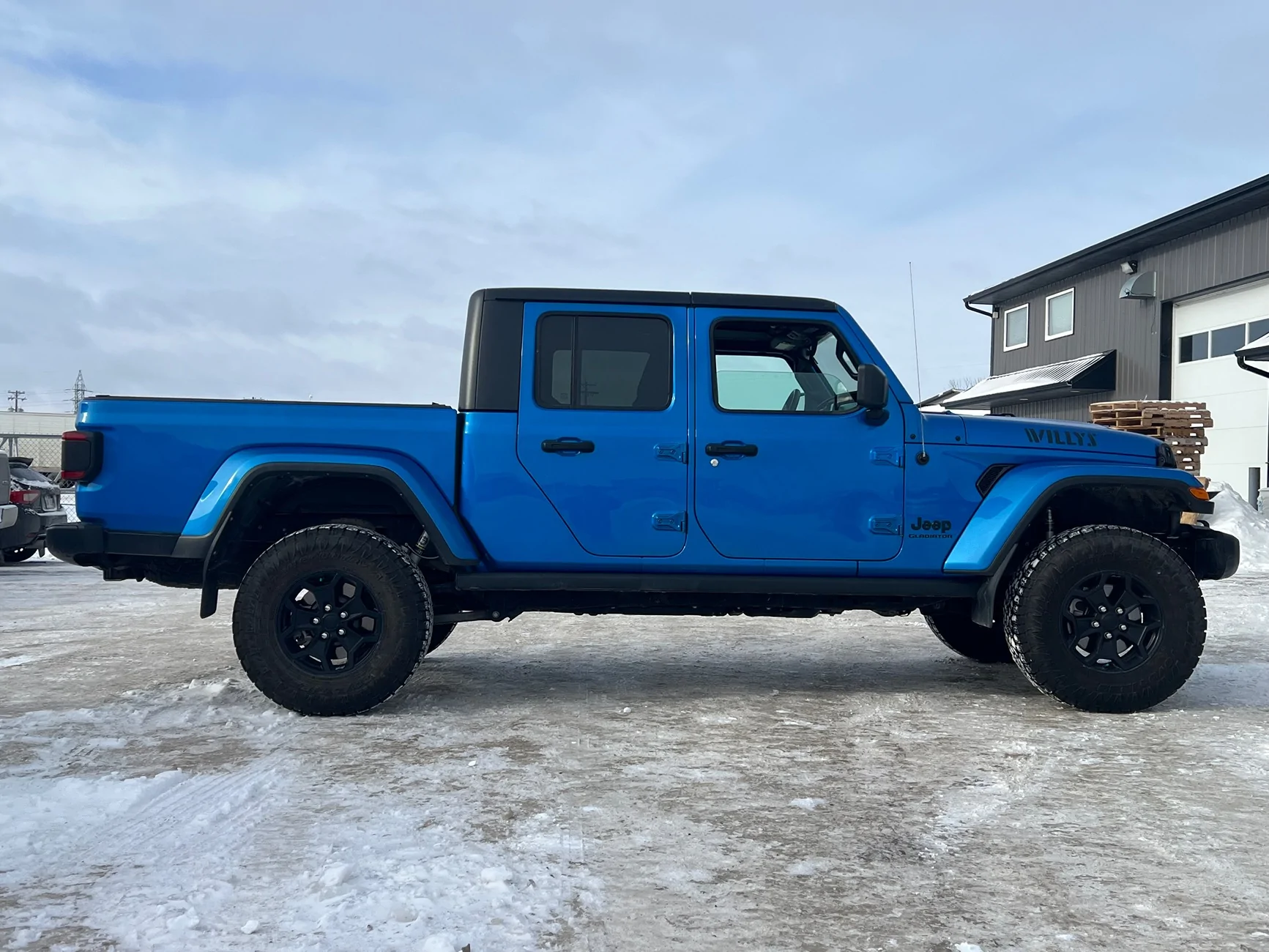

I just had the Mopar 2” lift with Bilstein shocks put on. The picture below is with 285/75/17 Toyo AT 3 tires. Long term plan is to paint and add the Rubicon fenders I acquired, switch to 4.88 spicer gears and go with a 37” BFG K03 tire in load range C. It’s insane how
much it costs to modify these vehicles to how they should look and perform.
