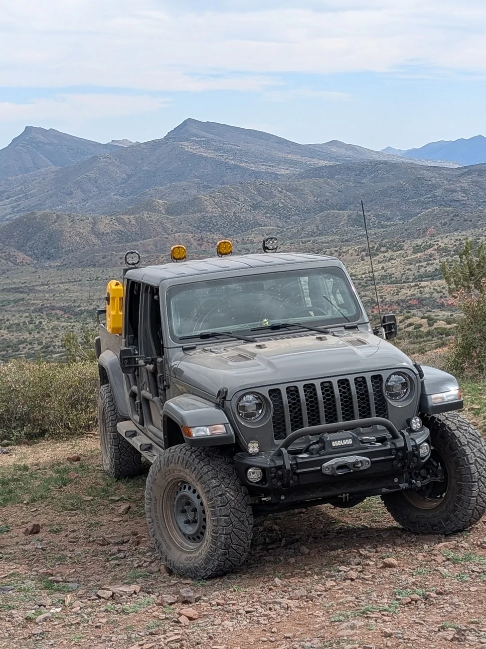

I'm happy with my mopar lift. No complaints here with 35x12.502r17 and now 35x11.5r17
Thanks for that info. You wouldn’t happen to have any pictures of it would you? I’d like to see what it looks like

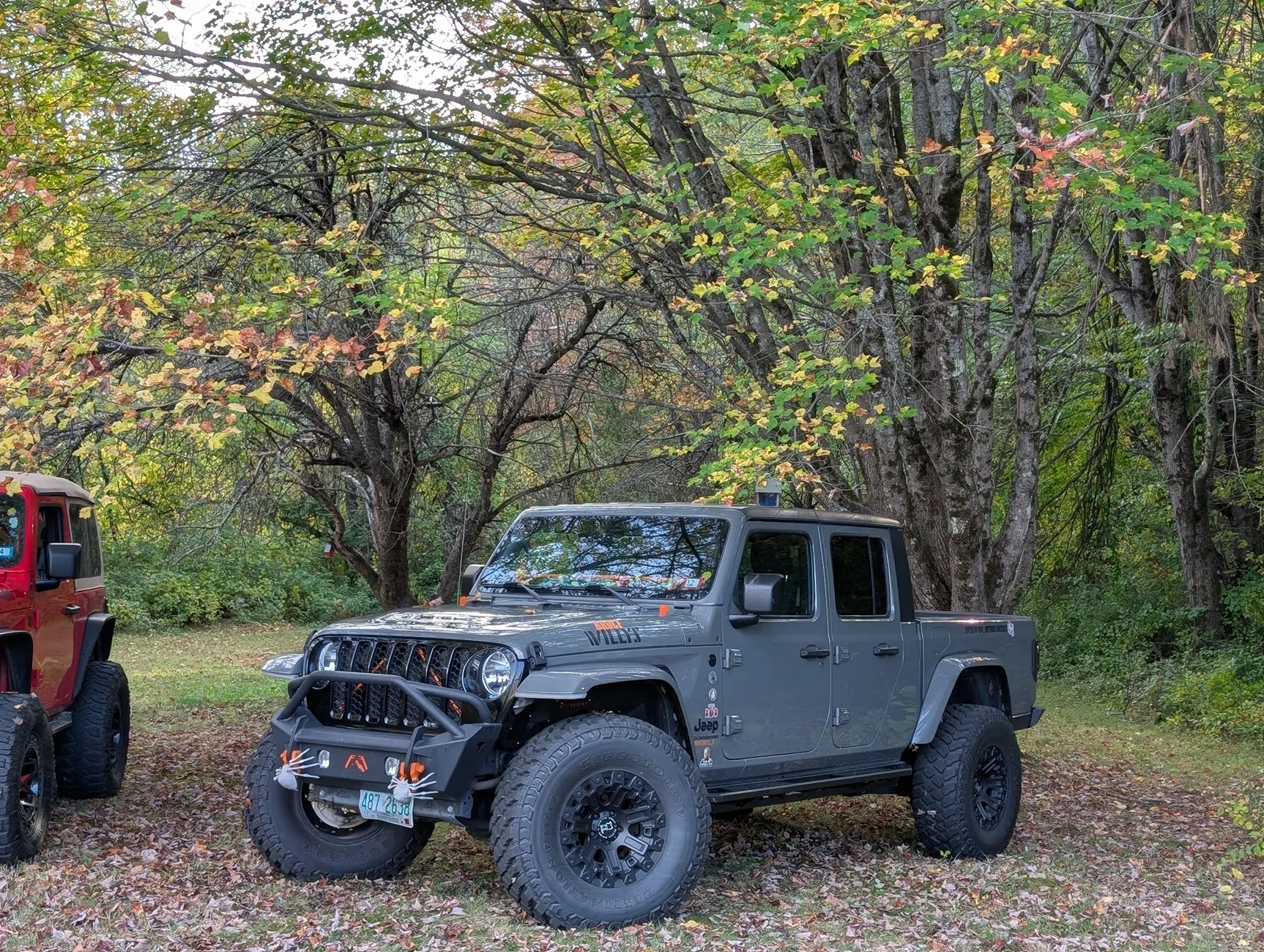

Could always go with a 2” AEV spacer lift. Has served me well.
21 Willy’s
35x12.5x17
I second this, but with 37's. All depends on your use, there is no point of over lifting. The higher you go the more things get messed up imo. Clearing out the stock fender liners and doing a fender chop gets you more than enough space for 35's. If you messing in rock gardens and sway bar disconnecting than you'll need a little more lift than stock.

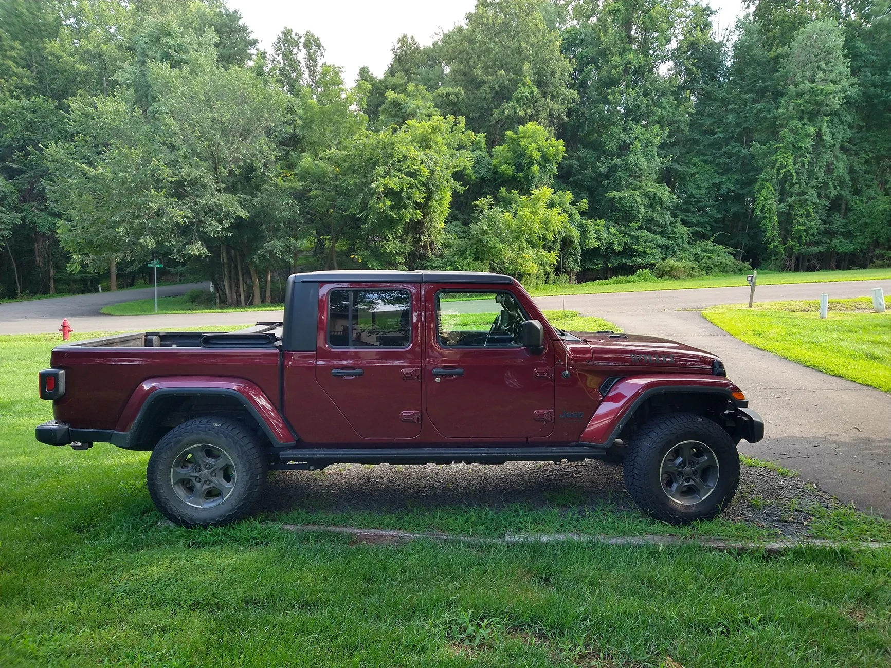

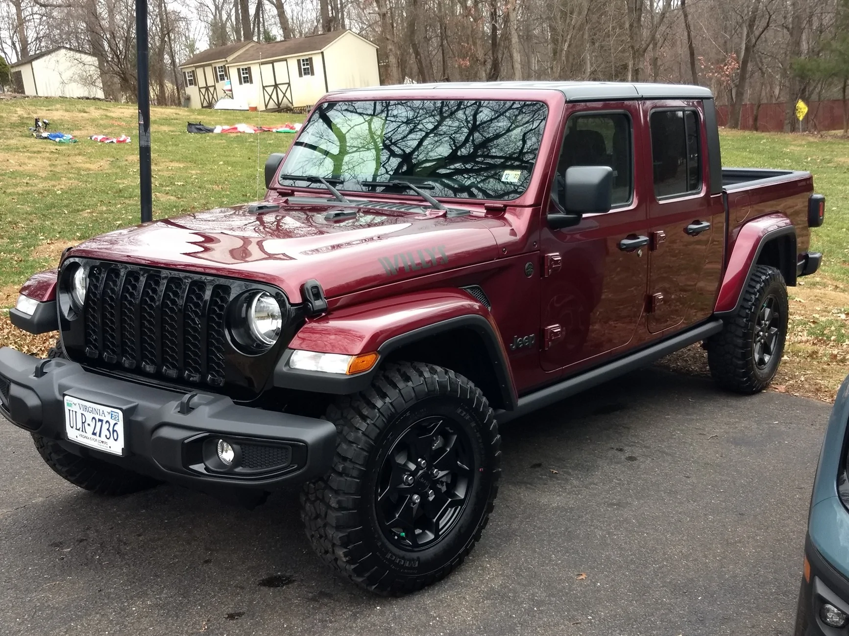

I have a 21 Willys Sport. I had big plans for some kind of lift. I got a heck of a deal on a 500 mile or so Rubicon suspension. So I put that on with a 1.5" spacer up front and a 3/4" spacer on the rear. Overall I got about 2.75" in the front and close to 2" in the rear. Was planning on a full spring lift at some point, but honestly I run trails at least once a month. Nothing real hardcore and I have been perfectly happy with my set up. Only other thing I added was the front lower extended LCAs from teh Mopar kit. Rides better than stock and I have yet to have any issues off road. I am still on some Rubicon rims and tires that I picked up mounted and ready to swap on for $400. Once these tires run out, I will get some 34" or 35" skinnys to install. I found my money is better spent on armor underneath so I can slide around on trails without damaging anything versus going higher. Some before and after pics. Last pic is with the Rubicon suspension installed. Thought I had more on my work pc, but I guess not.

That willys look perfect the way it sits, I have the exact same 2021 Willys in the same color, are the first pictures with the stock suspension?? Or does it have a front leveling kit
