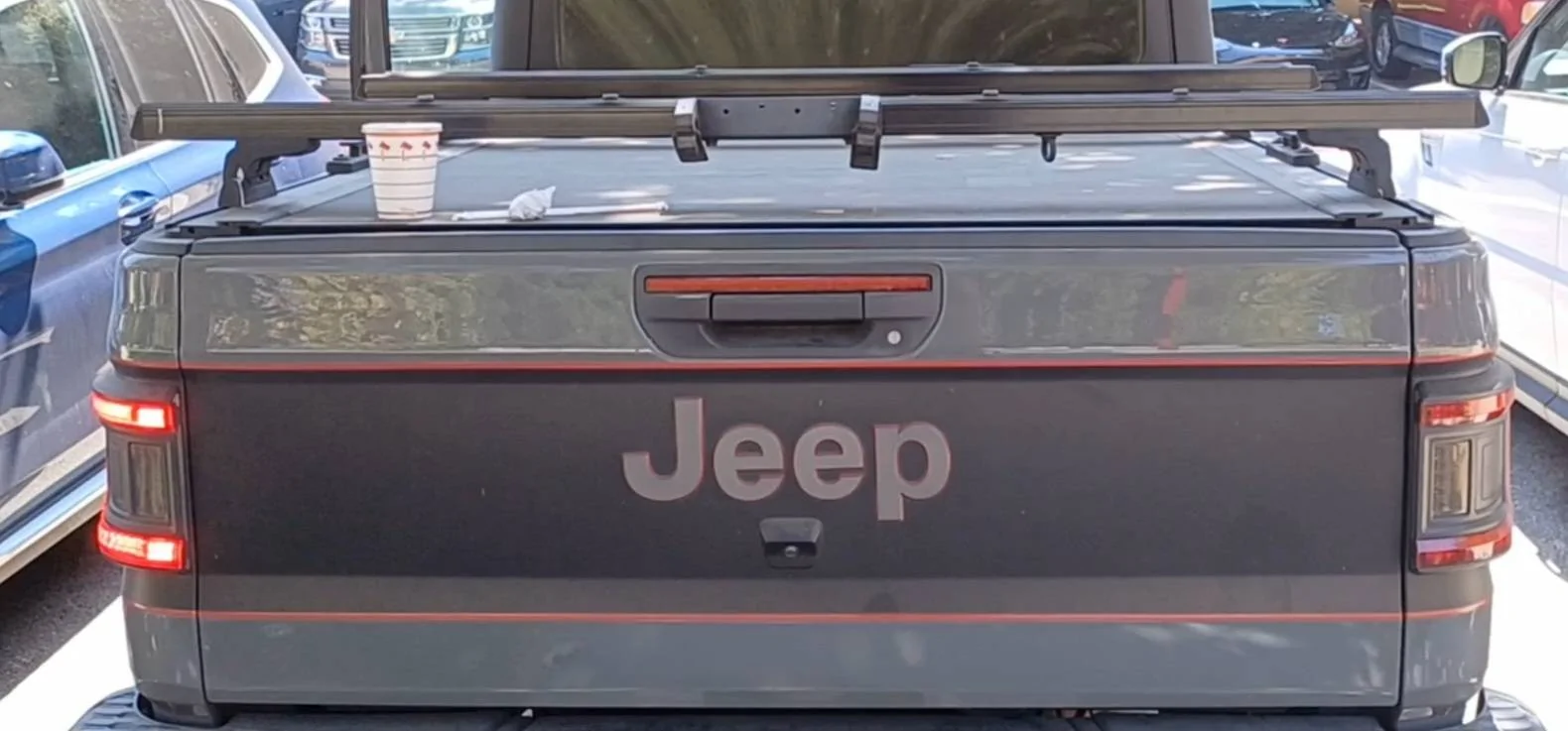

Well, I'm back in this thread again. LoL
Jeep Gladiator Oracle tail light issue VideoCapture_20240831-120602
Update: Once again, excellent support from Oracle. All good to go.

That's what my lights looked like last week. Passenger side wouldn't come on unless I turned the headlights on. I ended up just putting the stock leds back on. I bought my oracles used a couple of years ago. I've always had the understanding that they could potentially only last a couple of years. It's too bad because it's a cool product and looks great.

The passenger side is actually a replacement.
So I put on the old one that still partially lit. Dimmer than normal, but better than no brake lights at all. LOL.
