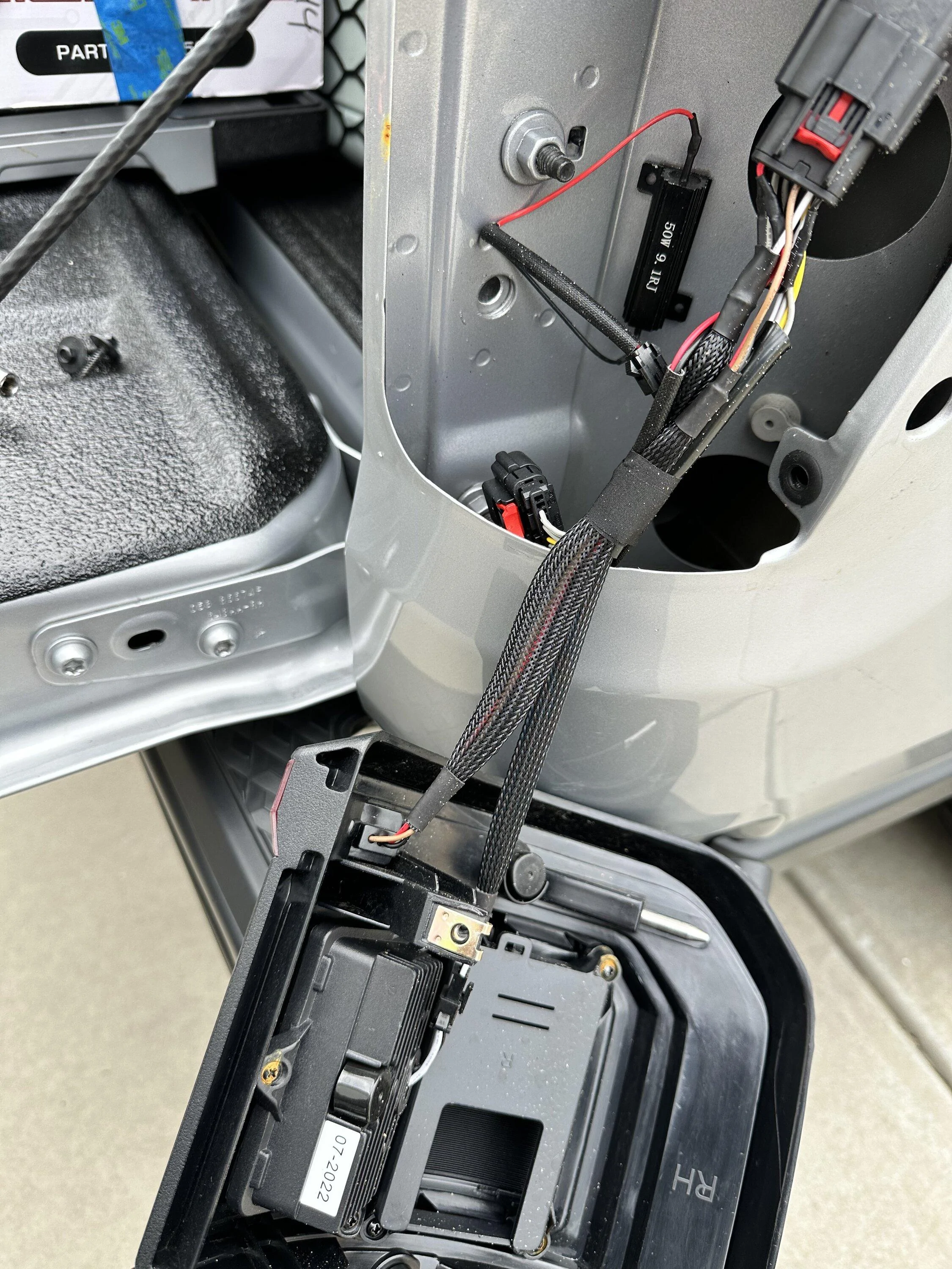

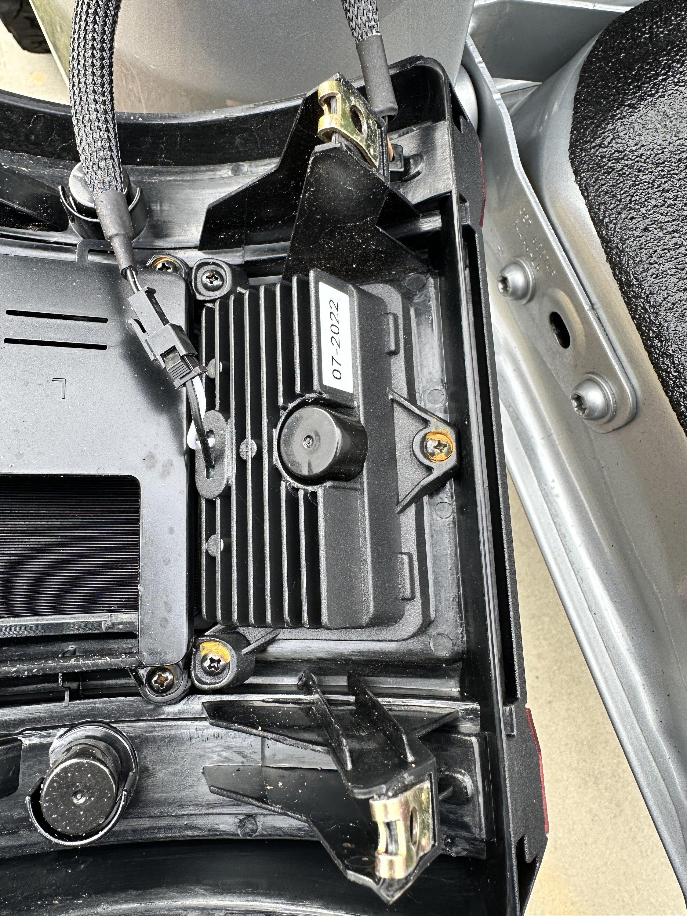

At least they use really good quality hardware that doesn’t rust in a month….oh wait
Jeep Gladiator Oracle tail light issue D9D853F0-3EBA-43A6-81AE-CDA8709D0EBB
Jeep Gladiator Oracle tail light issue 6D97671B-764D-4E1D-858C-BE8FE6386816
That's just surface rust, which isn't really a big deal. Heck, you should look at some of the factory bolts on the Jeep, especially in the suspension area. They get surface rust almost immediately after leaving the factory. It's fairly common in situations where a coating isn't used (like painting or powdercoating).
Surface rust isn't a huge concern. You should be able to just clean it off. Not to mention, Oracle doesn't even use those screws anymore, they use a stainless version now instead.
Dusty78
Dustin
Jun 13, 2022
Charlotte NC
2022 Gladiator Overland
Emergency Medicine
Well the issue is that the screws rubbed off some of the paint so while it may be surface rust now it could have become a much bigger issue down the line. I’m not the only one who’s had the paint issue. The lights never worked anyway so I removed them.
It’s funny because I only got these lights in Oct and they still had the old screws the Oracle knew rusted. I live in Charlotte NC, no Salt on the roads. There’s not a speck of rest anywhere else on the vehicle.
