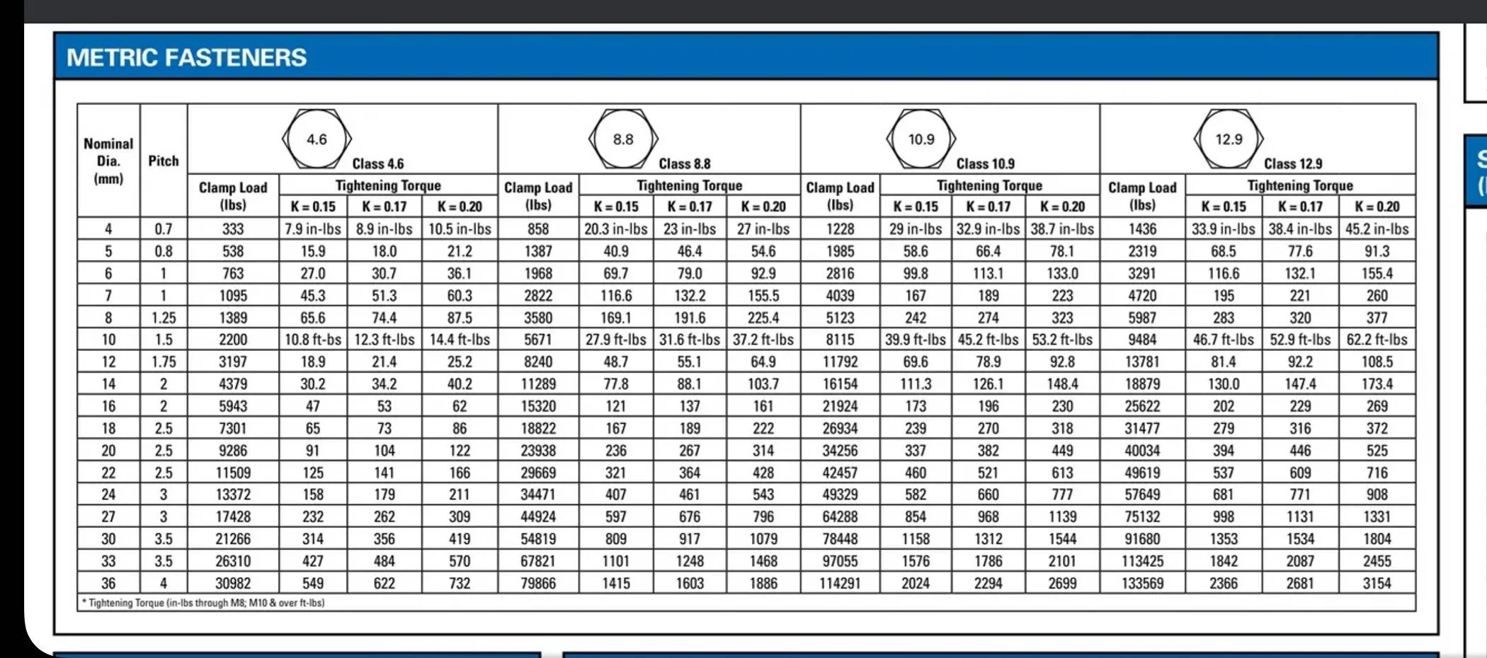

8.8 grade is metric bolts, similar to grade 5 in sae. I think 30ft lb should be enough since you're clamping aluminum and steel. It requires less torque vs steel to steel.
Also, finer thread pitch requires less torque to have the same clamping power as coarse threads. It's probably M8-1.25 or M10
30 seems like nothing for a winch that might pull 6 or 8 thousand pounds
I found something for 8.8 bolts suggesting a torque of 37.

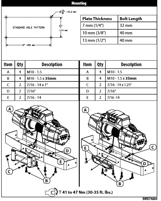

But yeah as above, other winches are basically similar and do have proper instructions including torque. My Warn VR10s also calls for 30-35 ft-lbs

My Warn Zeon came with instructions that included torque and required bolt length based on mounting plate thickness:
I will go with this. The Scar is private label warn so should be the same. Warn gives much better instructions obviously.
