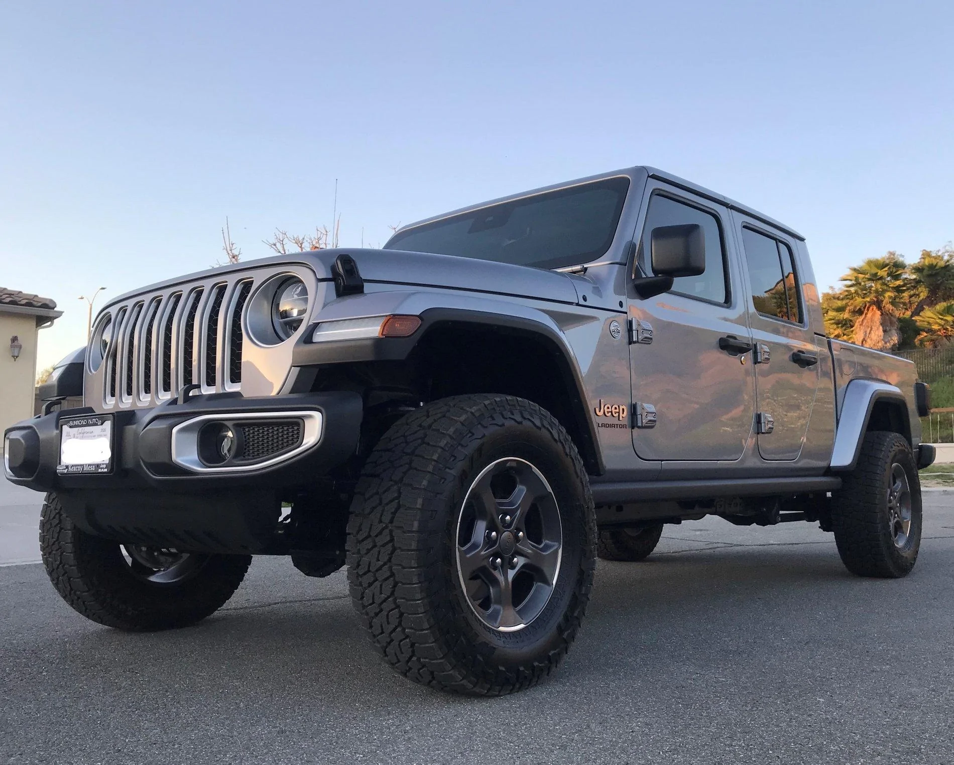

I swapped out my overland tires/wheels to rubicon take offs.
Jeep Gladiator Overland Wheel/Tire upgrade combo suggestions jeep2_LI
Did this change the ride at all or does it feel about the same? It’s about 1.5” large diameter from the stock overland 18’s?
teleportJeep
Marco
Mar 31, 2020
94
126
San Diego
gladiator
It feels more stable, it does make it a bit for stiffer, which I like.
Swayze
Patrick
Apr 22, 2020
88
100
2020 Jeep Gladiator Overland
Right now I have a 60 mile round trip commute, so I may keep it stock until we move in the next year or so, but then again that is a long time to have small tires.
