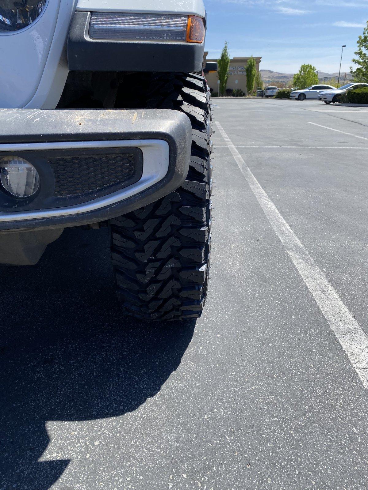

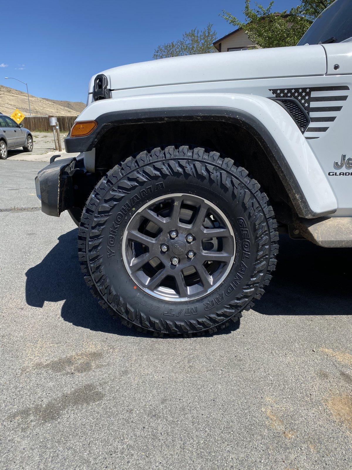

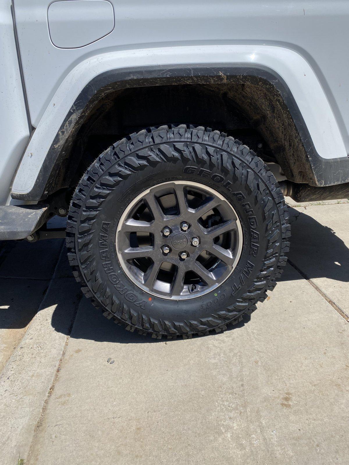

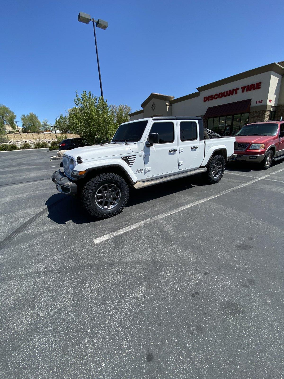

Just picked it up a little while ago. 305/70R18 Yokohama Geolandar M/T G003's. They're about 34.5x12 mounted. At full crank in a turn, it feels like there is a slight rub.. But how often do you really do that anyways? Haven't taken it offroad yet so I can't speak to full stuff condition.

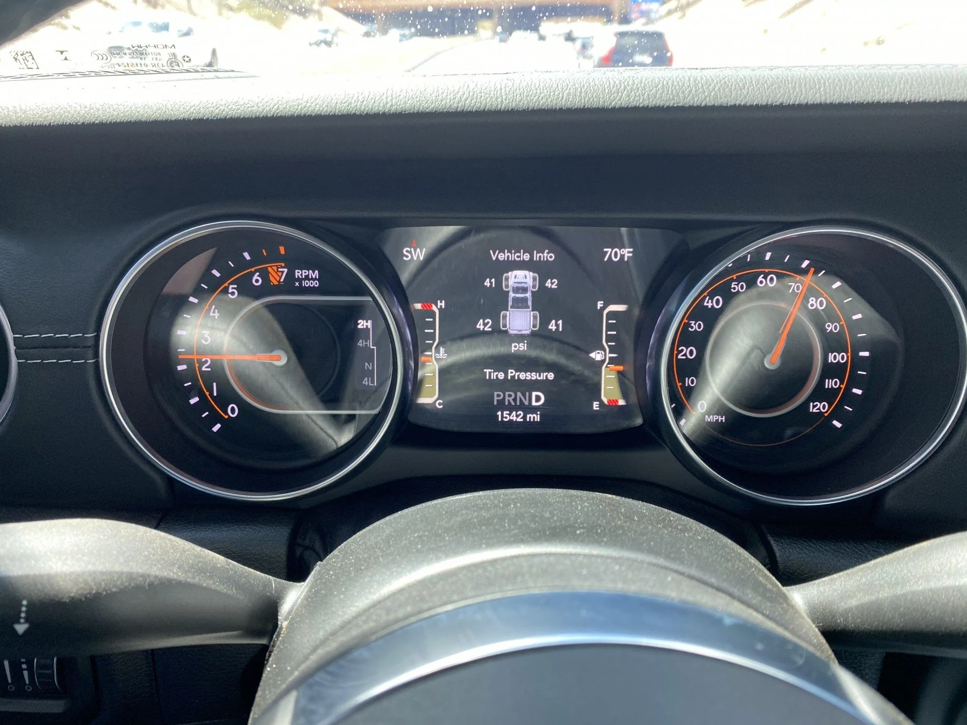

Additionally, you can see the speedo at 70MPH leaves RPMs about 23-2400. It does feel a little more sluggish given the 3.73 gears in the Overland, but I would hardly say its a big deal. Most people probably wouldn't care.

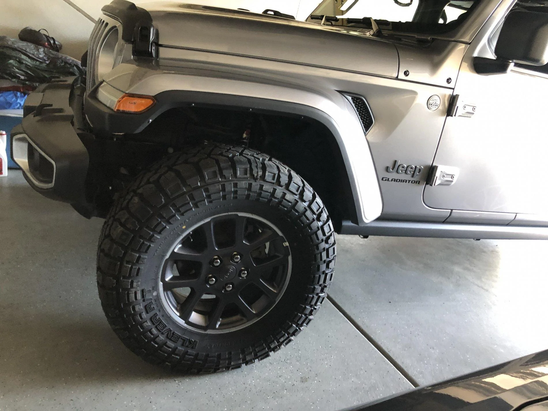

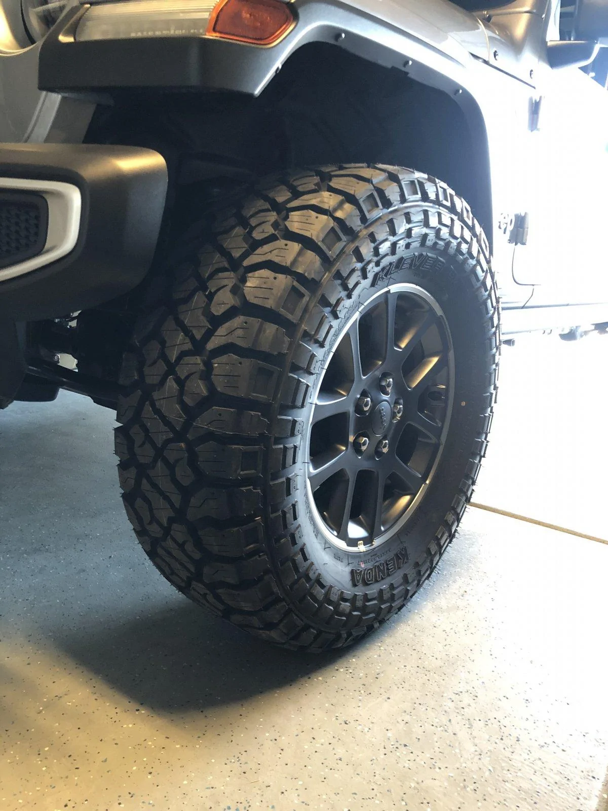

I got all of them done. I may go with wider wheels in the future, I rather get a bumper and winch first.
I got the kenda’s 35/12.5/R18 to 31-32 PSI and changed the tire size with JSCAN.
Overall it handles well. I do definitely feel the bigger tires on the gladiator coming from the falkens 285/70.
I like the more aggressive look with the overland wheels.

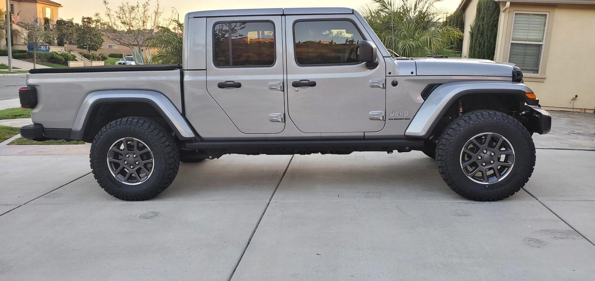

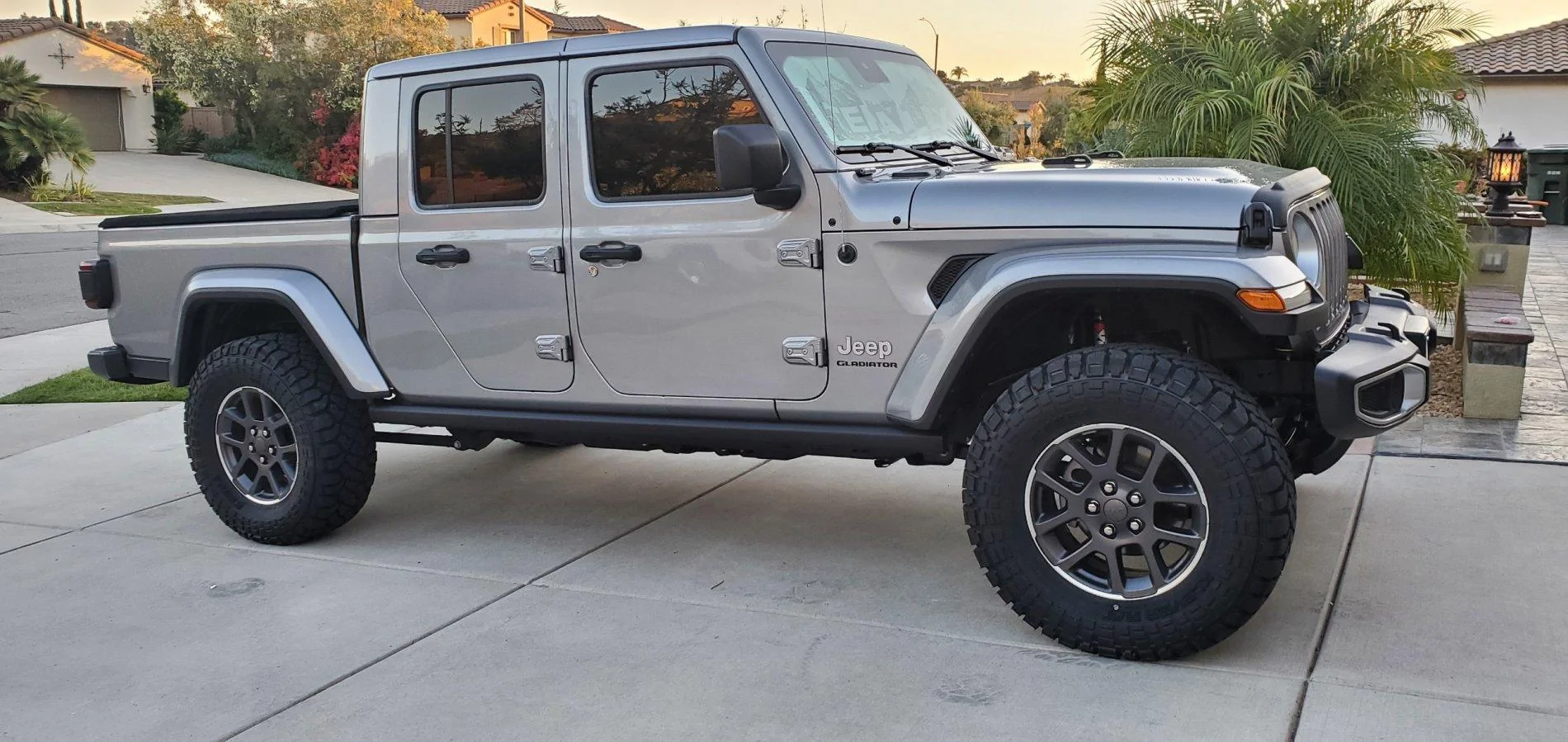

How is the road noise? How much are they sticking out from fenders? Can you post a pic to show that?

The only comparison that I personally have on other 35s, are the nito graplers m/t on my old tundra.
The kenda's are much quieter on the road than the nito, but a bit more noiser then the falken 285/70 A/T aw3.
They stick out about 1/2-3/4" without rubbing. My overland has rubicon take off, springs, shocks and a 1.5" teraflex leveling lift. At a level ground it measures ~ 42"(front and back) to the black plastic edge of the fender.
I am considering wheel spacers 1.75" for the "look" while I get new wider wheels.
