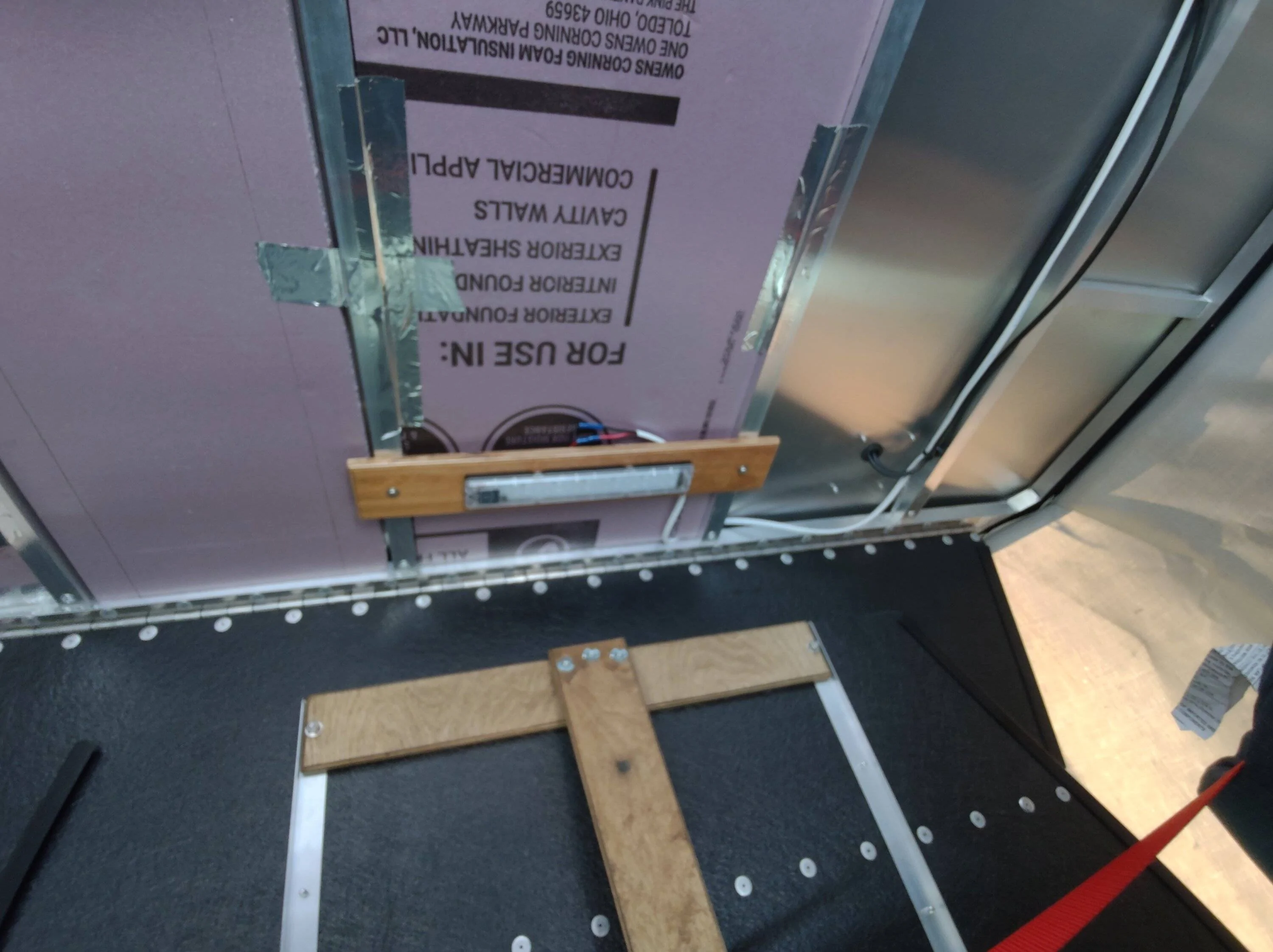

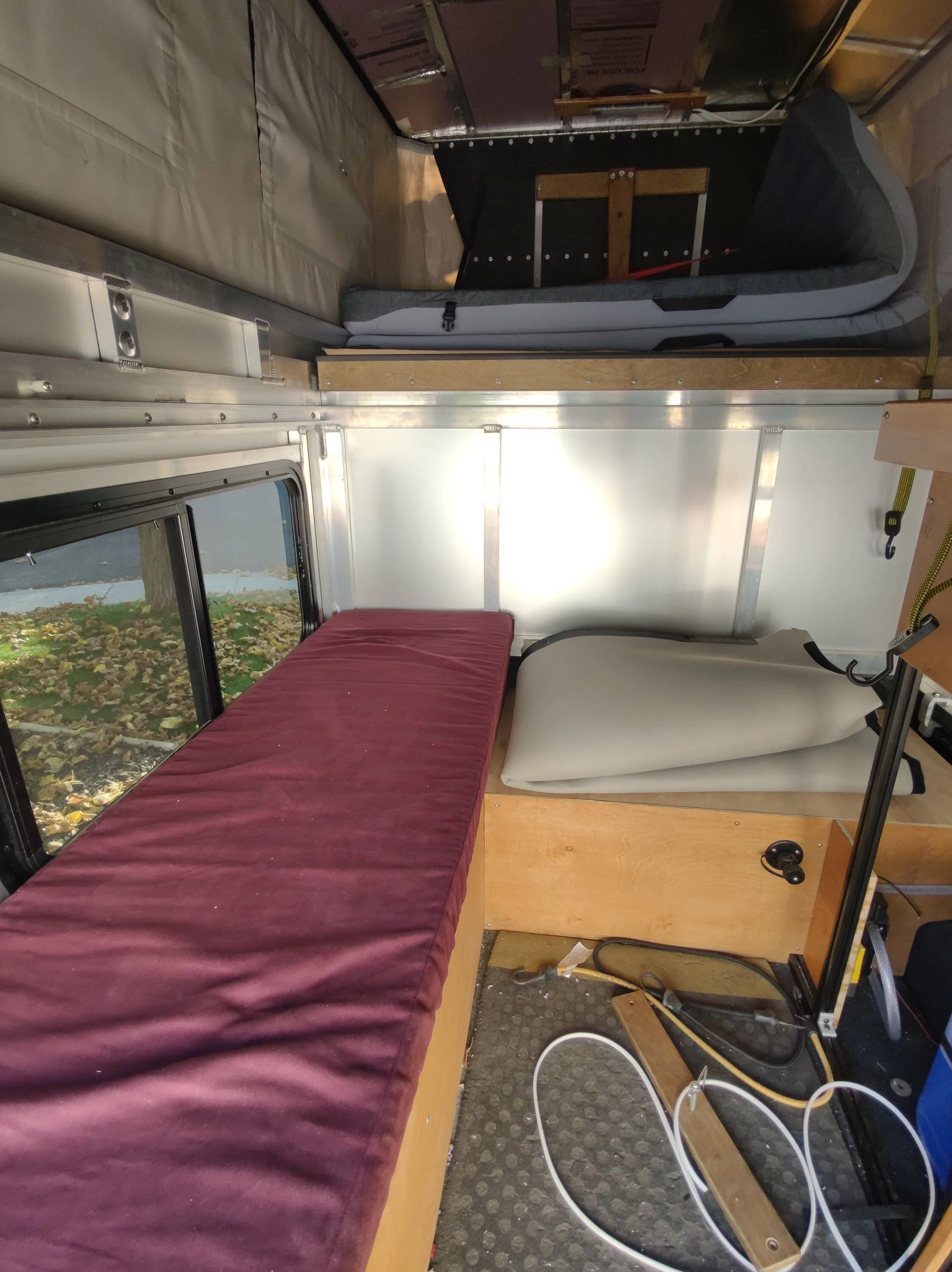

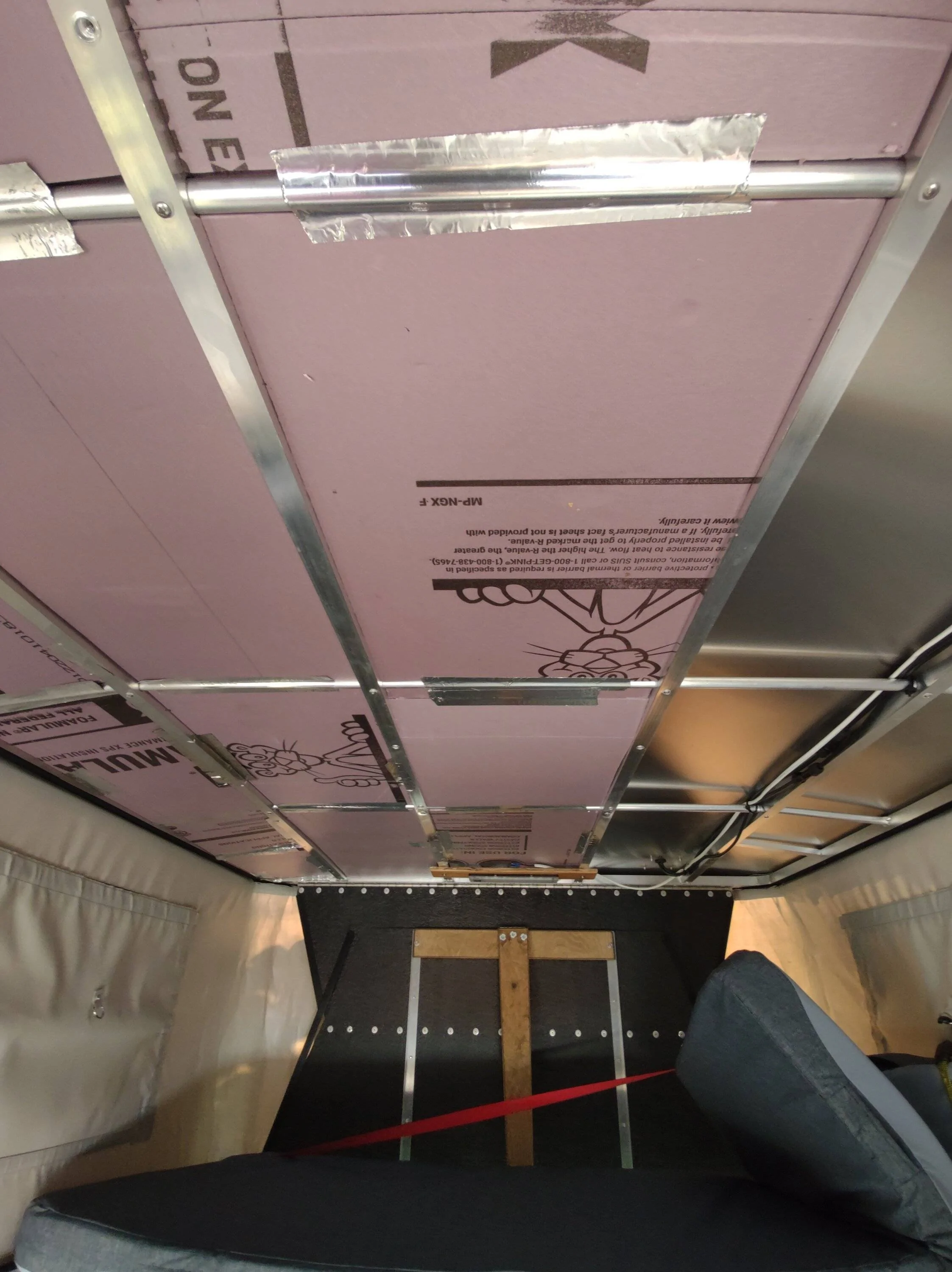

Progress for me. Pulled the headliner. Started insulating, installed and ran wire for the two National Luna lights(dual mode) need more insulation. Had a bench pad made at work.

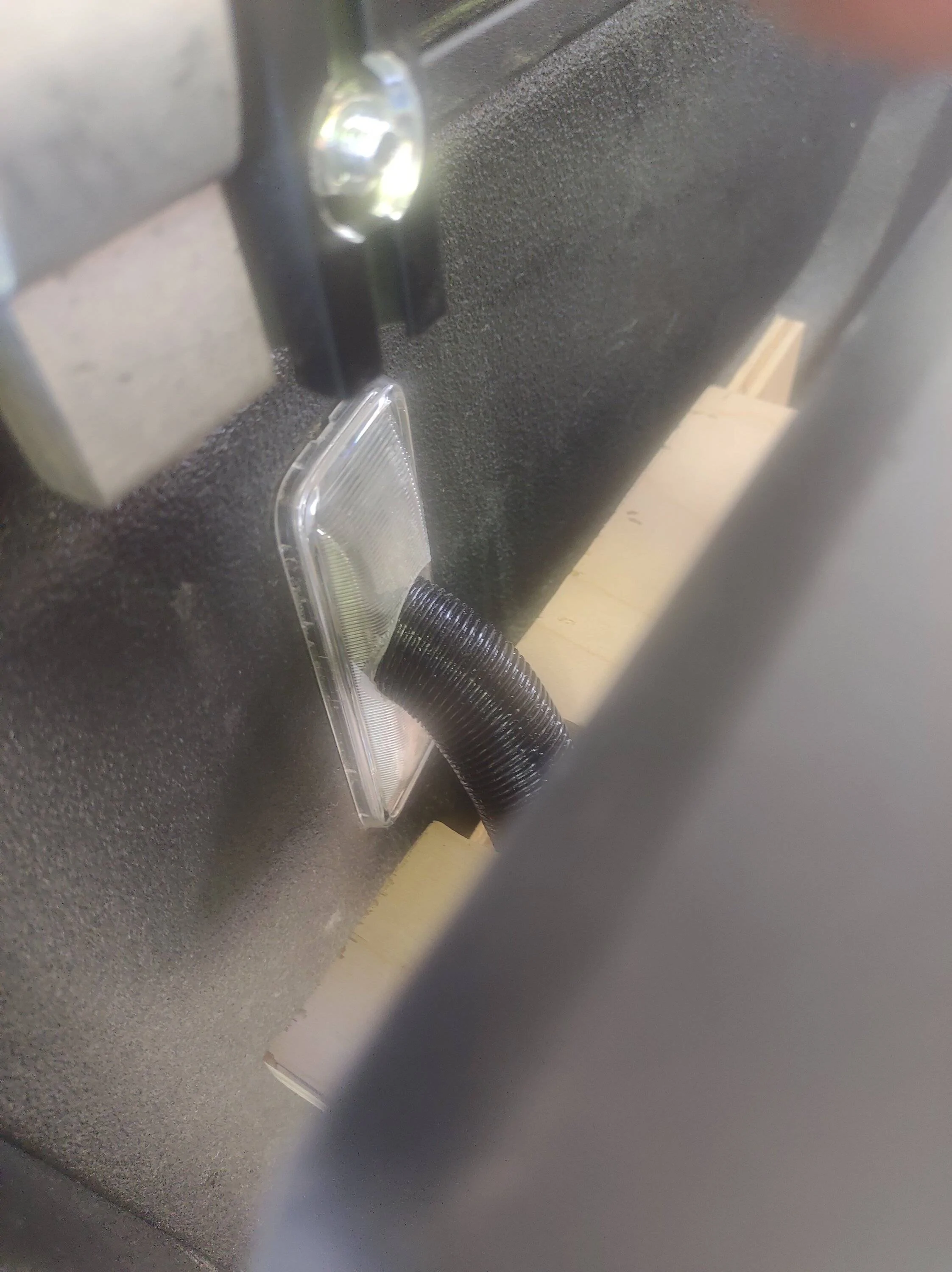

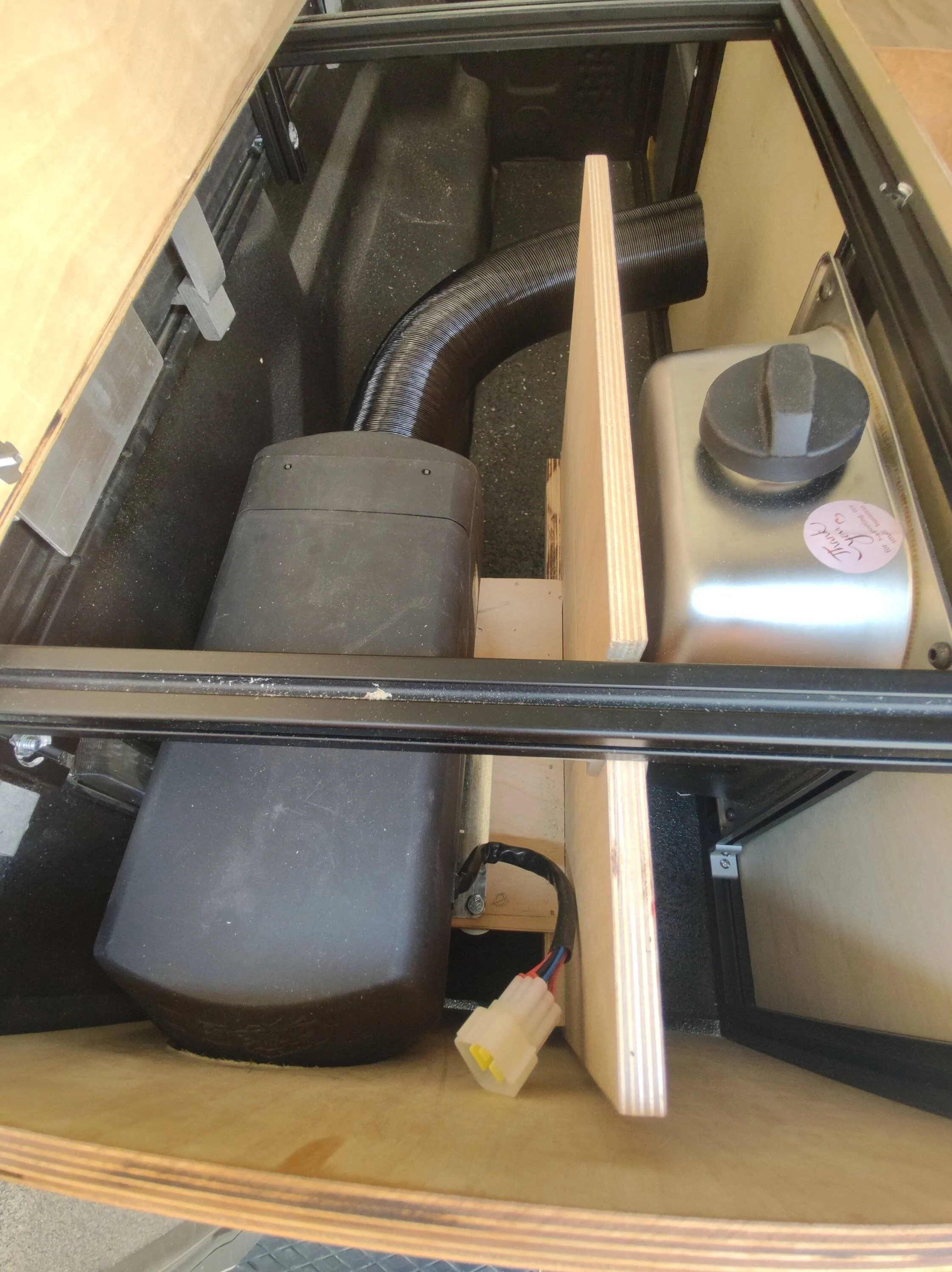

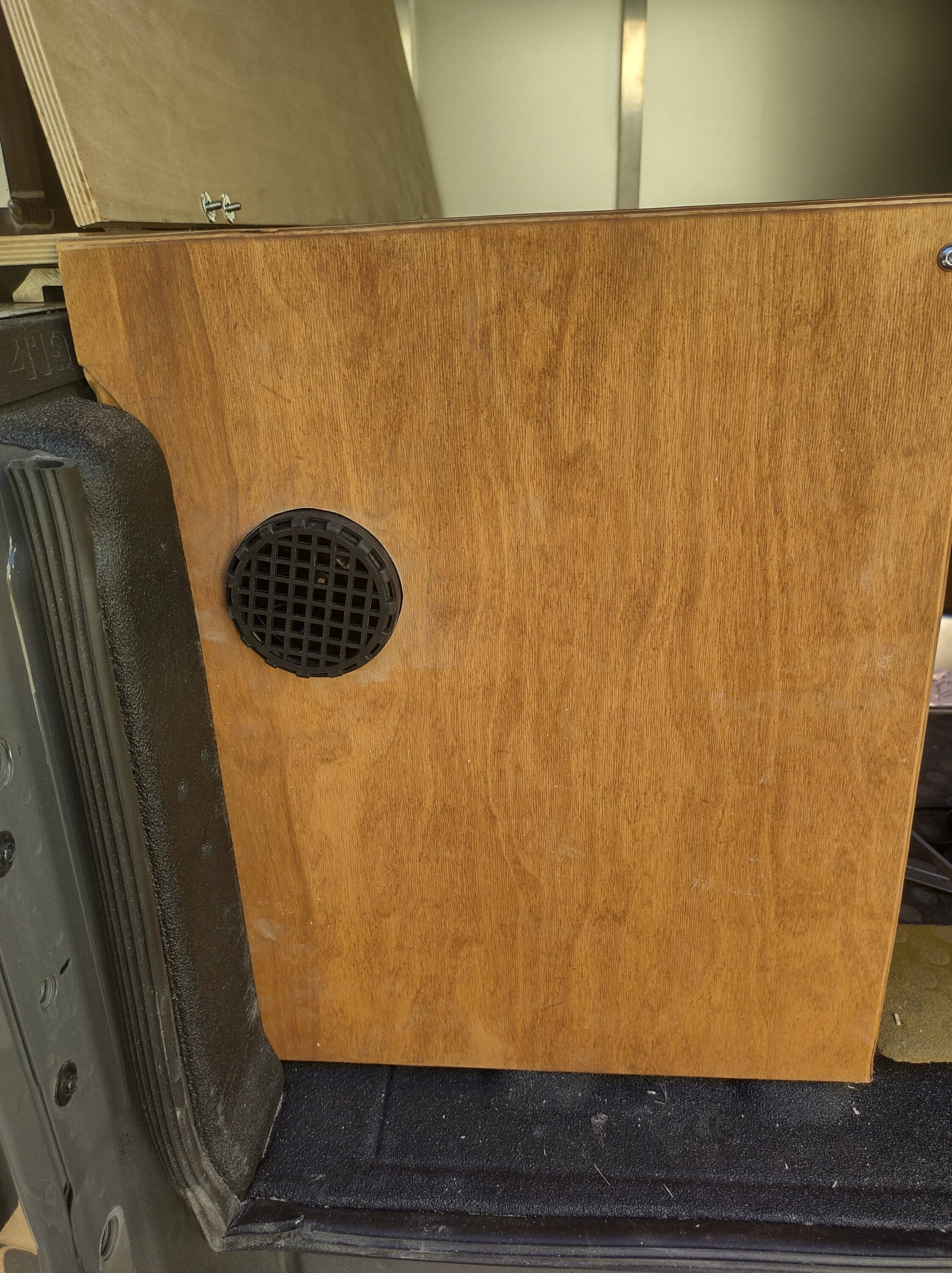

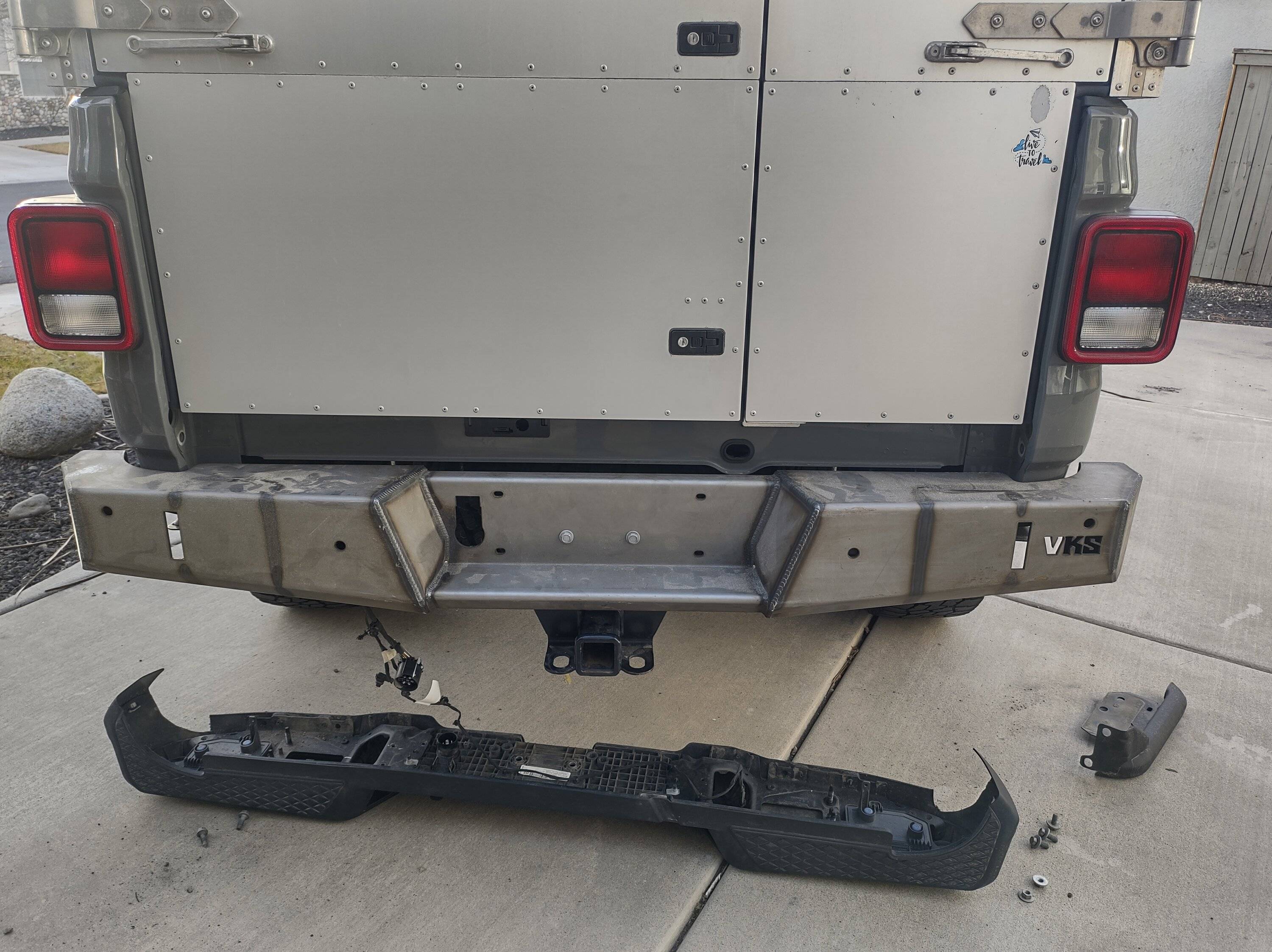

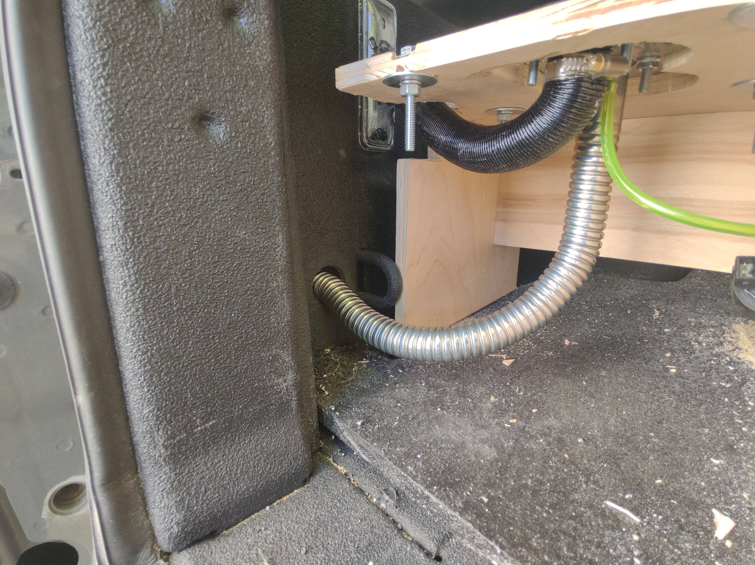

So I took the bed light out. Bought a second one off of eBay. Destroyed it by drilling it out and running the intake hose through it then silicone to seal it. On the underside I took some thin aluminum and blocked off the area where the intake is to protect it from water and dirt/mud. The hole where exhaust goes. Drilled that out using a big ass step drill. I need to get some exhaust tape to help mitigate the heat in that area. The exhaust will then be stubbed out on the bumper which was test fit a few weeks ago.
Having a local guy mod the bumper for a swing out and side protection. Plus bike rack, and the center will have MOLLE panel so I can mount Jerry cans and propane/ whatever else I decide. I have a TMR Customs super mega bearing swing out. Little piece at a time.

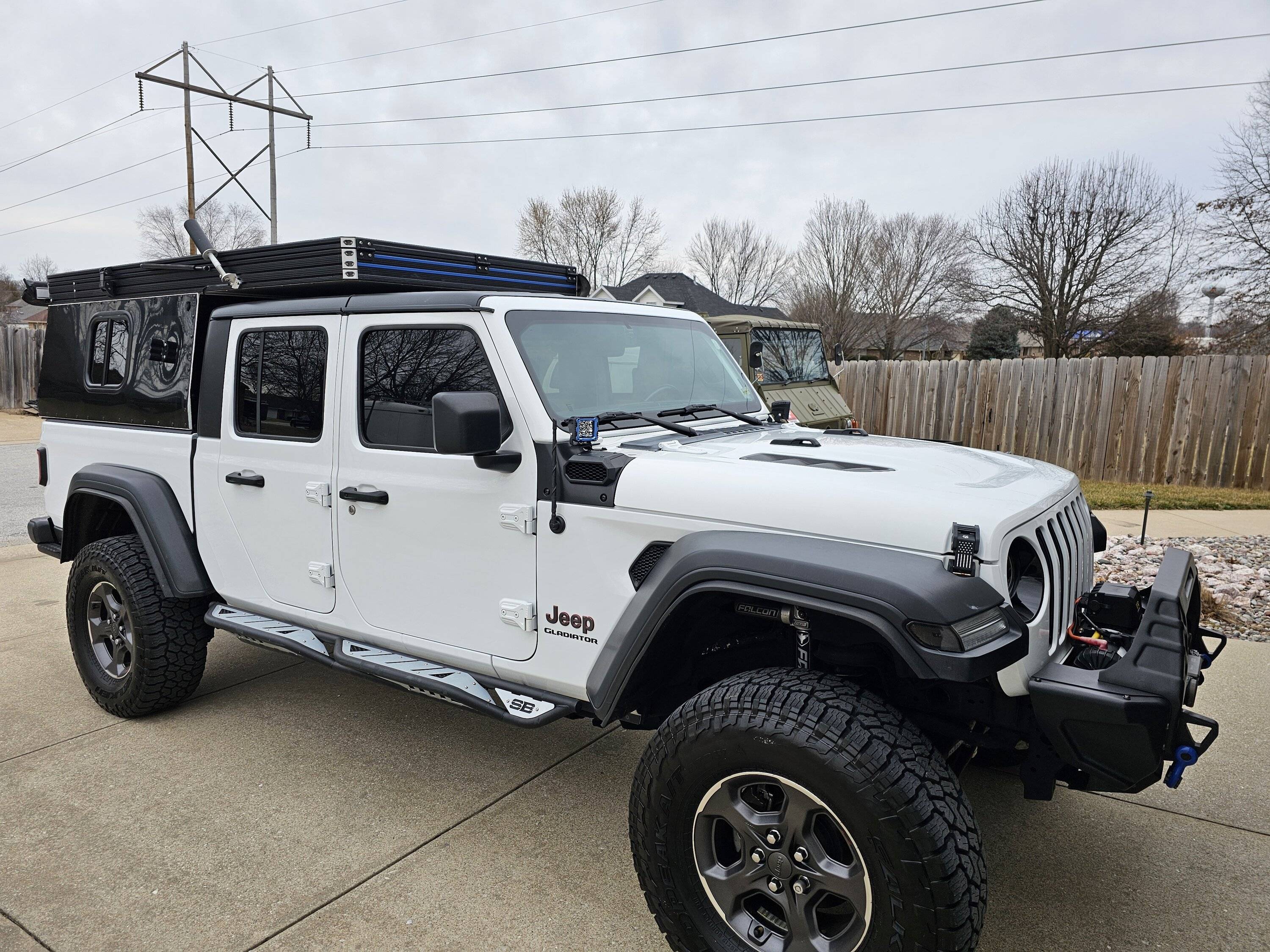

Here is my addition. Just picked it up a few days ago and have plans to head out camping this weekend with some friends.
Only a poser pic so far, but if I remember I will take some more this weekend and post here.

What brand is that?

Not really for sure. Came with the rig and has no markings that I have found so far. It has barely been used if at all and opens nice and tall with good support.
