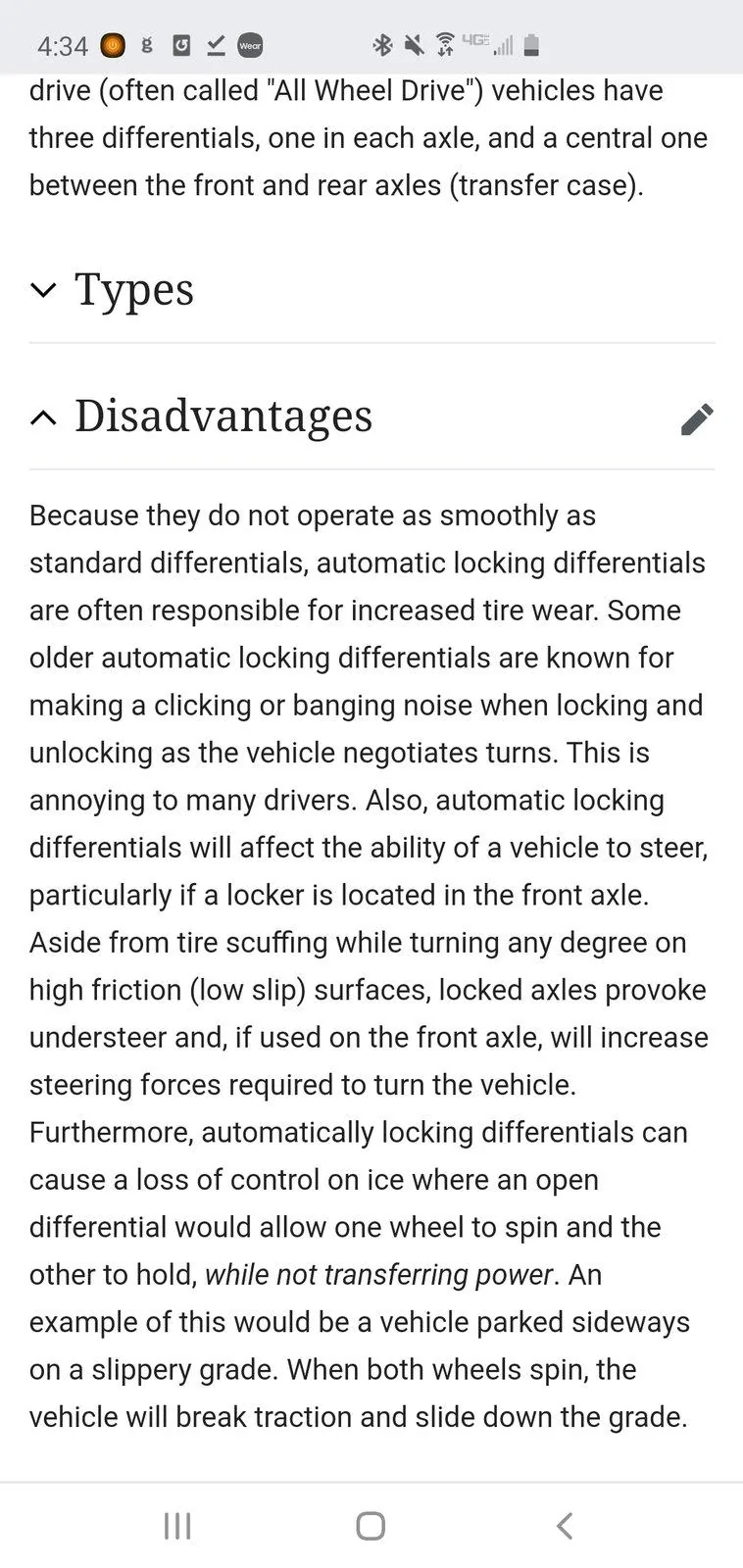

Lets go ahead and end this one where it started.
From Wikipedia:
"Furthermore, automatically locking differentials can cause a loss of control on ice where an open differential would allow one wheel to spin and the other to hold, while not transferring power."
https://en.m.wikipedia.org/wiki/Locking_differential
Now you've seen it somewhere beside "on this forum". Might want to google "locking differential, drifting" also.

This has nothing to do with a limited slip differential. An lsd is not in anyway a locking differential. Drifters weld their differentials so both wheels spin like the lockers on a rubicon.
It has everything to do with an lsd, in that an lsd has the potential to cause the rear to break sideways traction by redirecting power to the wheel that is not spinning, which is exactly what it does and is designed to do. The poster i originally responded to suggested that an lsd might make the rear LESS squirrelly. An lsd has zero potential to make the rear less squirrelly, and has every opportunity to make it more squirrelly, or prone to getting sideways by getting both wheels loose, instead of one, on slippery surfaces. An lsd has zero ability to increase your coefficient of friction or add traction, it can only redirect power. This is just basic physics.
This is not a disortation on the effectiveness of lsd's in snow and ice. They are an effective tool if the individual driving knows what behaviour to expect, is prepared for their effects, and knows how to drive with them. That has nothing to do with the known fact that rear spools, lockers, and lsd's, increase the squirrelly rear end effects in snow and ice and other slippery conditions, to varying degrees.
