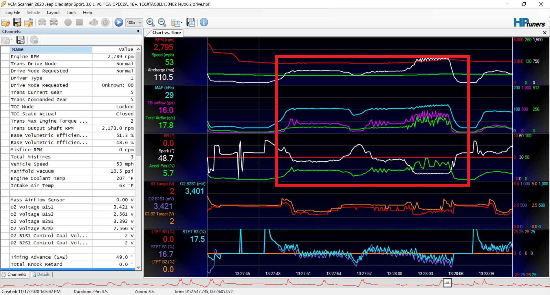

Cruise control can definitely trigger a multiple misfire code. The culprit in my opinion is the throttle body air flow model. At high loads under light throttle the control oscillates quite a bit. Cruise lives in this space and on top of that it is another control. From the data I have gathered the throttle body gets into a pretty high frequency osscilation like jamming your foot on and off the throttle 30 times a second. This air flow caused some detenation which os then made worse by the timing being reduced to fight load knock that is not there. I currently have a revision of my calibration that gets into pretty intense throttle oscillation issues. I am using it to study the situation. My guess is fca knows the issue but the fix is not simple with the current software architecture. The throttle control does not have enough strategy to account for all operating conditions.

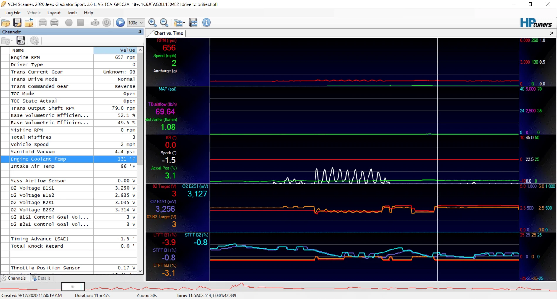

This oscillation is not normal and it is not just throttle. The issue is a design issue across the product line. you have multiple closed loop controls with no caps on them and they have the ability to find areas of instability that cause the engine to think it is malfunctioning, and in some cases cause it to malfunction.
I have include two screen shots, I have a dozen more. One shot is of the truck idling warming up, and the instability happened quickly and went away once the temp increased. look at what happens to air flow, timing and RPM. That will throw a misfire if it happens long enough.
The other picture is data I took troubleshooting this problem. Notice my speed is steady and constant. But airflow starts to oscillate with relatively little to no pedal position change. Once it gets going it starts to jump the timing and airflow on the throttle. Once a real pedal input is given it goes away.
You can call me an arm chair quarter back and dismiss me if you want. I could care less. I am fixing my Jeep I don't need any help from FCA. I just thought I would share what I know so others can get a better picture of what is happening to their Jeep. ALL in all it is not destructive if you don't let it operate like this. I would make my dealer rest all the adaptive learning when you take it in to get the code cleared. This may get you out of the woods for a while or forever once they do the software updates.
