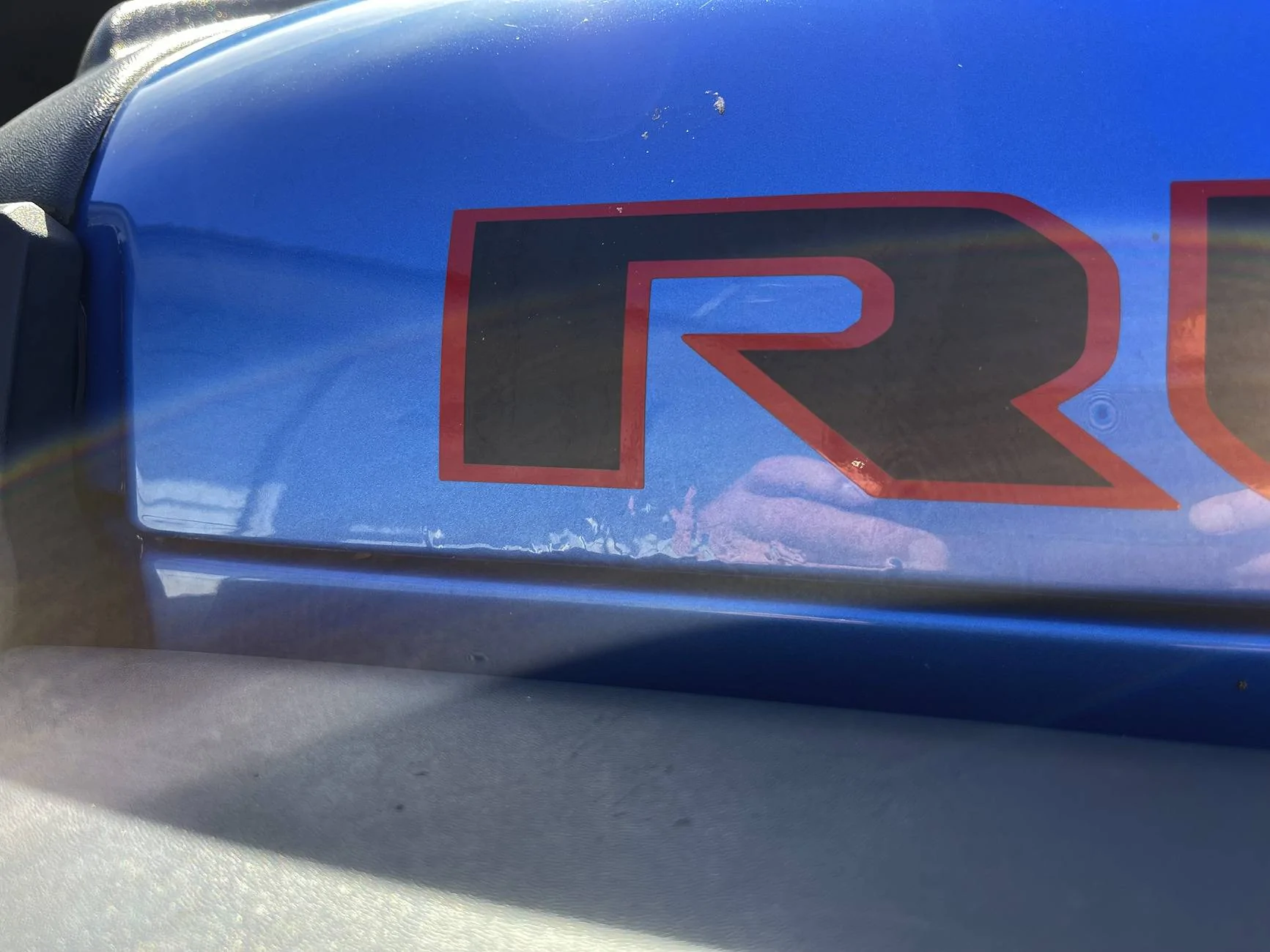

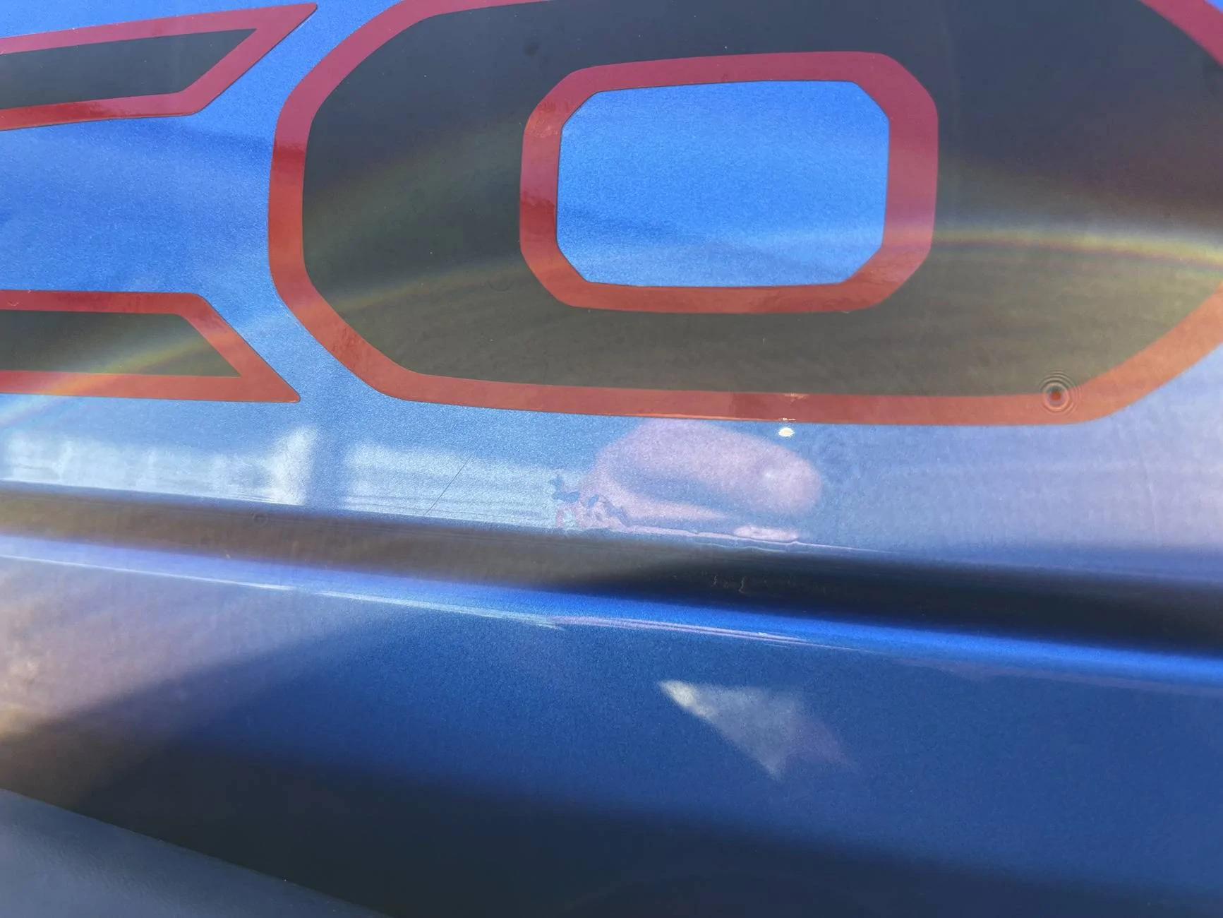

A few months ago I noticed the paint on the edge of my 2022 hood starting to show corrosion in a couple of places. My dealer took some pictures and sent them in for warranty approval but apparently the request was kicked back because they did not submit enough information. I spoke with dealership today and they'd like me to leave it with them for a day to better document the problem and get everything sent in. I don't mind doing that but things at work are hectic so I'm holding off for at least a couple of weeks.
The problem isn't bad yet and is only showing on the driver's side edge of the hood. From what I've read this is covered for 5 years and unlimited miles, is that correct? I'm currently a little over 34,500 miles and the Jeep will turn 3 in a couple of months. I will get it back to the dealer for proper documentation before it rolls over 36K miles or 3 years. Right now it isn't bad enough that it bothers me and I'd rather wait at least a few months to see if corrosion shows up on the door hinges then get it all done at once. Is there a reason I should get the hood taken care of now rather than wait?
That's what my hood looks like. I have tha Granite Crystal Grey and didn't notice until I felt it one time while hand cleaning the truck.

I first noticed a spot on mine the first of June last year and it was small, about 1" long and 1/4" tall. Around the middle of July when I showed it to the dealer it was noticeably bigger and another spot had started a few inches away from the first. When I finally took it in for repair around the first of the year that first spot was over 4" long and the second was about 2". The repair shop my dealer used ended up having it for 10 days. It would have only been 5 days but they weren't happy with the way it looked the first time so they ended up stripping and painting it twice. I am very happy with the way it turned out.
