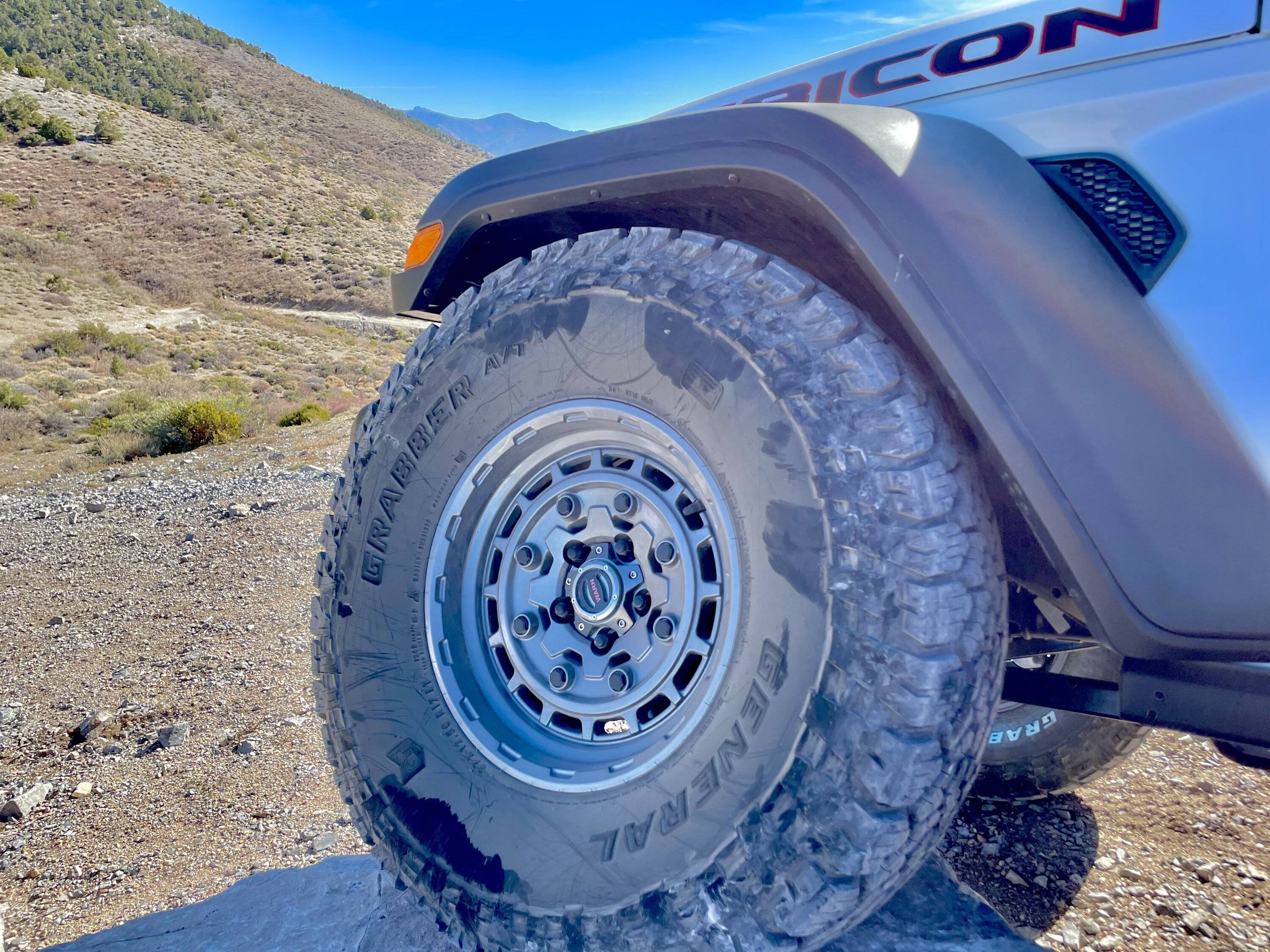

What if I put parchment paper between the wheel and the rotor?
Y'all are killing me here! ?
The only solution is to swap to a black rhino or warn wheel that covers the rotor completely. ??
