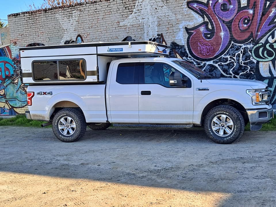

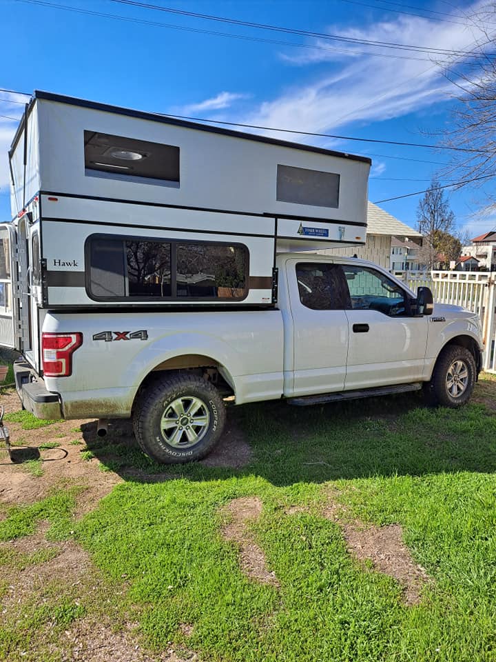

Forgot all about this thread and forum. I bought my F150, did mild suspension mods and switched to 33" load range E tires (from 31.5 inch, load C), and put on the FWC last week. It's definitely not a Jeep, but it's home for the next few years. I wanted smaller, but this is about the minimum I'm willing to live in.
Heading to Alaska when they open the borders. From there I'll spend 2-3 years driving through Central and South America.
Glad you found the truck that works for you. My wife and I have a JLU and JT currently. She is planning on the JT becoming our camping rig/trailer tow vehicle, but I have a feeling that between us and the 2 kids we might end up bringing 2 vehicles on any trips to carry gear and other stuff.
