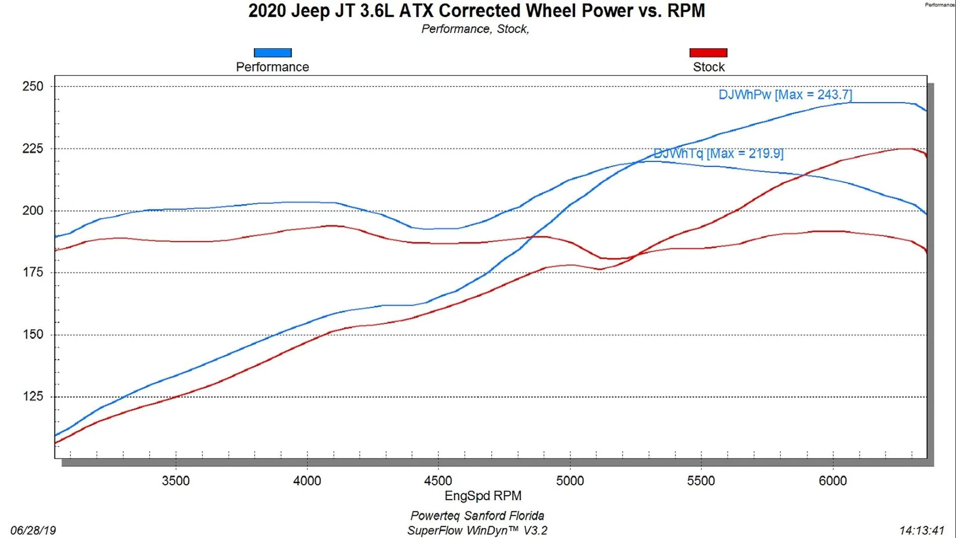

Not at all. On perfectly flat ground to 60, someone could mistake them for somewhat close but were talking a handful of truck lengths difference and thats with the official times to 60. Add any weight to the gasser, or introduce an incline and the difference is magnified quite a bit. Top end doesn't matter in this comparison because you'd be manually babysitting select shift just to stay in the band to get the power it has on tap. The diesel puts down its power at 1800 RPM and holds it. You're halfway there at idle so as you can imagine, the difference is quite dramatic verses the 3.6 needing to wind up into the 5-6k range.
Here is a gasser dyno. In stock form it eeeks out 225 HP at the wheels and thats once you get to 6k RPM and boy does that feel like a long time when you find yourself needing to be faster than very sluggish.

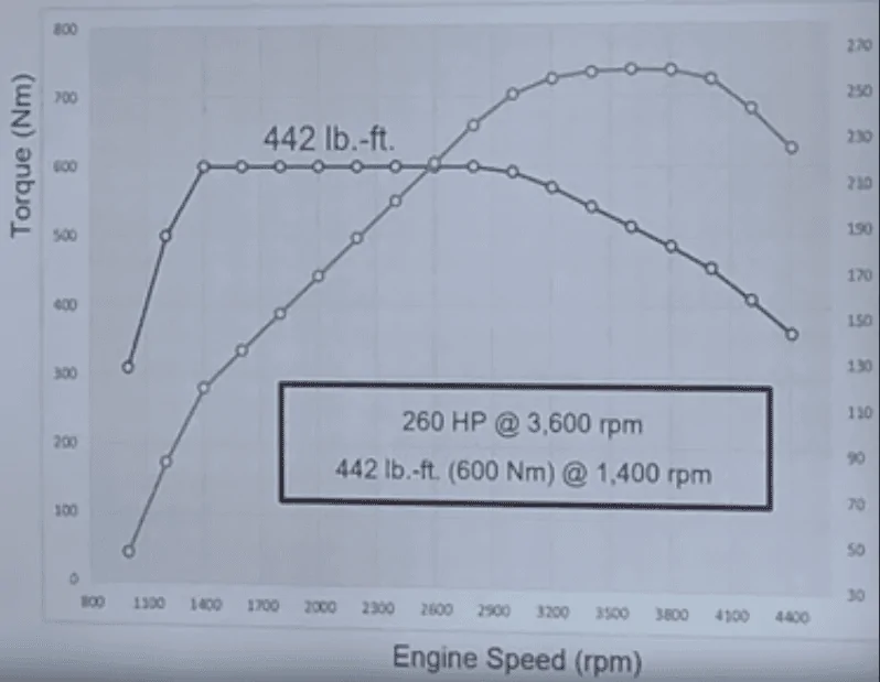

Here is the EcoD. She's ready to send it the moment you stomp on the gas. It's night and day.
Hard to compare an engine dyno to one measuring at the wheel, but I digress. Like Nacho, if the diesel was available in manual, I would probably have strongly considered it, but I detest driving automatics. Anyone have a link to 1/4 mile times comparing the two in similar builds?

"Power" is determined two ways. Torque and Horse Power. Torque is what accelerates a vehicle. Torque is what you want in a 0-60MPH race. HP gives you top speed, which we really can't see with our Gladiators because Jeep limits top speed in the ECM because of the non-high performance tires used on it.
The diesel should out accelerate a gas Gladiator. The torque curve on the diesel jumps up quickly , and doesn't fall off much at higher RPM. The gas engine doesn't reach max torque until the RPM's are up there. The ECM is designed to provide the best performance for that specific engine/transmission combination. Hence, at full throttle, the gas engine will spend most of it's time at high RPM to keep the performance respectable. The diesel will perform well, but at a lower RPM.
The extra 200 or so pounds from the 3.0L accounts for a 4% increase in the vehicle's weight over the 3.6L; however, the 3.0L (260 HP, 442 lb-ft torque) puts out 70% more torque over the 3.6L (285 HP, 260 lb-ft). The 3.6L does have a 25 HP advantage over the 3.0L.
Horse Power = Torque x RPM / 5252 (5252 is a constant).
Torque = Horse Power x 5252 / RPM
Accelerating, power to get over an obstacle, pulling a heavy load, the Diesel diesel engine has the advantage. Top speed and keeping you going fast, the gas engine has the advantage.
