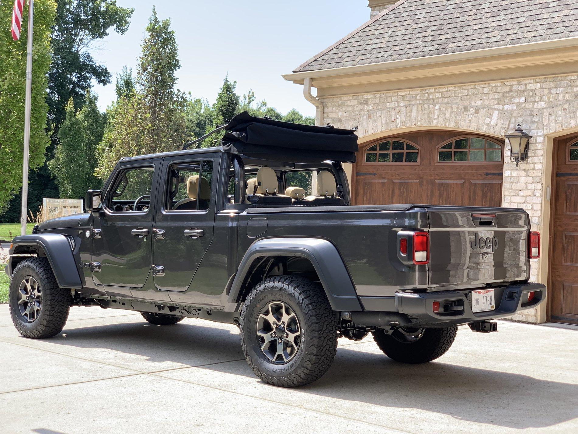

My Sport S on JL Rubi 33’s. Huge improvement visually and no negative impact on drivability that I’ve experienced.
Jeep Gladiator Pictures of 33s and 35s 08EF1F11-850C-43AB-89F1-DA9C33FD1B71
