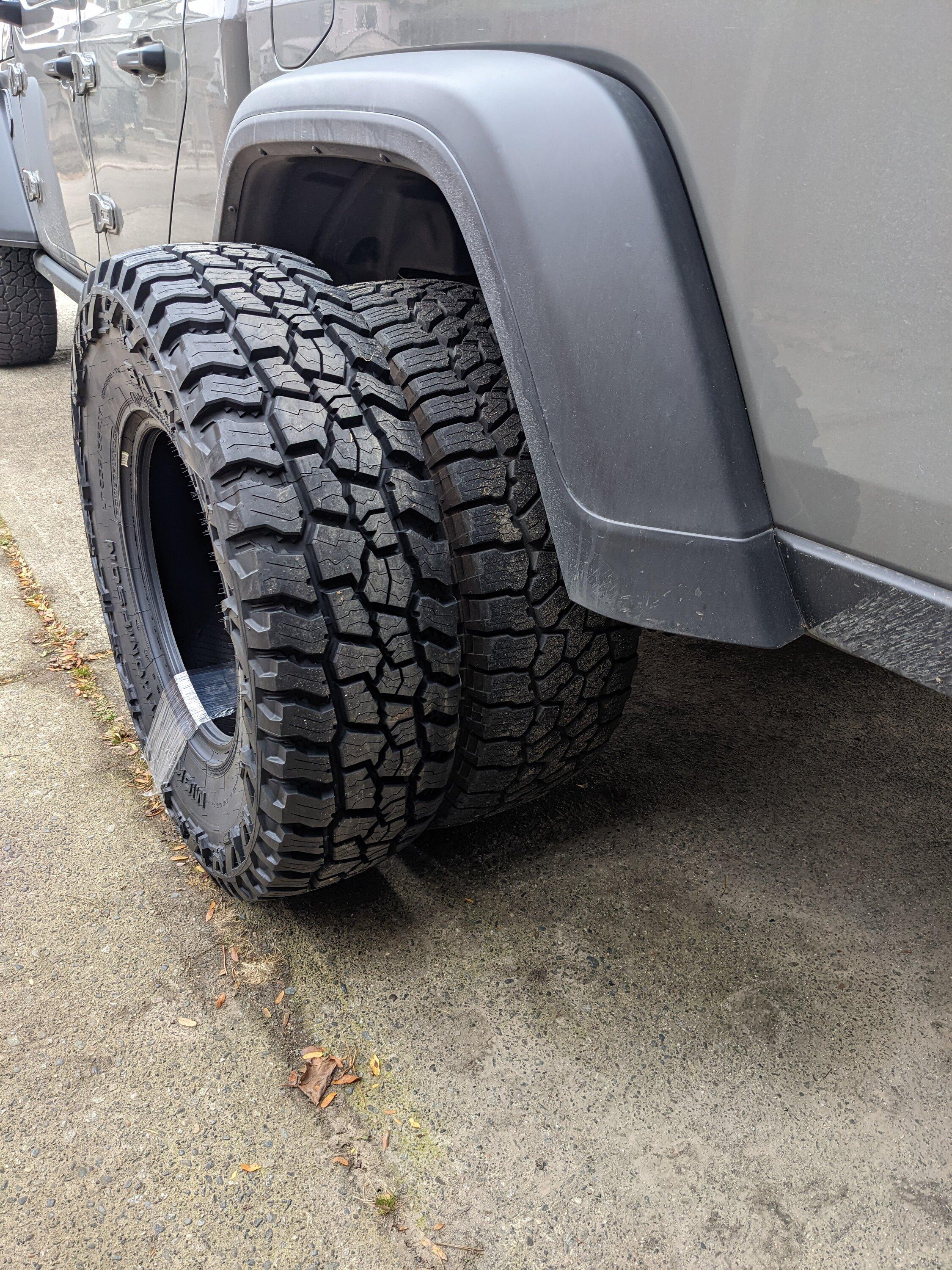

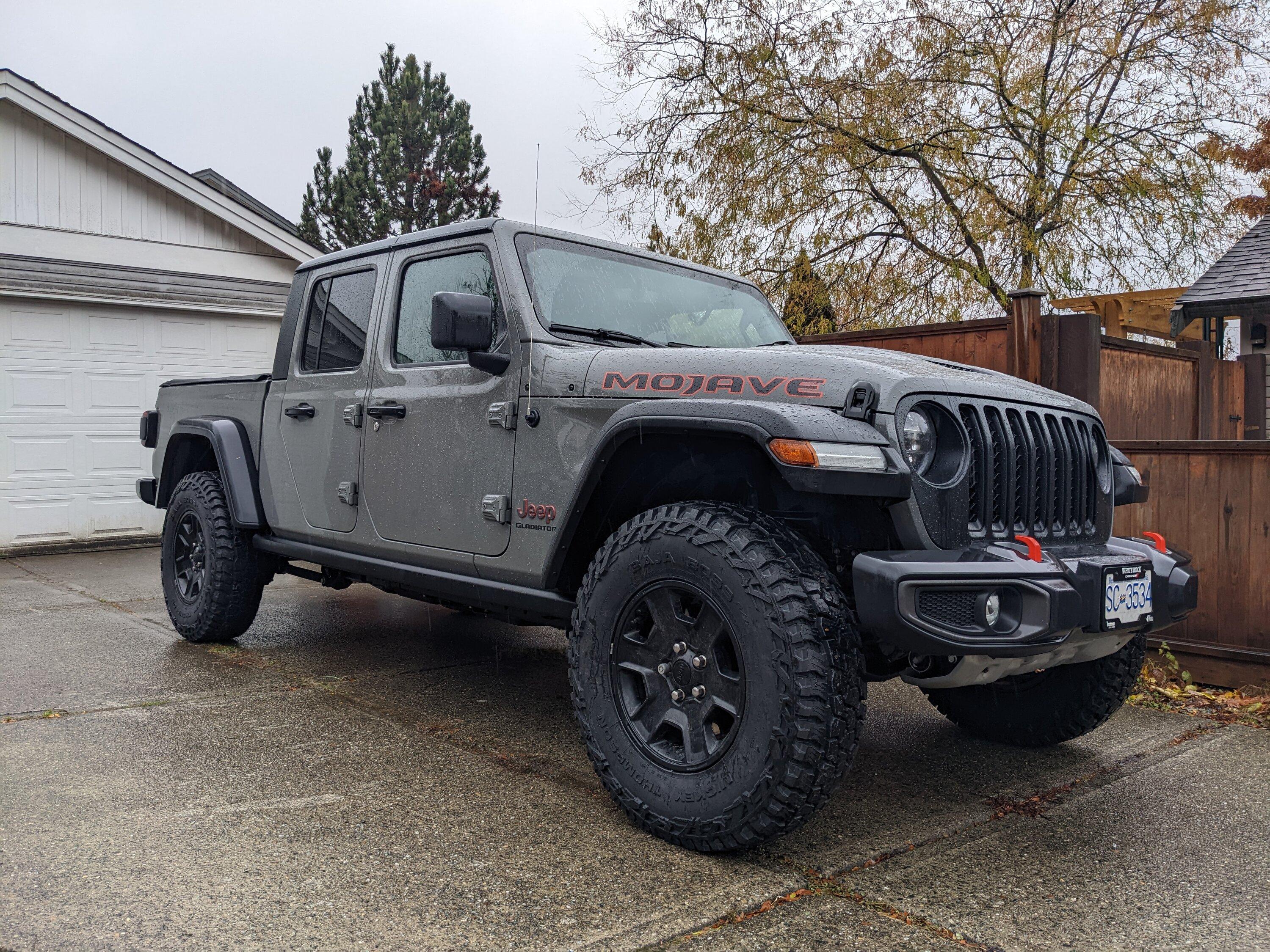

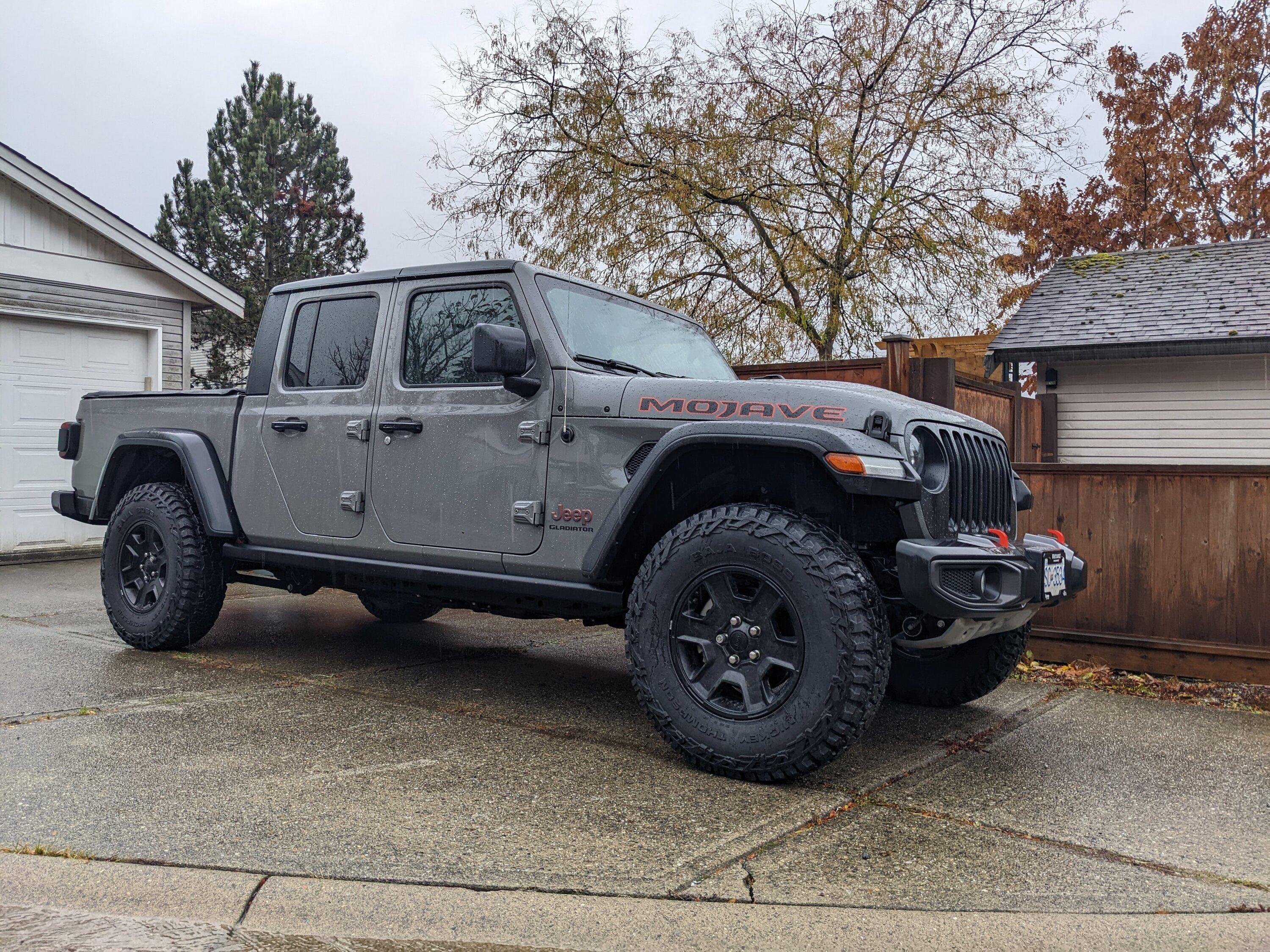

255/85r17 Baja Boss ATs mounted, with a side by side comparison to the stock Wildpeak ATs (mind you the Wildpeaks are under load with approximately 10k Kms)
I'm very happy with how these turned out looks wise, and so far the steering feels lighter. I'll be getting the transmission/speedometer calibrated on Monday. Looking forward to taking it offroad..
How about a direct head on picture?

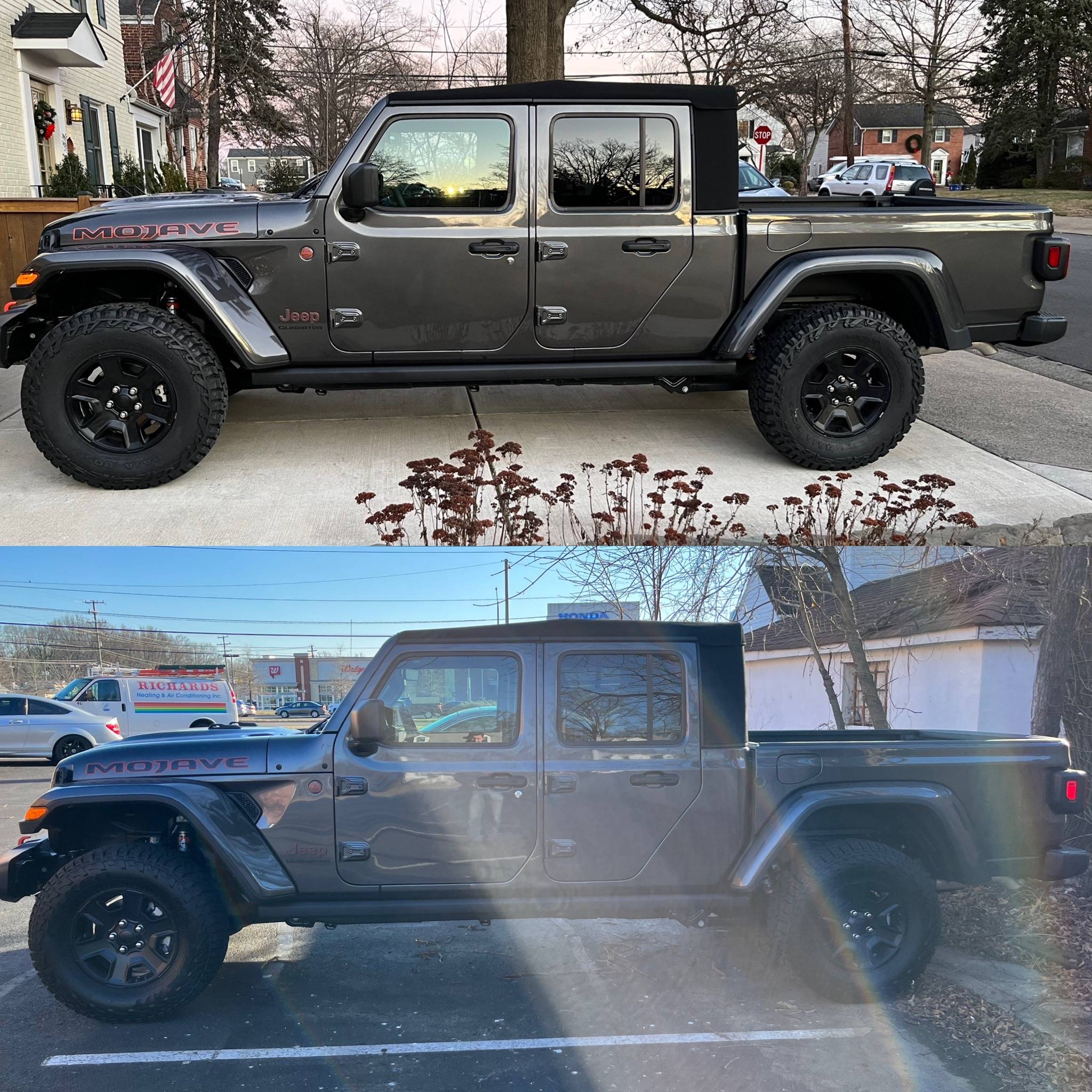

Did the same (255/85r17) on our new JTRD a couple weeks back. They look great and are just awesome in the snow. They are a bit firmer riding than the stock Falkens and other load c tires I’ve used. But, it isn’t bad once getting the air pressure dialed in a bit.
My last JLUR, I’d installed the 35x11.5r17 ATIIIs and those were also really good performing tires. I was torn between getting those for the new truck or the Baja Bosses, but they weren’t avalaible when I was ready to buy. So the MT got the nod. So far, really happy.
Our other JTR has 315/70r17 KO2s (load C) installed (2 years) and these are better in nearly every metric so far. Plus, they fit the stock wheels perfectly and don’t stick out past the fenders at all.

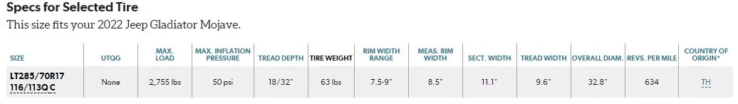

Don't mind me... just keeping this here for future reference...
Stock tires for my Jeep Gladiator Mojave
Jeep Gladiator Pizza Cutters - 35X10R17 Skinny Tires installed Stock Jeep Mojave Tir

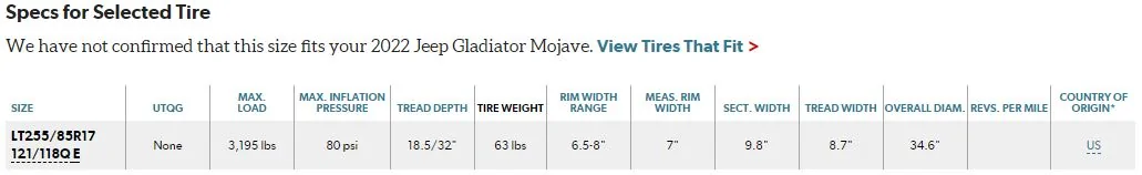

Mickey Thompson Baja Boss A/T
Jeep Gladiator Pizza Cutters - 35X10R17 Skinny Tires installed New Tires for Jeep Mojav

OK, so MT's website states the MT Baja Boss A/T 35x10x17's don't support over 8" wide rims. I'm running the Mopar slotted off-road 17x8.5. Anyone running the MT Baja Boss 35x10x17's on 8.5" rims?
