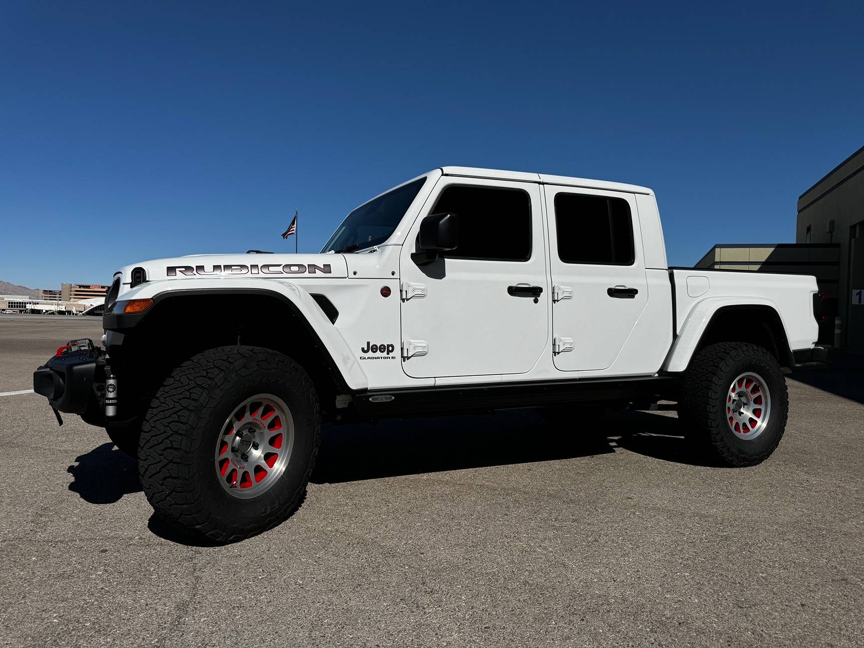

Hey all, This is my first Jeep (24 JT Rubicon X 2" Mopar lift, 17" method wheels with BFG KO3 315 70 17)and loving it, but since I added bigger tires I have had issues with calibrator. I initially had the Super chips flash cal+. Apparently there is issues (ACC and cruise were disabled and the dealer said there was a ton a codes on. they cleared codes) that Holley is are aware of so they sent me the older version Flashcal which they say has been known to work well. Installed and did tire calibration a couple of times to dial it in with GPS speedo. Now when coming to a stop it down shifts from 4 to 2. Not very nice at all. It doesn't do it every time but the fact it has done it concerns me. I had a Diablo sport tuner on my 15 silverado with 35's and it was plug and play easy peasy.
So I have been looking for other calibrators. My question for you all is, Anyone with a 24 having issues with superchips? Anyone with a 24 using another calibrator and how is it working? Anyone have suggestions on any brands? My main use is for tire size but any other bells and whistles are always a plus.
