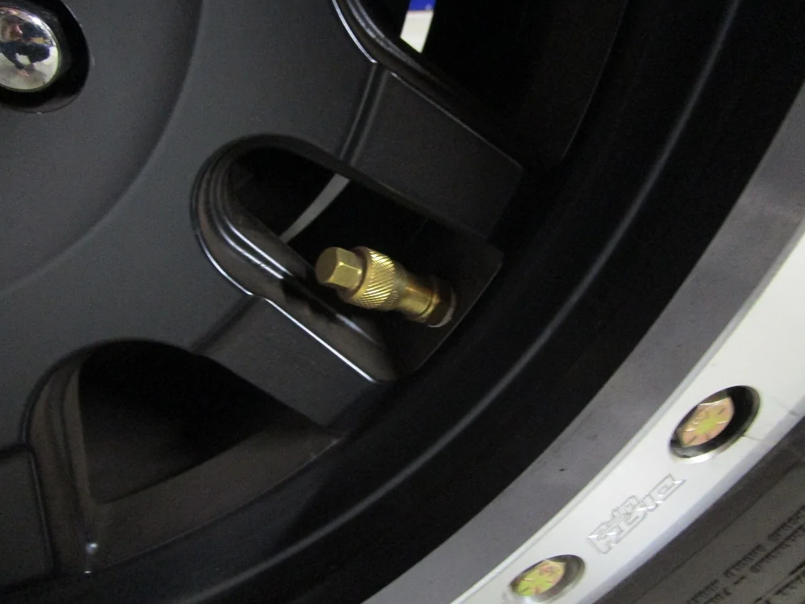

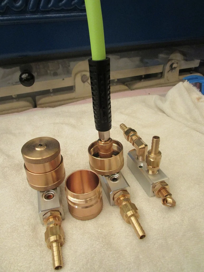

I went with fixed under the fender mount. Grimm OffRoad ARB Twin Compressor Mounting Bracket with added heat shields. JACO Hi-Flo Quick Connect Air Hose Fittings
Ran two 3/8 air lines to each side of the jeep with custom made coupler covers.
Drilled and taped each wheel for large bore tank valves
https://www.zoro.com/haltec-bore-tank-valve-large-1-1932-14-npt-h-47/i/G0848132/
https://www.amazon.com/dp/B093KHZF9D?ref_=ppx_hzsearch_conn_dt_b_fed_asin_title_6
https://www.amazon.com/dp/B0BGZPNFND?ref_=ppx_hzsearch_conn_dt_b_fed_asin_title_28
I can air up two 38'' tires from 10psi to 25psi in about 3 minutes.

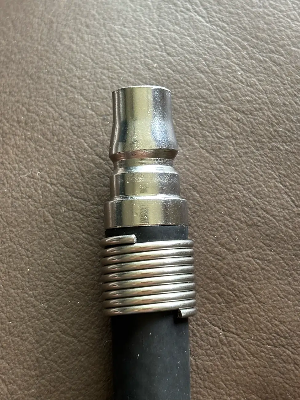

The model I use now I bought on sale at HF, it's a Maddox I forgot the # of it. It has a different type of quick connection that doesn't match any other tip in my garage, can you tell me what it's called?

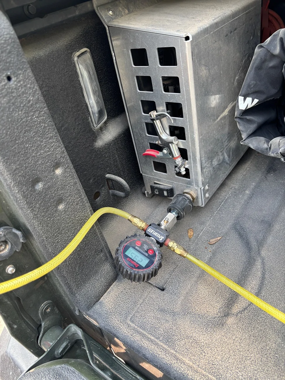

I'm definitely in the fixed category. ARB twin compressor in a housing on the drivers side back wall of my Gladiator. I use it all the time, filling tires on the Harley and the wife unit's Lexus neither of which maintain air like my Toyo tires on the Gladiator.
More importantly "friends" can't borrow it like they can a portable. I came home from my 4 months in the Florida Keys to find one of my SnapOn electronic torque wrench's, a circular saw, other saws and cutters, and my pressure washer disc missing.
Have been able to get back everything but the pressure washer disc which forced me to buy another one last week.
I absolutely hate loaning out my tools but I hate worse being a total dick and not loaning them when I do have what they need.
If you can't trust family and friends to borrow the tools AND return them that very night, which each agreed to---then who the hell can you trust?? I literally got the stuff back months after they borrowed it and well after I'd forgotten who I lent the items to.
Oh by the way, my rule is not to return it from where they got the item but to my work table in the garage. I want to see that the item came back clean and functional. And with the batteries taken out of it if it's battery operated like the torque wrench.
Picture below is of the Compressor in action in conjunction with the SpeedFlate system which allows me to air down or air up all four tires to the exact same PSI. Used it in late April during my recent Badge of Honor trail runs on my way back to Missouri. Absolutely love it because it saves so much time.
