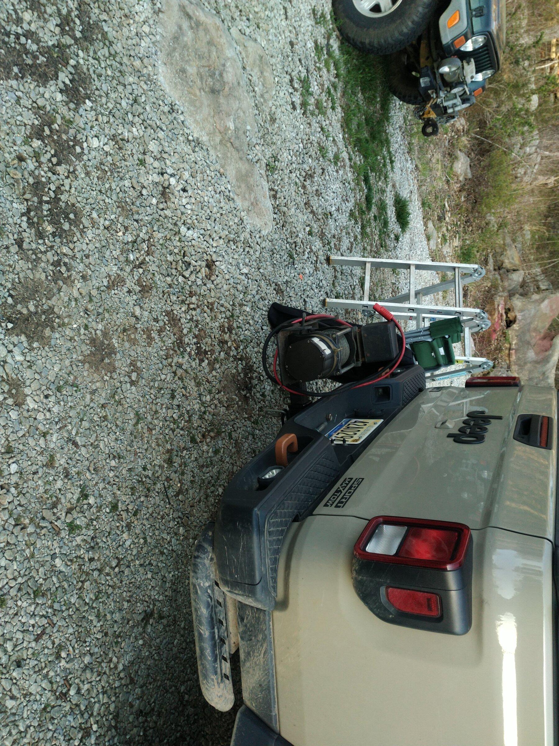

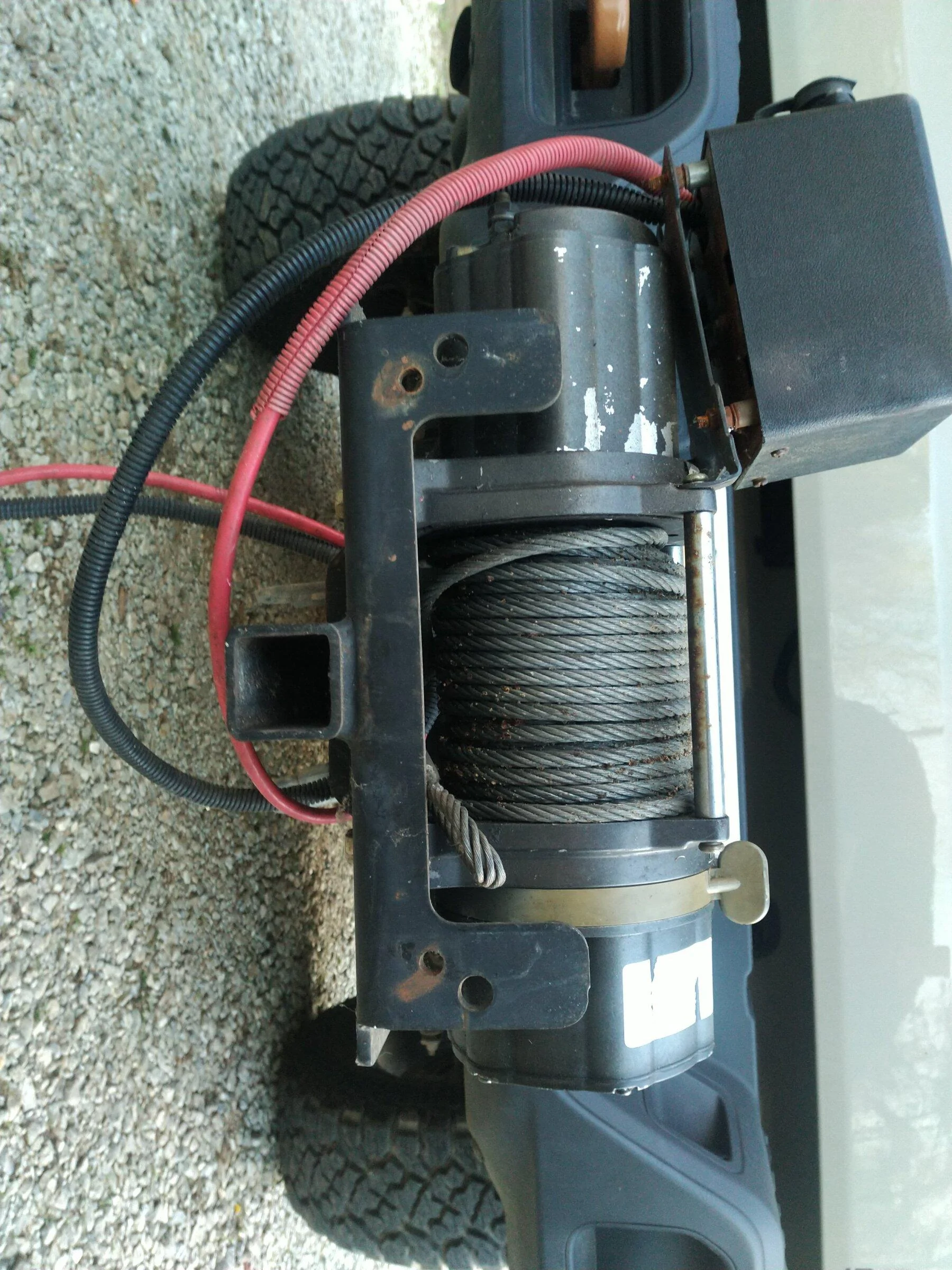

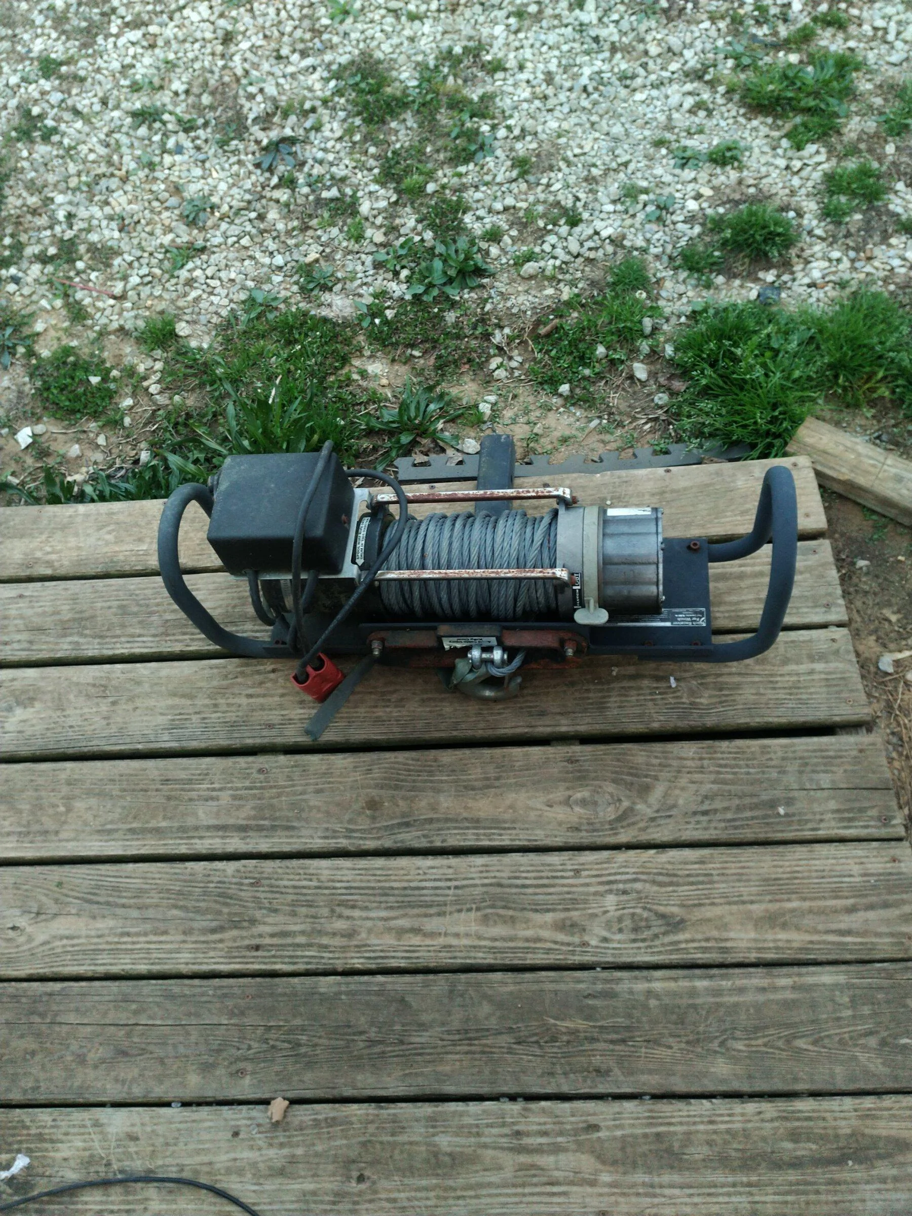

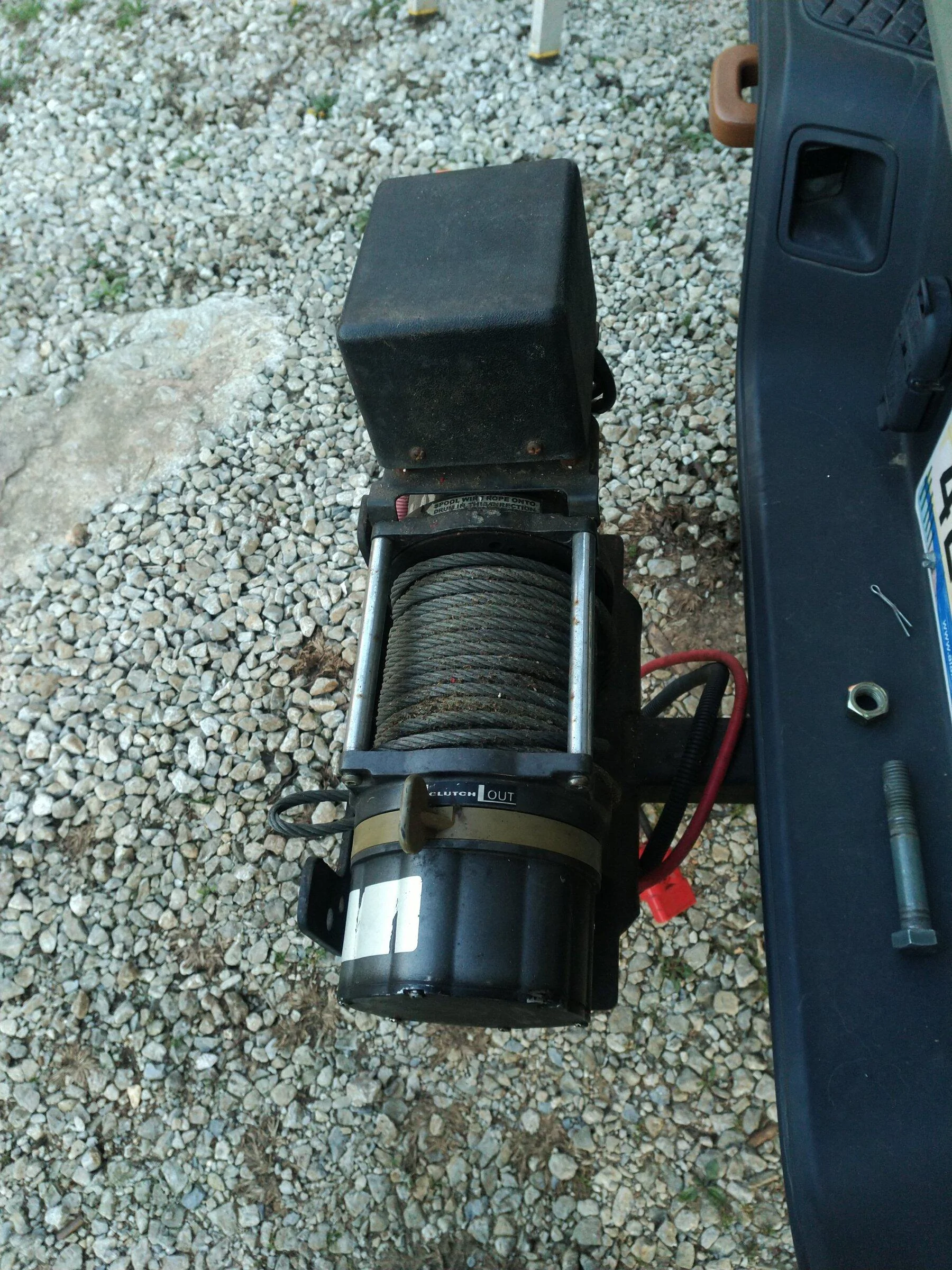

Here is a few pictures..
The last one is a old H.F. 8k winch. Funny thing with it is I've tried to give that winch a new home and have been turned down. ?

The mount under the short drum winch had a 8k winch before I swapped out. Yes it needs a fairlead on it. The small problem is one for it is to short to fit the gap.
