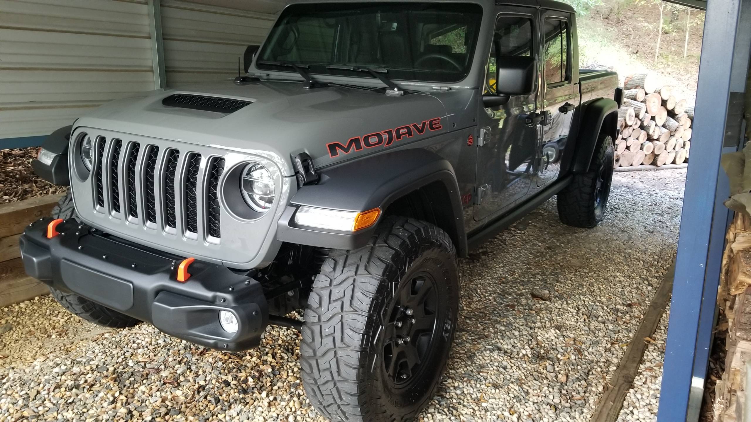

I just picked up this 2022 and it had a Rubicon bumper already on it so I can't speak about the install only that it will fit.

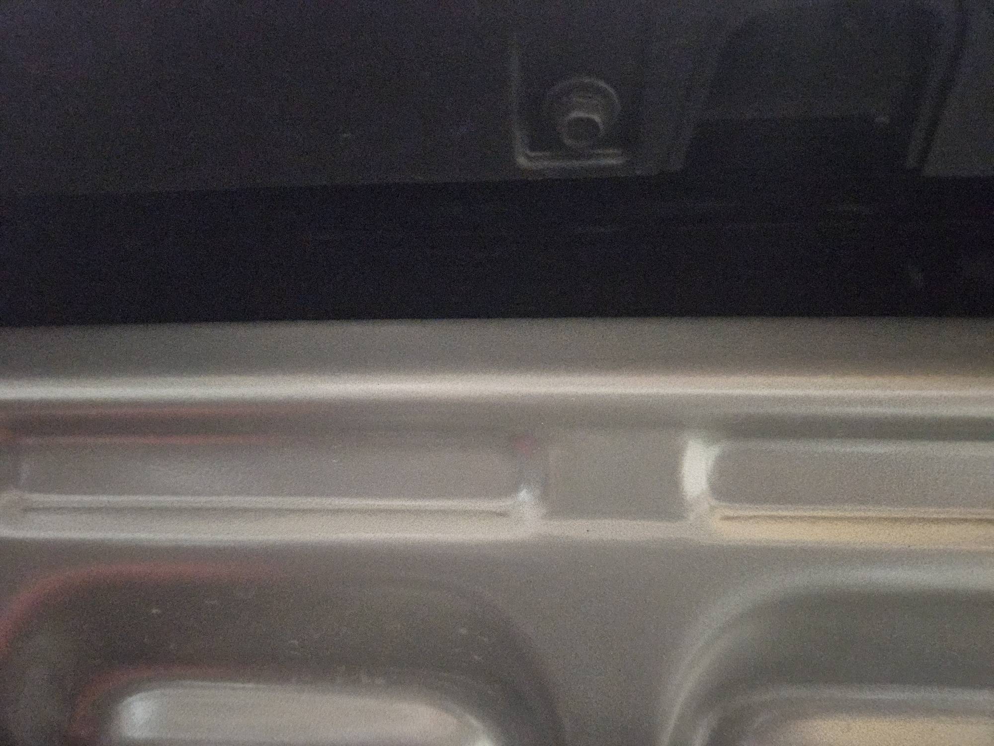

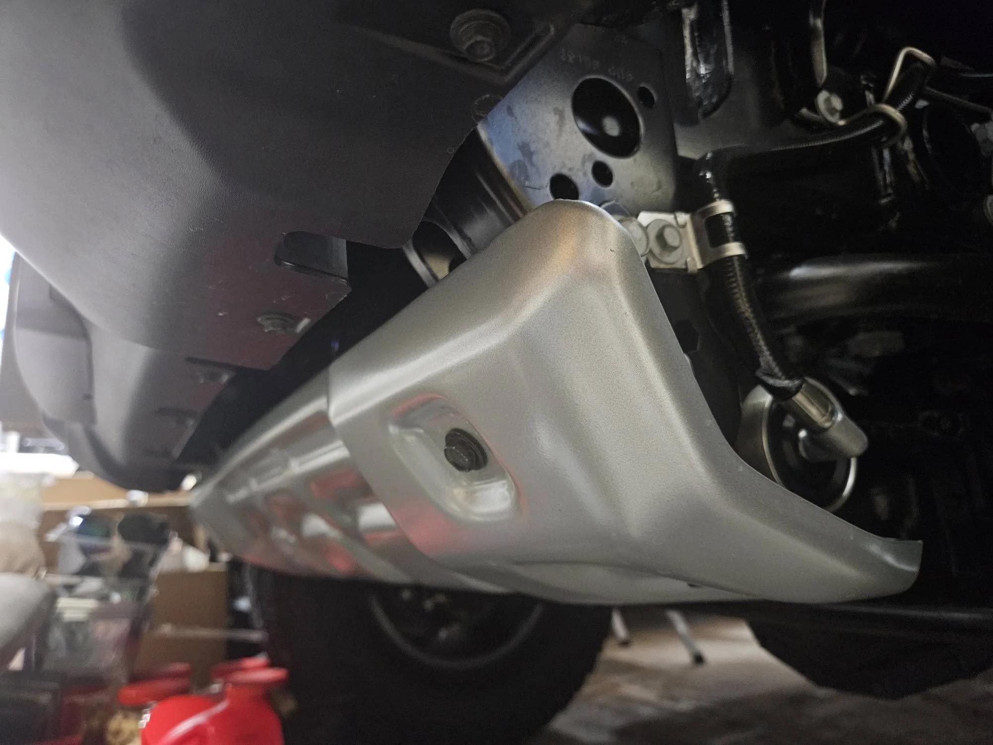

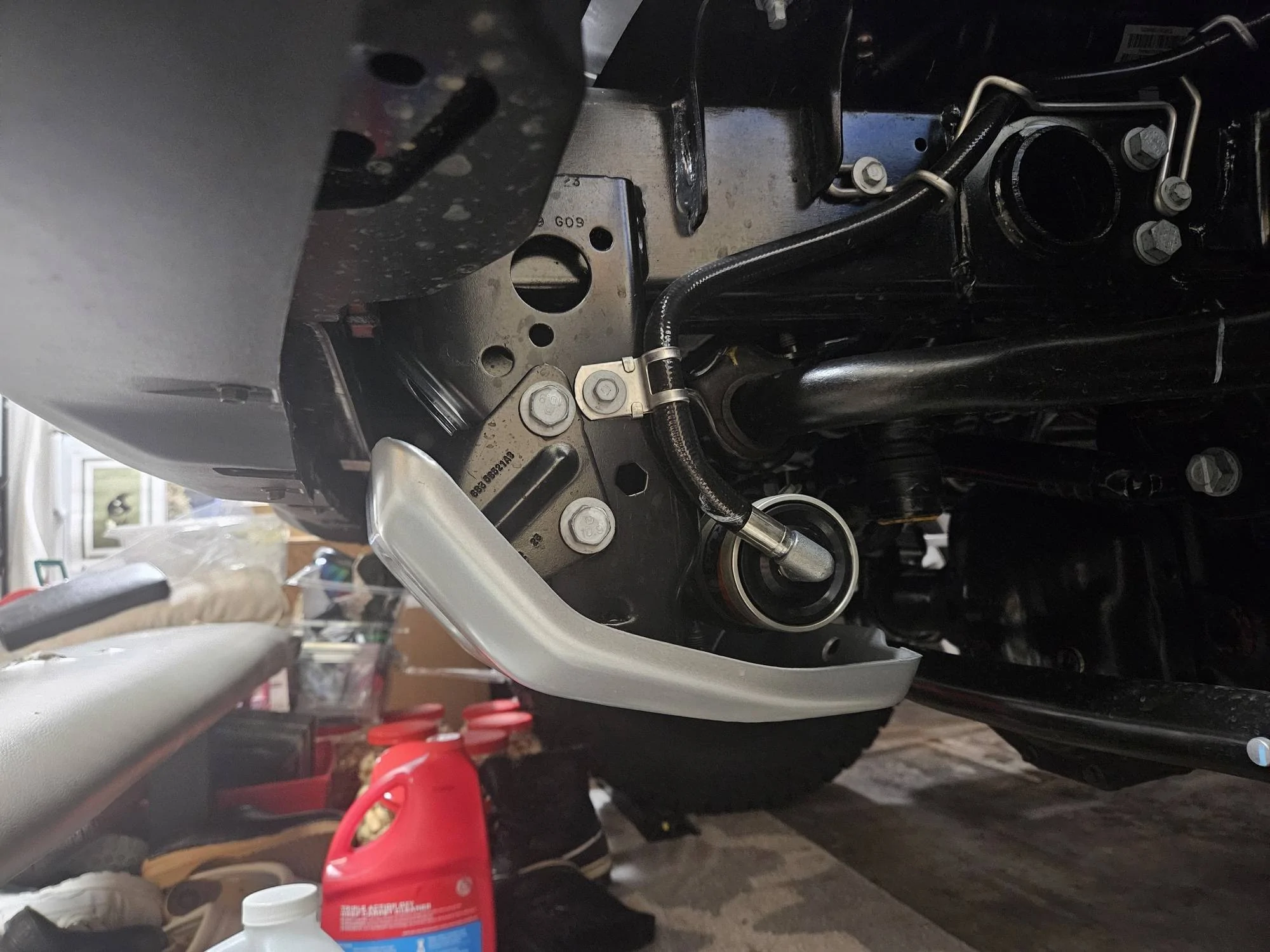

Maybe they have solved this problem already on my 2023 Mojave. The skid plate does not appear to be connected to the bumper at all.
