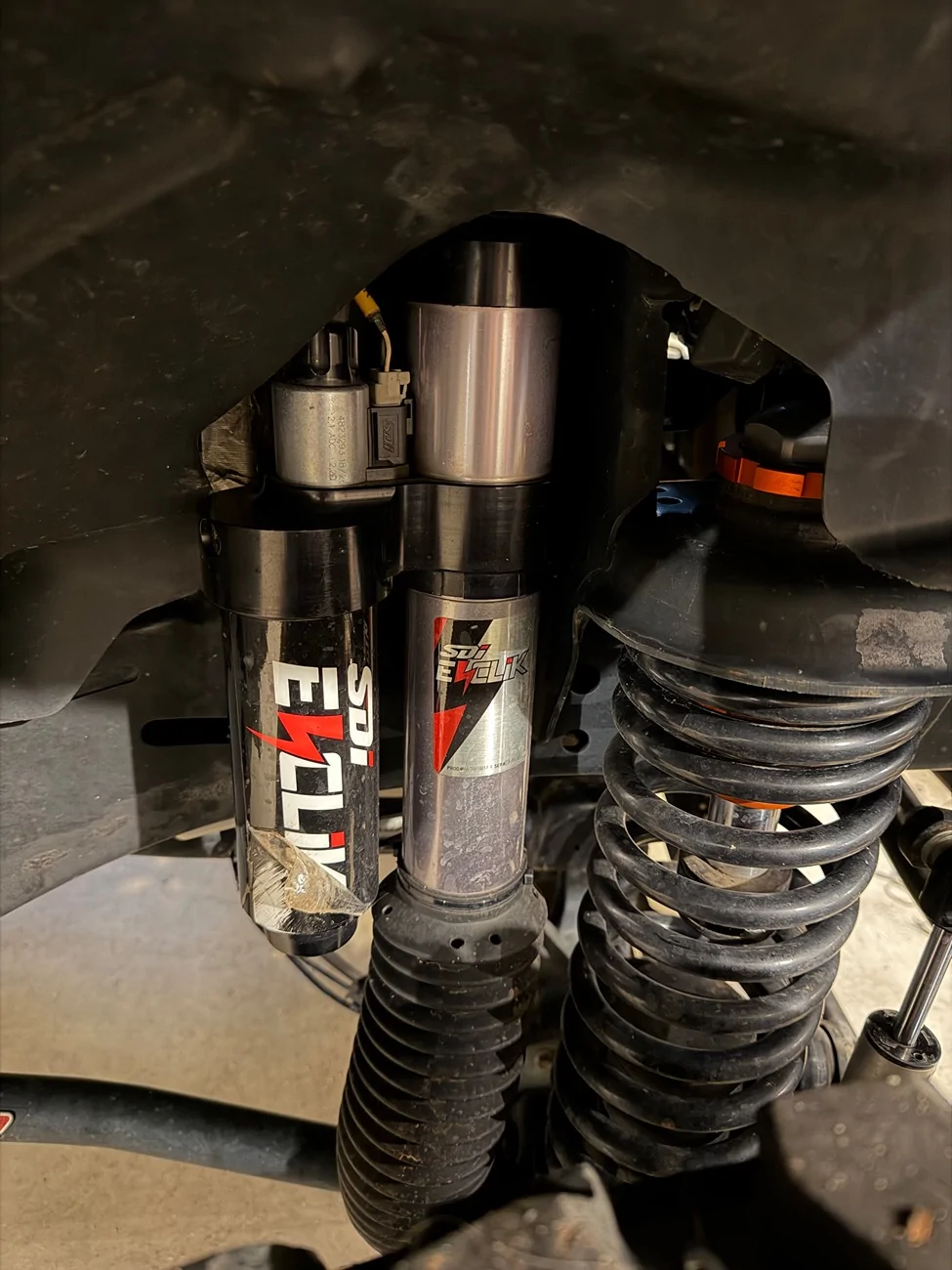

Metalcloak has a great mount for their Blacksport reservoirs. Nice and tucked.
I’m worried I’ll hit those in that spot. My piggybacks are roughly in that location. Mine are clocked out a bit though, to avoid having the piggyback bridge hitting the shock mounts. You can see where I was hitting them.

I’ll second the metal cloak mounting option. I’m not a fan of tubes full of fluid that keep the Jeep stable being right where if something is going to get bashed, it gets bashed hard. Back up out of the way is the smart move. Never understood why Jeep decided to put those in the front on the Mo Jave.
I agree. I don’t want them up there. I’ve received the dimensions as well. 2.5” diameter x 12.873” long including everything. End caps, solenoid, etc. so pretty big.

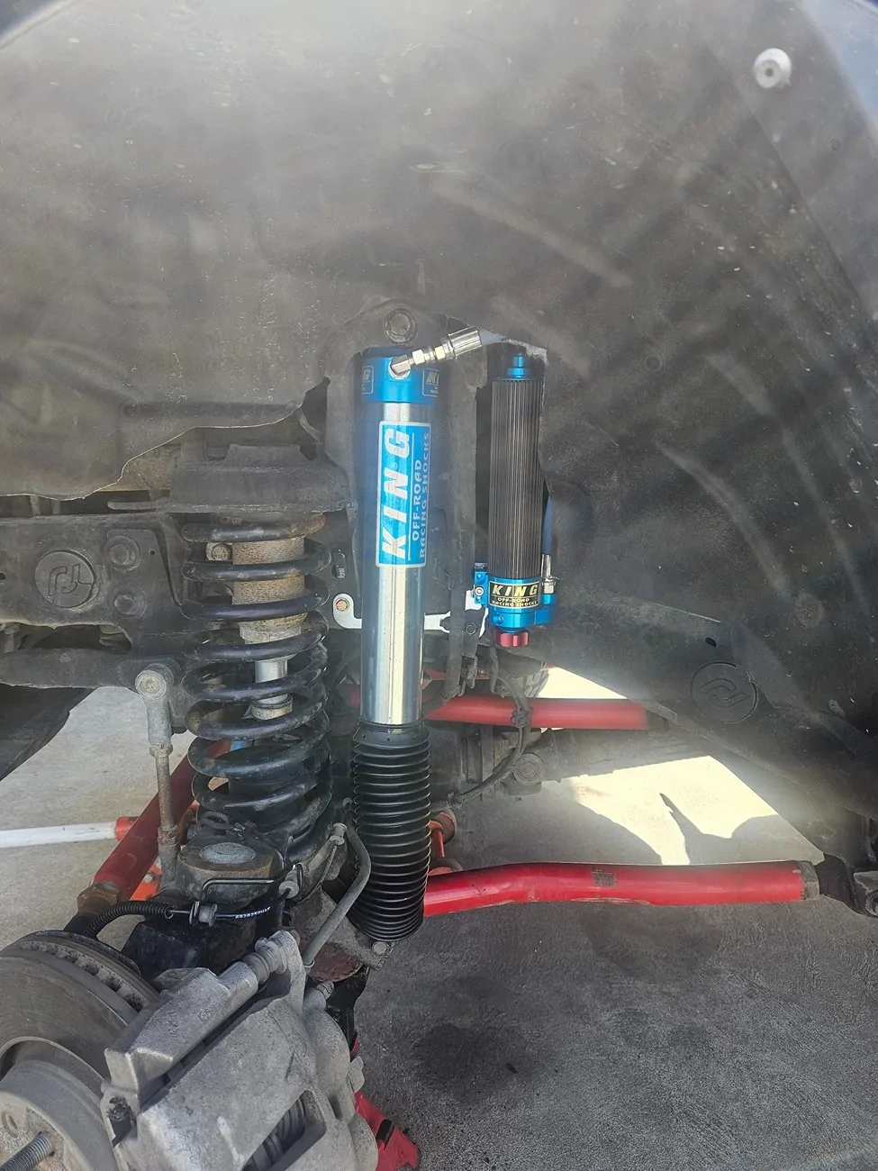

Rubi's never had remotes.
My King remotes are mounted to the frame. Not piggy backed. If I hit anything. It would be the elbow on top of the shock.
Thanks. That would probably work great. And the elbow on these would likely face the rear. How are they mounted?
