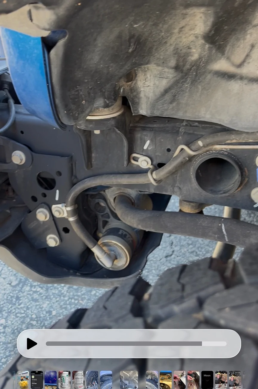

So it sounds like what I’m going to end up with is these, just on the front shocks. They’re going to make me a custom length hose, so here’s my question for all you smarties. Where would you put remote reservoirs if you had your choice?

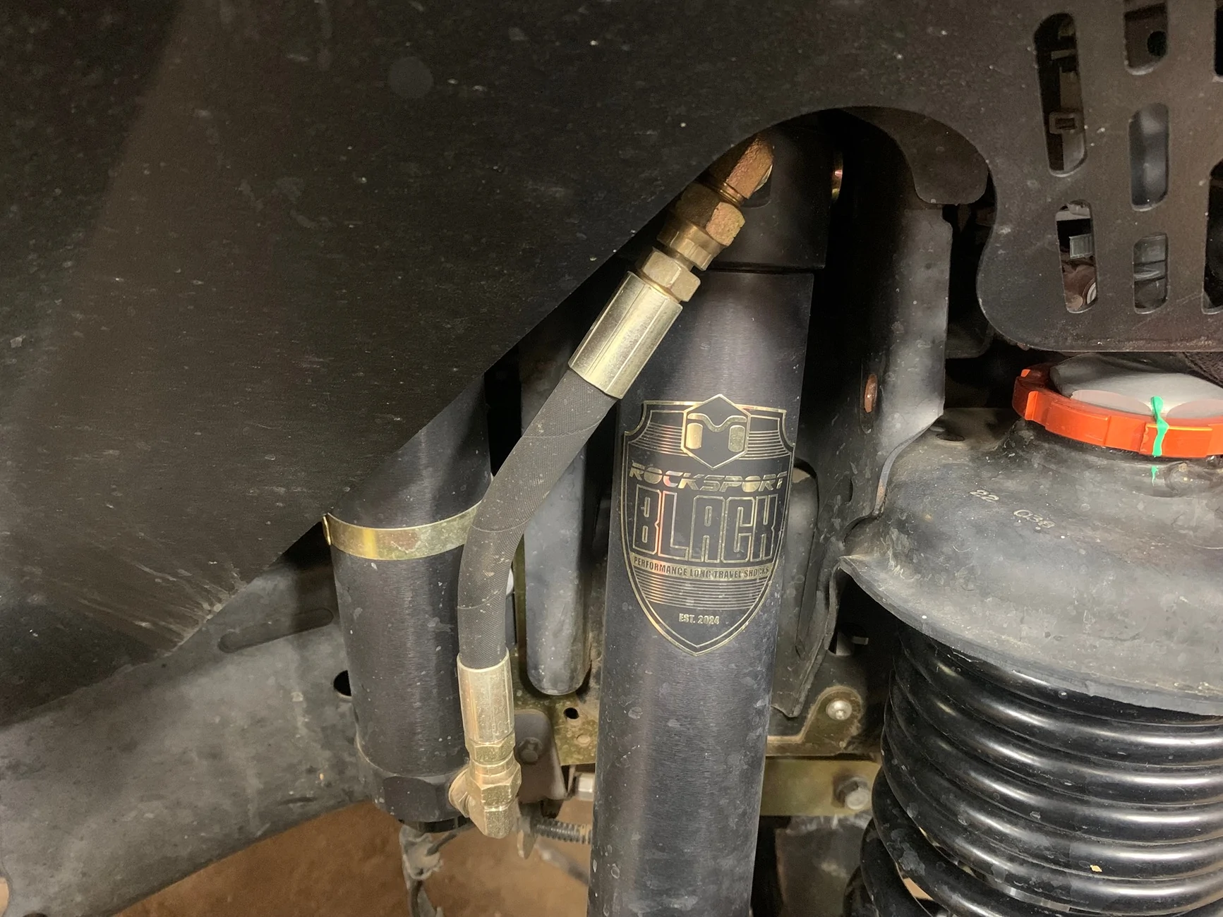

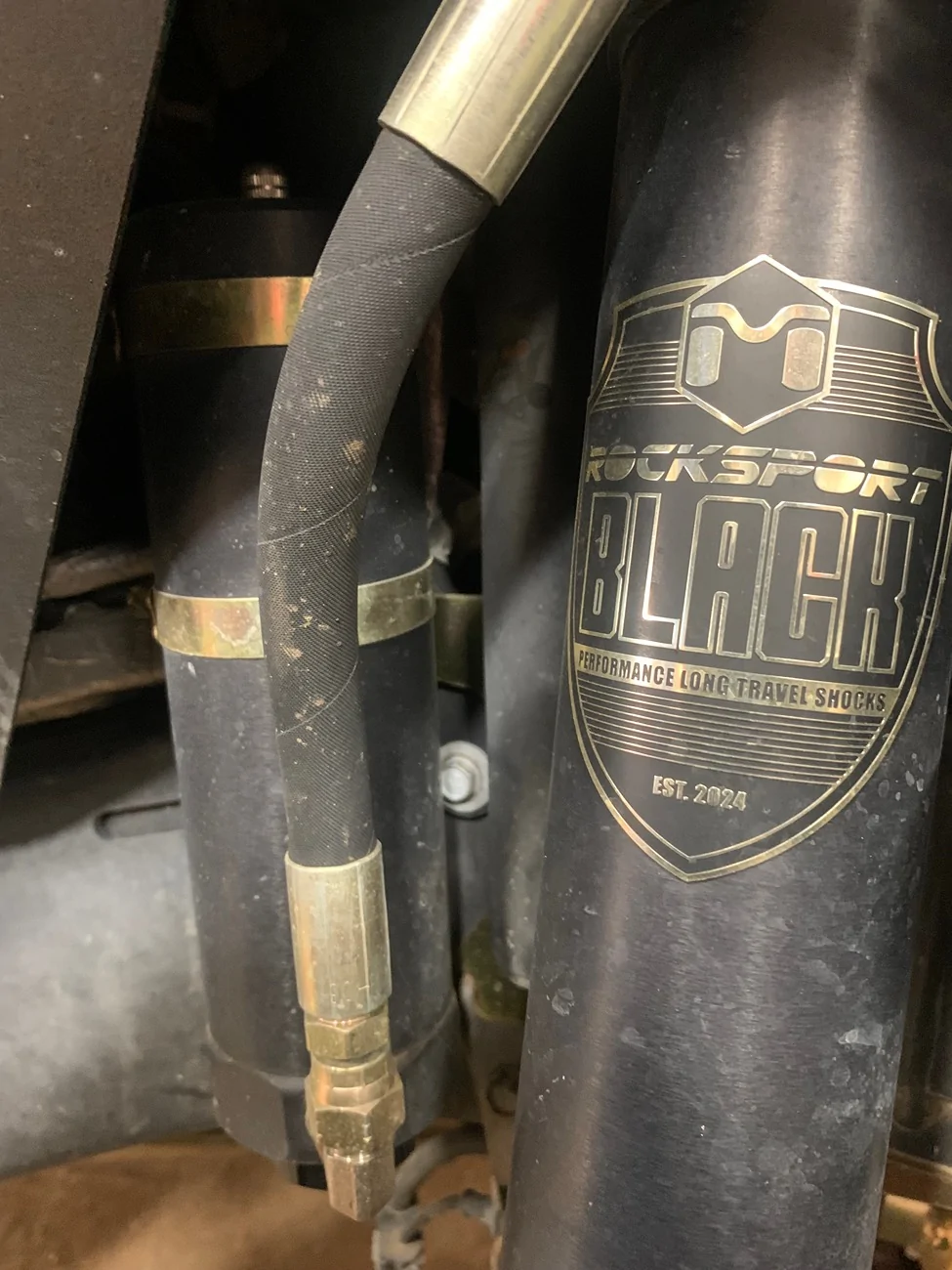

Metalcloak has a great mount for their Blacksport reservoirs. Nice and tucked.

I’ll second the metal cloak mounting option. I’m not a fan of tubes full of fluid that keep the Jeep stable being right where if something is going to get bashed, it gets bashed hard. Back up out of the way is the smart move. Never understood why Jeep decided to put those in the front on the Mo Jave.

Doesn’t the factory Rubi have remote reservoirs? If so check that location or the Mojave reservoir mounting location.
Mojave location
Only Mojave’s. And the Mojave location conflicts with the Rubi swaybar.
