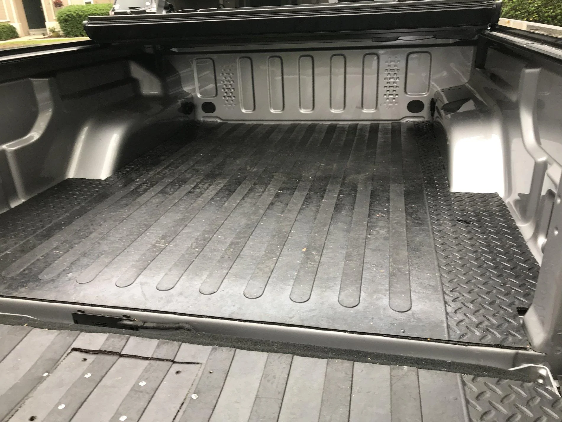

Mat looks good.

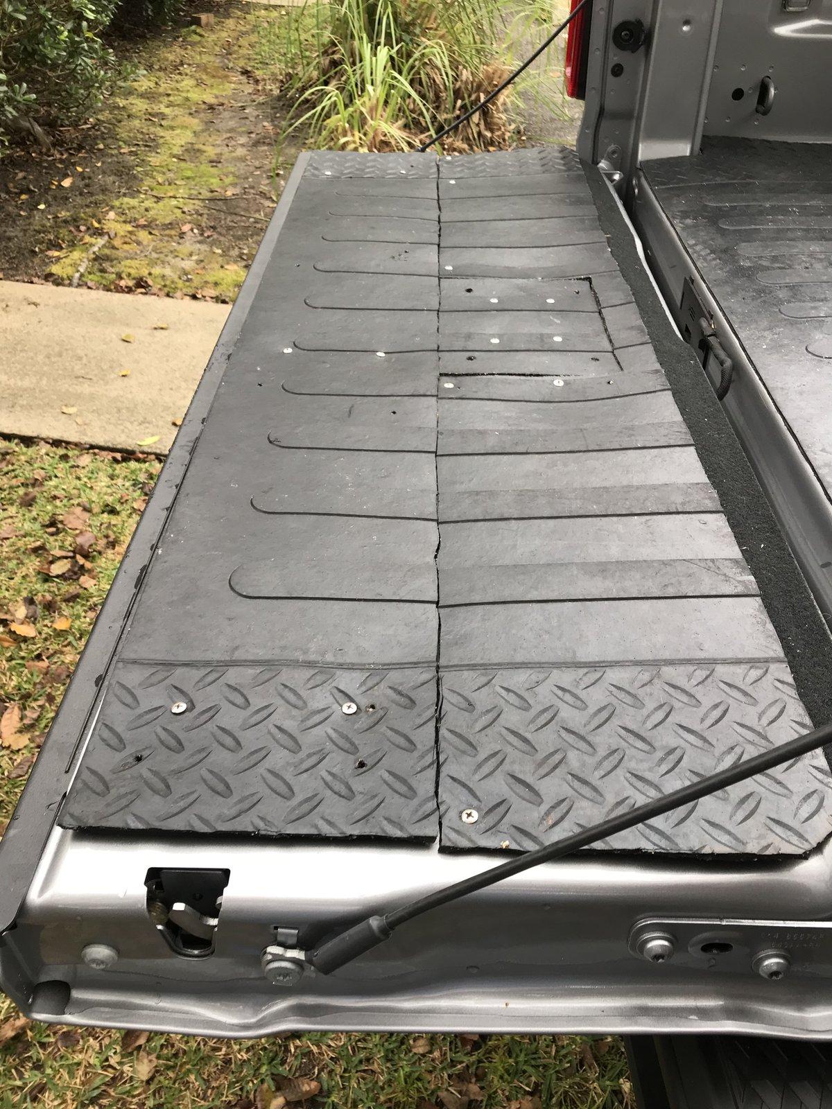

Thanks. It’s a Westin 5X7 mat. I got it from Realtruck.com $129.00 delivered. Had enough left over to cover the tailgate as well. I cut the tailgate section into 3 pieces so I could remove the 2 factory covers individually if needed. May not look that great but it’s mucho functional and practical. There’s little holes over each cover screw so I can unscrew the screws that secure the 2 factory covers. Also made the project a little fun and a little strain and the brain.

Function before form.
Pro-tip a little late.
When cutting rubber like that with a razor blade, spray a little windex (or even just water) on it and it will cut much easier and straighter. (if you saved some scrap try it)
I knew you wanted the tailgate covered, you got it done.

Thanks for that suggestion. I had never heard anything that idea for cutting rubber before. It was a bitch to cut. Will remember that suggestion for next time.
