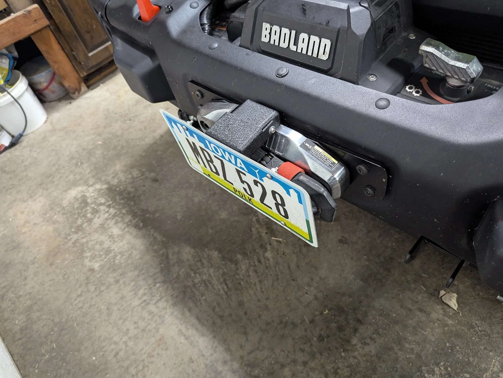

If UV light can't reach it, it's safe. Some climbing experts say to evaluate the protection your rope has, use a flashlight test. If light gets through to the rope it's not protected.
UV is light, and has to reach something to have an impact on it.
For bags or fabric covers, WEAVE matters, TPI, threads per inch. Tighter weaves block better.
Better yet - something like this prevents any UV damage. If the light rays can't get to it, it can't damage it.
UV is light, not magic. It travels in a straight line (ok well a prism can bend it, but in air and so on, straight line)
Jeep Gladiator Pros and con between wire rope and synthetic rope PXL_20251005_215403062
But strong electromagnetic fields also matter, and can mess with rope and tires.
I'm not a fan of steel rope - I've had it on two winches in the past and once it gets some rust started, or a busted strand, it becomes rather dangerous. It's harder on the hands, and requires a roller fairlead. Synthetic requires the hawse fairlead. (the term coming from the parts of a ship through which ropes pass through or over, if I'm not mistaken)
